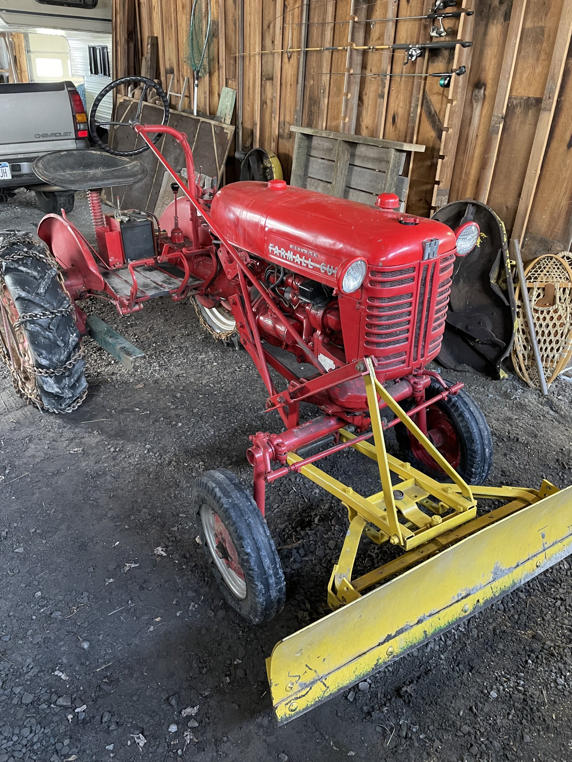

This is my second cub. I think the first one I had was a 56. It was more or less completely wore out when I got it and I swore I’d never have another red tractor after all the trouble I had with that one.
They say life’s about second chances, so here goes nothing I suppose. I got this one at an auction at work. It has very little noticeable wear. I dropped it off at my favorite Farmall mechanic and he gave it a good going over, new carb, fluids, etc.
This one came with tire chains an a snowplow. That was the only job I really liked my old cub for. I really hated “cultivision” and cultivating with it. That was all about slow and a stiff neck.

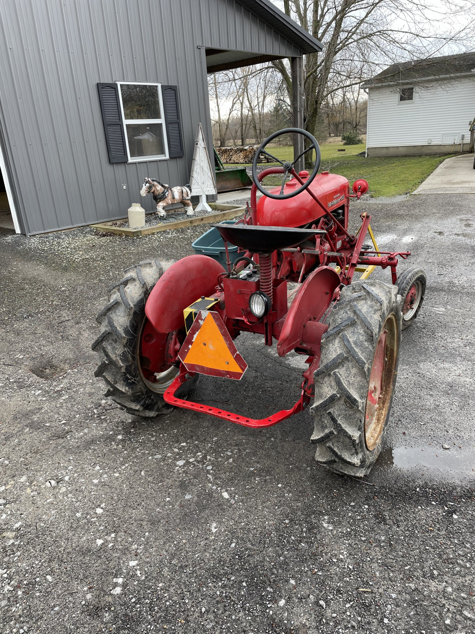

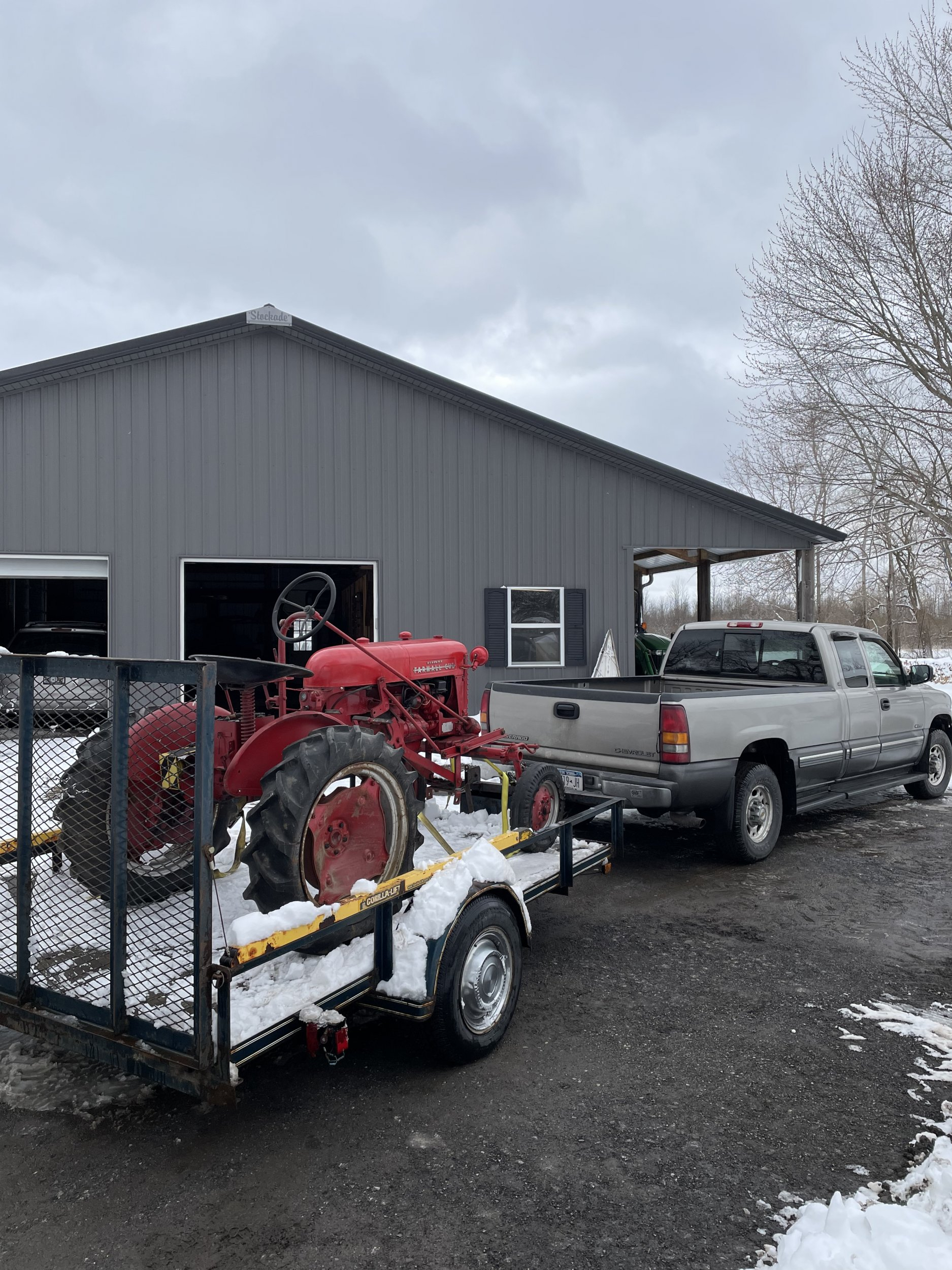

Not sure where those trailer wheels came from. It belongs to a friend who I met thru his father. His dad was the head mechanic at the local IH dealer, for many years. He and his father always serviced my old cub. He let me borrow his trailer to pick this one up, drop it off at his place, and bring it home after he finished going thru it.
This cub is going to be a user. As I mentioned above, the only thing I really missed about my old one, was not having it around for light snow plowing. This one came with a snow plow that still looks like new.
I’m also going to use it a little, over on my parents farm, which is about 20 miles away. I use to have a larger trailer, for hauling my other tractors, but I sold that about 15 years ago. 20 miles is a little too far, for driving the tractors, down the road.
The cub is just small enough to fit in the bed of my pickup, so no trailer will be needed to get it back and forth over there. There is a little 6 ft pull-type disk over there, just right for the cub, and I’m also going to leave a 7 ft cultipacker over there.
This cub did not come with a drawbar, so I just ordered one of those from e-bay. I’ll probably use it a little around home in the spring summer and fall for pulling trailers and other stuff around, in addition to the winter snow plowing.

The weather outside was horrific today, so it was a good day for working in the pole barn. I made a step from 3” angle iron, to make it easier to get on and off of the cub.
I also modified the plow frame (drilled (2) 9/16” holes) to accept a front mount trailer hitch. That should make it easy to get my boat and log splitter in and out of the barn.

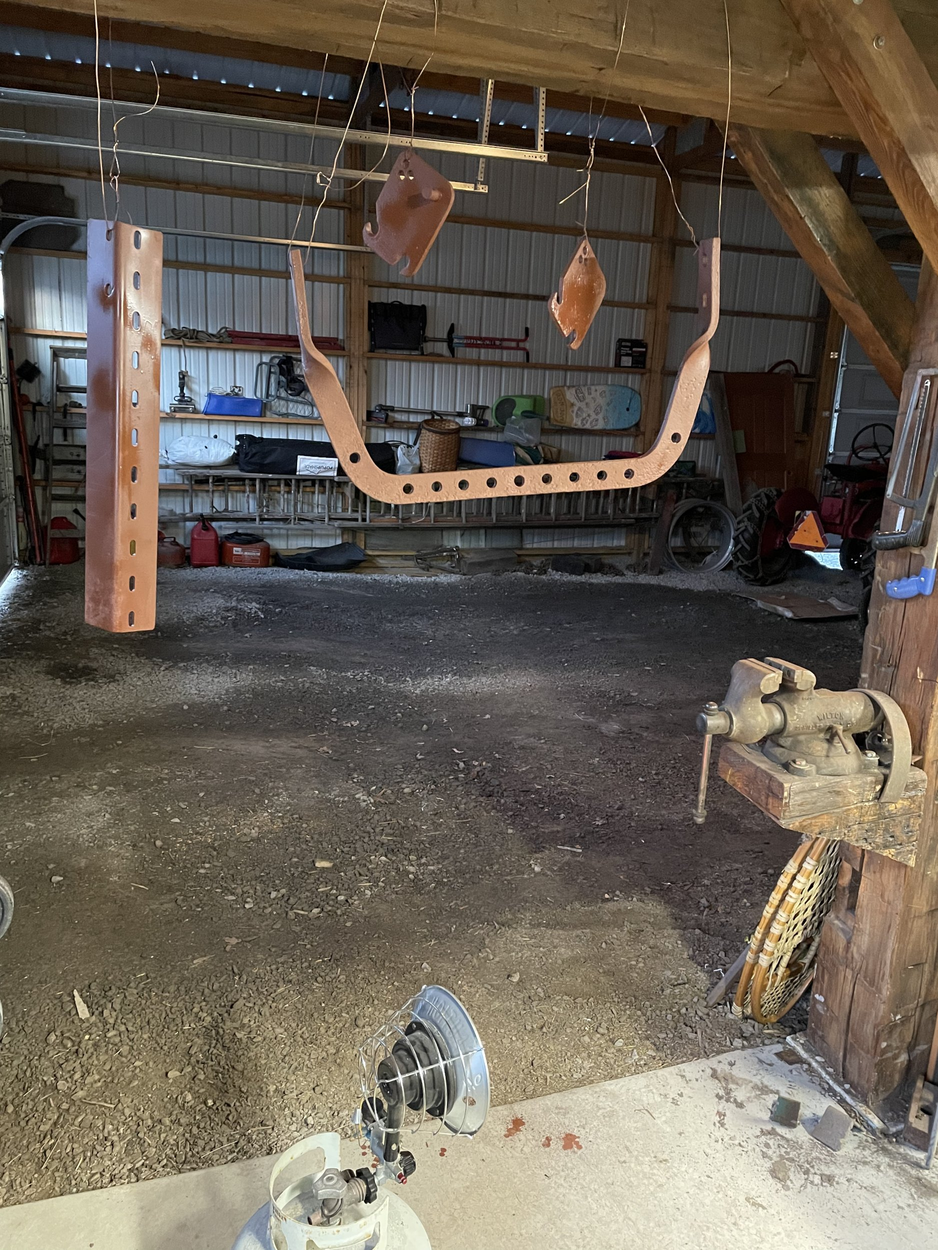

The temp was almost up to 50 F, out in my pole barn, so I put a couple coats of rusty metal primer on the “new” step and drawbar this afternoon. Next time the temperature gets up there, and I have some time, I’ll get a couple coats of Farmall red on them.

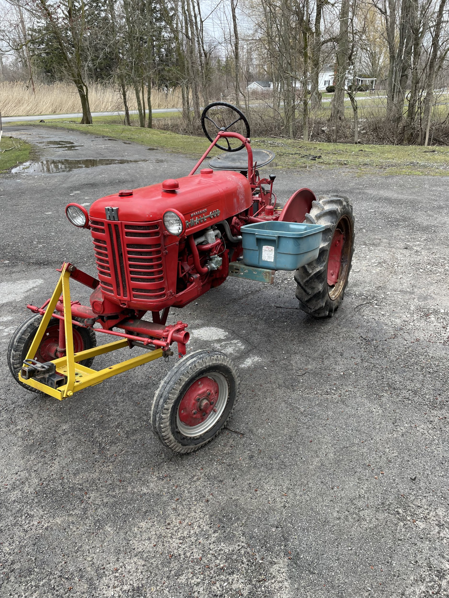

The temperature was above 50 early this morning, so I put a second coat of Farmall red on the drawbar and step. After (8) hours, they were dry enough to mount. Now this tractor is ready for some field work.
While I was waiting for the paint to dry, I put a 6 volt work light on back. I still need to order a couple sealed beam 6 volt bulbs for the front lights, but I won’t need those until next winter.
I also made a tool box holder for the side. The step works very good. I can’t wait to try the drawbar on an old 6 ft Bissel disk. I’m also going to cut an old 8 ft cultipacker, tgss as to has a few busted wheels, down to 7 ft wide to use with it.

That plastic box is temporary. Hopefully, I can locate an old wooden box, that I always used on my previous Cub and Allis Chalmers model C. It worked great for holding a chain saw, a few log chains, and some felling wedges. I sold both of those old tractors, when I had to thin the herd, as I was dismantling a couple of old barns that my great great grandfather had built in the mid 1800’s. I think I saved the wood box, but it’s currently burried under a bunch of stuff in the corner of my new pole barn.
If I can’t locate that old wood box, I will make a new one. I know that plastic one will not hold up very long for woods use. I also used the box for carrying bags of clover, wheat and rye seed, and a hand-held broadcast spreader, while I used those old tractors on a cultipacker.
