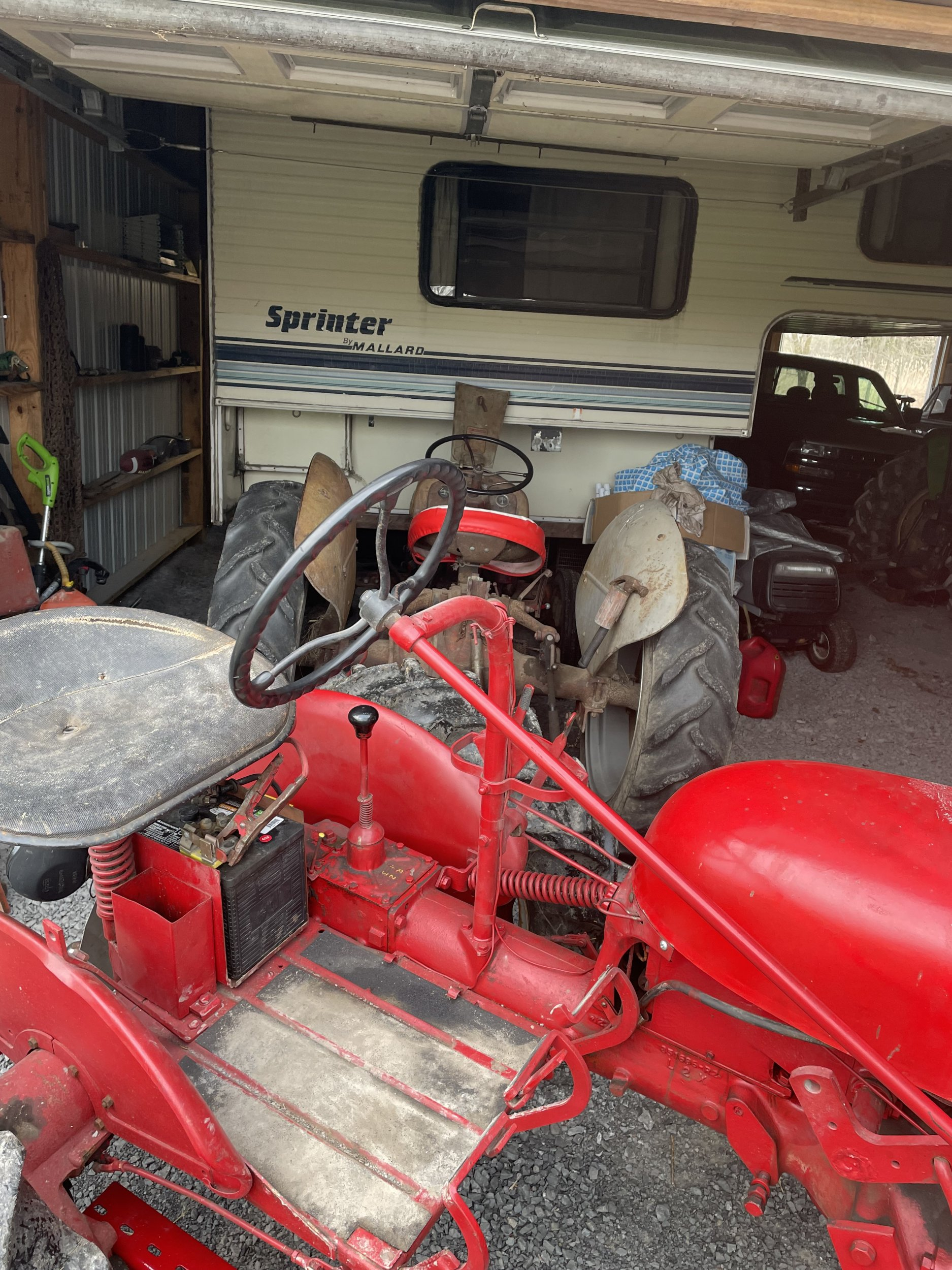

I’ve got a 17 year old, but never used, 6 volt battery on a charger now. I topped it off with distilled water (it took about a quart) Tomorrow, I’m going to try that on my Ford 8n. If it don’t crank it over, then I’m going to have to take my only good 6 volt battery out of the Cub, so that I can start my spring plowing with the 8n. It was showing 5 volts with my multimeter, after a couple hours on the charger yesterday. After (7) more hours charging at 8 amps tonight, I’m going to give it a try.
I hope that old battery will work. I hate sharing one between two tractors, and I really don’t want to buy another new one.
   / Brought 57 cub home today
#25
The 17 year old battery cranked the old Ford tractor over for a while, but not long enough or fast enough to start it. I drove the Cub over to it and did my first ever 6 volt on 6 volt jump start.

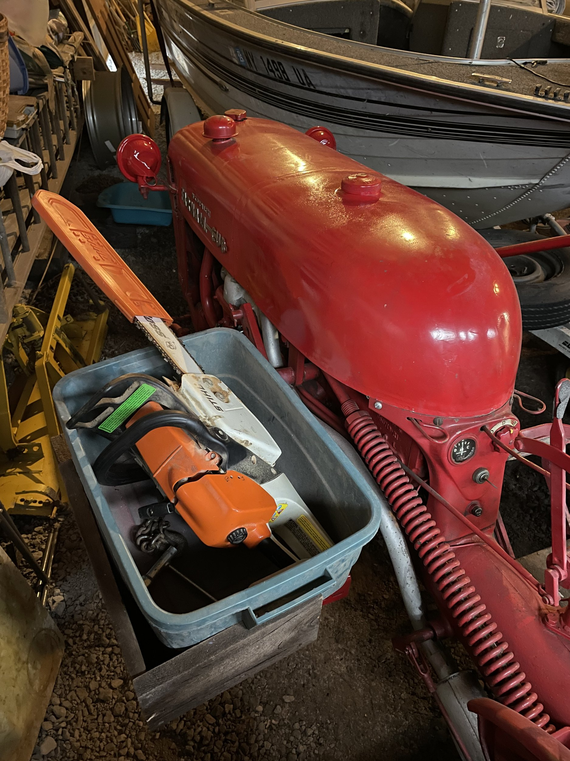

I reworked the new toolbox frame a little, welding it and painting it. I also made a wood outer liner for it, so that the Rubbermaid box can be removed and replaced as needed.
Now the Cub is ready for some light firewood making duty.

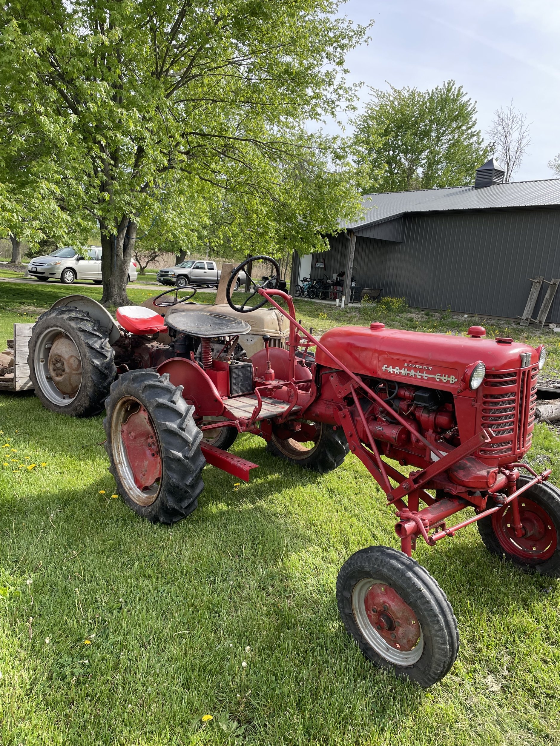

This is my second Cub. I didn’t have very good luck with my first one, but it was pretty well worn out when I got it. This one is in much better shape, and likely has less than 500 hours on it.
What I missed most about my old Cub, was snow plowing. This one came with a snowplow that looks like it was hardly used. I didn’t get it running in time to plow last winter, but I am really looking forward to next winter and plowing with it.
I also like the fact that it fits in the 8 ft bed of my 3/4 ton pickup, so I don’t need to drive it on the road or trailer it back and forth to my parents place, about 20 miles away.
I’ll be hauling it over there later this summer, and will probably leave it there thru the fall. It will be nice for making firewood over there, and doing a little tillage and seeding work on some deer food plots. It will also be nice to have a tractor over there, with lights that work, for getting deer carcasses out of the woods.
