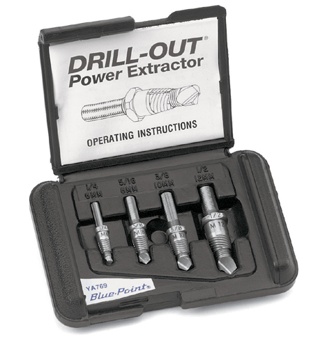

Well, I tried the EZ outs without success. Watched some YouTube videos on tips to make them work and none did. Finally removed the pin so I could take it into the garage and get a better look at it. The hardened steel EZ outs were actually wearing down trying to use them. Tried to drill out the remaining zerk and it defeated the drill bit. Didn't break the bit, it just plain would not effect the zerk. That zerk is titanium or something.
What would be cheaper, buying a new pin or taking this one to a machine shop? Are these pins standard (could I get one at a farm supply shop) or would I have to order a new one from kubota?
I'm thinking if I re-tapped it there would be fine metal shavings getting into my grease and that kind of defeats the purpose of greasing.

I'm finding it hard to believe a mass produced grease zerk is harder than a good drill bit. if it's not spinning.. it may be an angle issue.
switch to a carbit bit... ( masonry )
I'd drilled MANY a pin with those.. and they have a slight different pitch.
if that don't work.. got an endmill or metal bur and a die grinder?
it WILL come out.. we just have to persuade it to.. :)

Well you are probably right, I worded that poorly. The bit is probably not softer, it is just not getting any bite. I actually have a masonry bit that is probably the proper size. Not home at the moment so I'll have to check late tonight or early tomorrow. I do appreciate the advice and encouragement, it doesn't seem like something this small should be so baffling.

I'd call it stubborn. i think the masonry bit will give you some joy.
I bought a junker tractor a couple years back. old ford 950 that sat in a peat bog and ran a water pump.. I'd say 60% of the bolts and studs on it were broke off or corss threaded and broke off.
for 2 weeks I drilled out, backed out.. ez-outed, and welded and torchwed out fasteners.
at first I was using my good cobalt bits. after going thru 3 1/4" bits.. ( and some lefties ) I replaced it one more time and switched to carbide. 2 bits did the rest of the tractor... some of them were darn stubborn.
2 hardest ones were a front plug in the steering bolster.. easy.. a soft cast iron plug right? someone broke off the end of a ratched driver int he end of the recesced plug.. and that tool steel was hard. The had torched on it.. and I think.. pretty much welded the plug tot he parent metal.. I wleded a nut to the end of the stub.. got a lil turn on it.. thought it might be backing the plug out.. but actually all it did was pull the ratchet drive out.. which was actually great... I then just drilled and tapped for a 3/8 pipe plug in place of the smaller one that had been there.
flushed the sump and was happy..
the other was a lil plug in a final drive.. bugger was hard to get at.. but a carbide bit drilled thru it and then got it thin.. then an extractor pulled it out when it was paper thin.....
