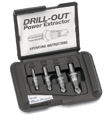

YA769.jpgBeing part of the 95 % pack, I really like those:

I think I would drill out the zerk hole a bit first so that I could use the largest EZ out that I could. NOTHING worse than a broken EZ out as they are next to impossible to drill out. Dont put too much pressure on it when attempting to remove the zerk. If it doesnt come out easily, drill out the hole, retap to a larger sized zerk. Dont risk breaking off the EZ out in the zerk.
