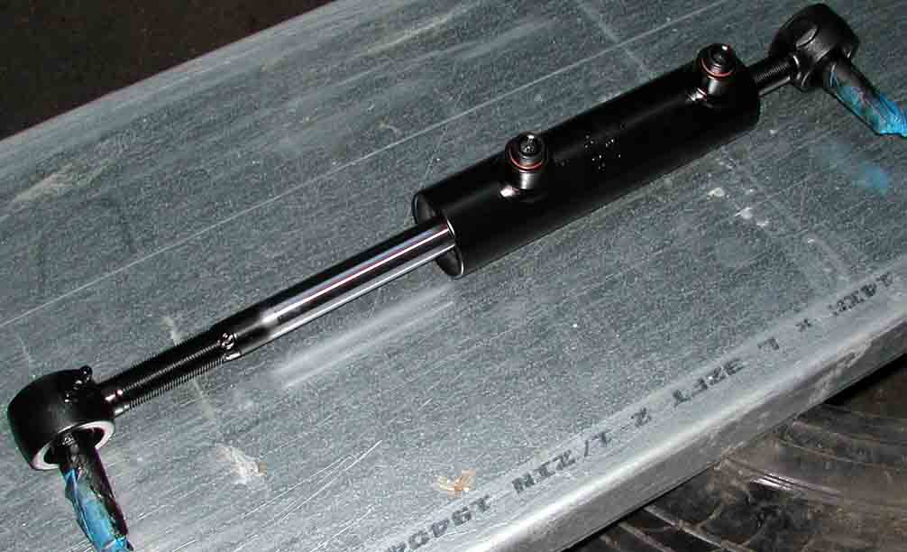

/ Broken Tie Rod on my 4500 #6
The least expensive solution will be to customize a generic cylinder. Here is a
photo of one made up for a JD955. The cyl is from SurpCntr, and the welded-on
ends were from an auto parts store.
On my first 4300, I was able to save the cyl, but I subbed a large truck tie rod end
and welded it on.
Even if you buy the parts and take it to a shop, you should be out less than $350.
