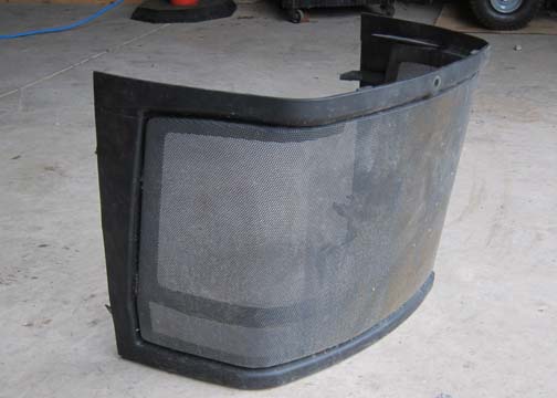

The top tabs on the panel screen on my '06 BX2350 are broken so the screen doesn't align or stay in place properly. The first screen did the same so it was replaced under warranty.
Do the new BX's have the same plastic tabs or are they made better. I'm not going to bother replacing the screen if it's just going to break again.
Thanks.

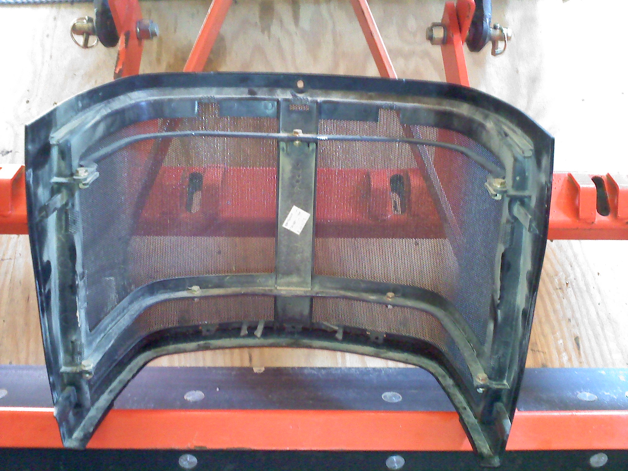

mine broke on the left side, I haven't replaced them ( I have the bx2350 too)
but I saw on the new machine that they have metal guides on the outside of the screen. I had my dealer order them ($8) and I bolted them on. They help hold the screen in place and I figured it was cheaper than a new screen.

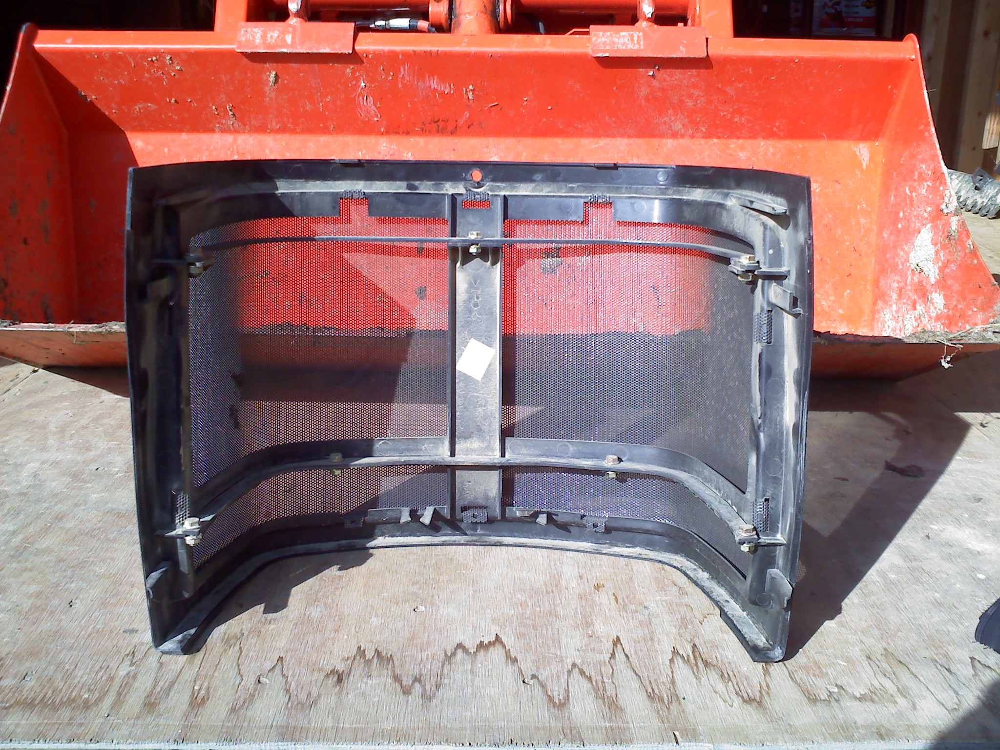

Here are two pictures of the metal brackets Deano is speaking of.

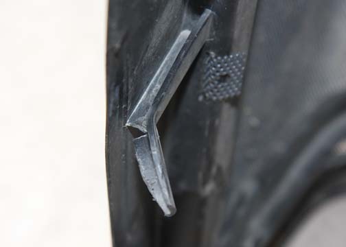

This is what I was talking about (screen guide) I have a broken lower left tab on my 2006 bx2350. I posted a pic (my first time).
Thank you so much for posting that photo. I'm going to try to order those as well.

My dealer had some "take-off" panel guide brackets in stock so they were only $4 per side.
I put them on and now I can install the panel with one hand. If these were on in the first place, the tab may not have broken.
