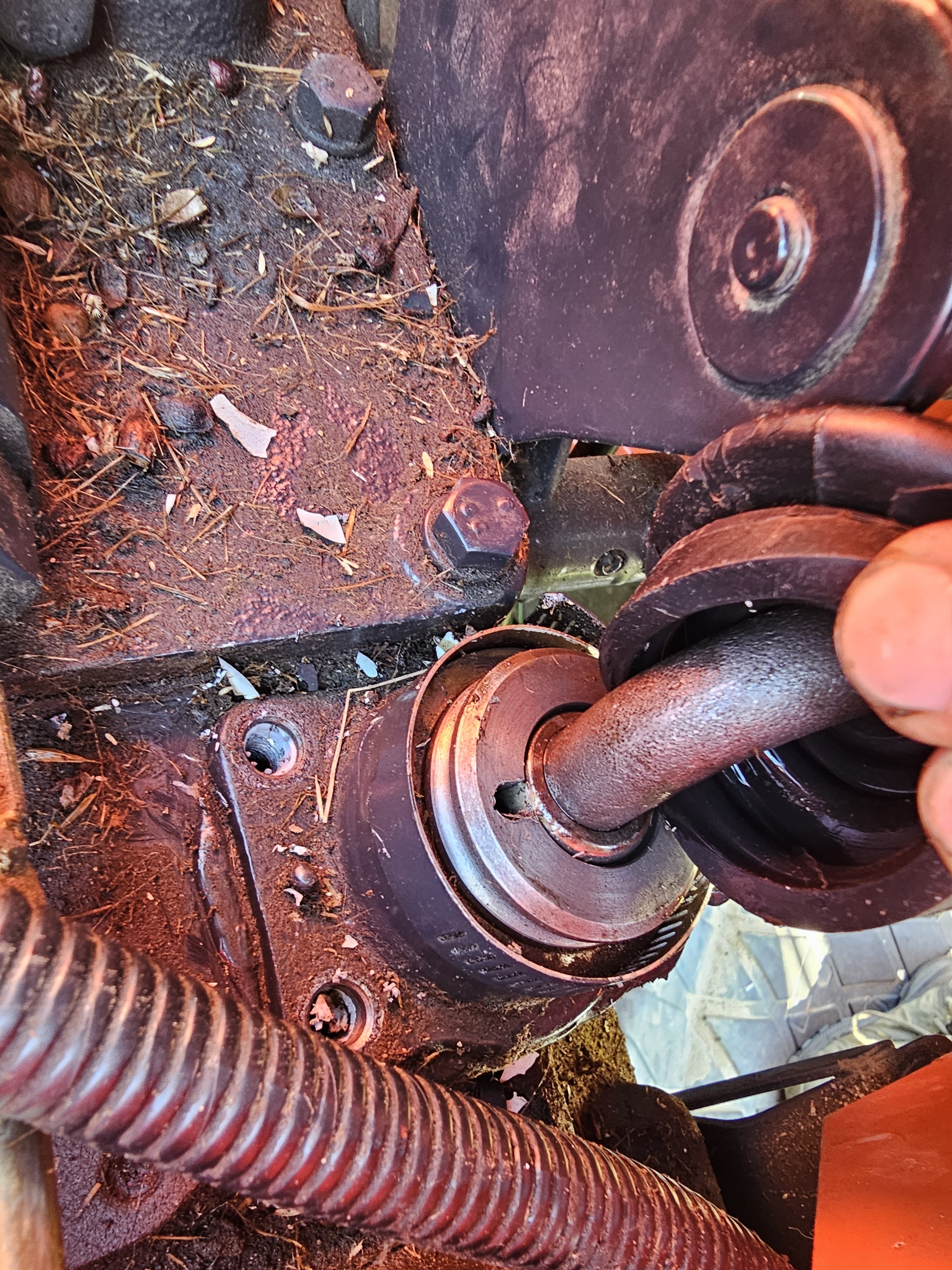

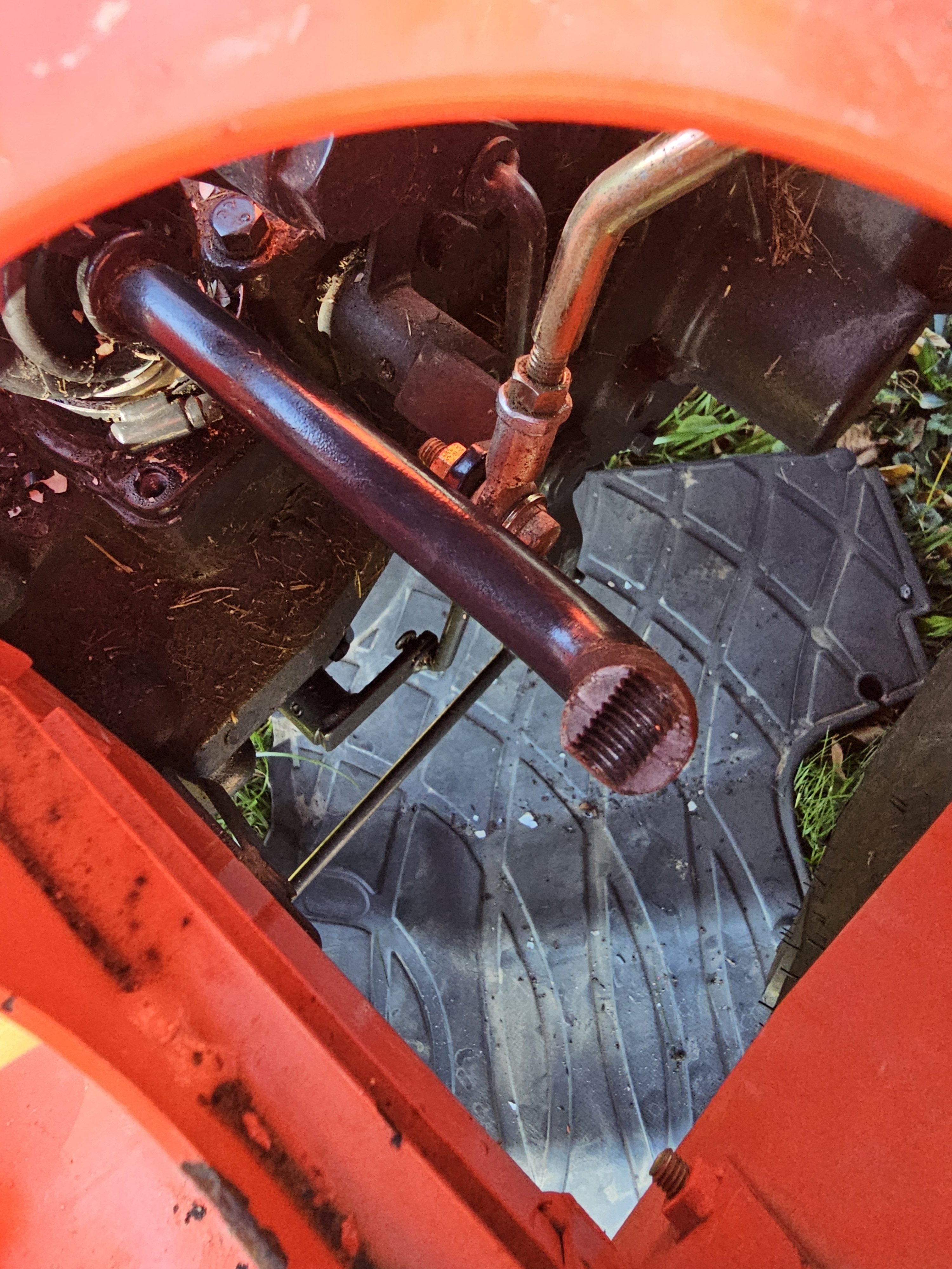

I had the same issue with my CK3510 gear shift. I attributed the lower linkage (Item 13) breaking due to stress I put on the shift lever when the hammer loop on my wool bibs went over the shift knob while I was attempting to dismount the tractor, along with the back of my jacket slipping over the shift knob on 3 occasions. All four times the linkage experience torque from me attempting to dismount the tractor. The gear shift linkage broke while I was piling up brush from several windfalls, under normal (no stress) R to 2 shifting. I was dumbfounded when the gear shift link failed. It'd been months since the last episode of me catching my jacket on the gear shift knob.
I purchased the lower linkage (Item 13), that goes into the transmission housing, and replaced it myself. 2.5 hours sounds about right, doing it the first time. I could probably do it in less than an 1.5 hours now that I've done it once.
I did JB Weld the upper and lower linkages together and used the tractors for several months before replacing Item 13.
I hope you see these, and I'll attach pictures. I broke the main shift lever and I took the 4 bolts out of the base plate and can't figure out how to get the main shift lever and plate out so I can change it out.
Thanks
