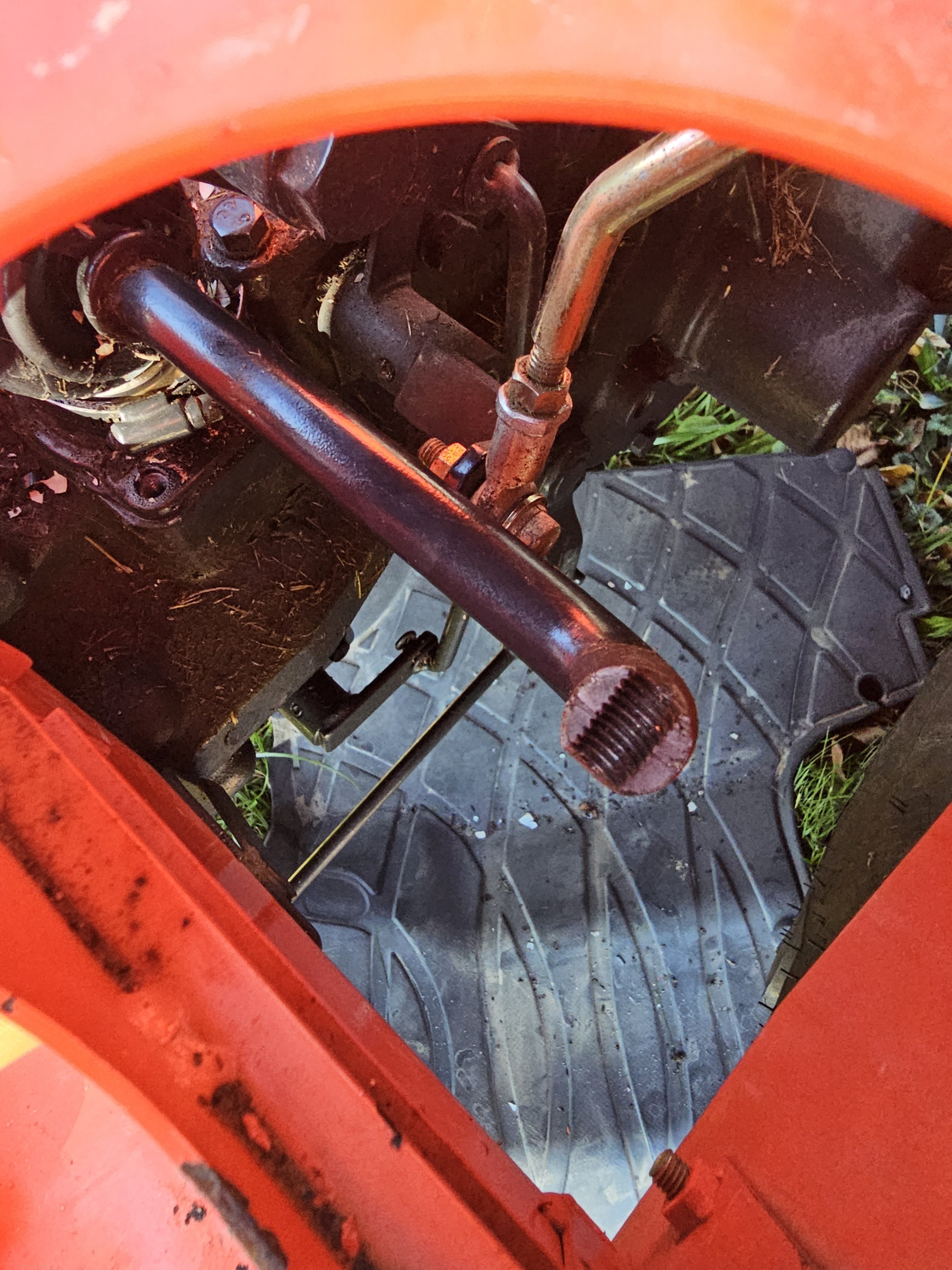

Hello everyone,
This weekend when I was operating my CK3510 I went to shift into reverse and the main shift lever broke off. The part that broke off is the piece that attaches to the transmission. On this section, one end goes into the transmission and the other end has a 90 degree bend on it which is bent straight up with two holes tapped into it. It snapped off right where the threaded holes were tapped into the shaft. The second section of the shift lever that has the shift knob on it is not broken. In fact I was able to remove the two bolts that would normally attach it to the lower main shift lever, pull what was left of the broken piece that slips into the upper lever and barely slip it onto what was left of the lower shift lever in order to drive the tractor back to the house.
I looked into the service shop manual to see if I could identify what part would actually need replacing and if it was something I could do myself. It looks like the lower main shift lever might be able to be removed so I could either get it repaired or replaced. I am capable, and normally do my maintenance services and other repairs on this tractor and my other vehicles I have. however I am not wanting to tackle opening up the transmission because it looks like something I could get in over my head.
Has anyone ever removed the main shift lever on a 3510 without opening up the transmission? My other option is to slip the upper lever over what is left of the lower shift lever and weld it. This might be the easiest way however if the transmission ever needs to be removed the welded lever could become an issue. I would appreciate any advice on this. Thank you, Sully

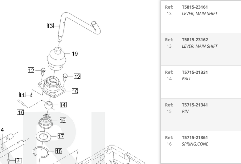

I had the same issue with my CK3510 gear shift. I attributed the lower linkage (Item 13) breaking due to stress I put on the shift lever when the hammer loop on my wool bibs went over the shift knob while I was attempting to dismount the tractor, along with the back of my jacket slipping over the shift knob on 3 occasions. All four times the linkage experience torque from me attempting to dismount the tractor. The gear shift linkage broke while I was piling up brush from several windfalls, under normal (no stress) R to 2 shifting. I was dumbfounded when the gear shift link failed. It'd been months since the last episode of me catching my jacket on the gear shift knob.
I purchased the lower linkage (Item 13), that goes into the transmission housing, and replaced it myself. 2.5 hours sounds about right, doing it the first time. I could probably do it in less than an 1.5 hours now that I've done it once.
I did JB Weld the upper and lower linkages together and used the tractors for several months before replacing Item 13.

Thanks for the reply American Elm. I ended up ordering the lower shift lever from a dealer here in Colorado and replaced it myself. It took me longer than 2.5 hours because I took my time and cleaned everything up while I had the seat and brackets off.
I think the design of how the upper and lower shift lever connect is flawed. I expect that it will break again sometime. The two holes that are drilled through and threaded in the lower shift lever don't need to be as big as they are. They serve no purpose other than keeping the upper lever from being pulled off. the same effect could have been accomplished by a small hole with a set screw and some lock-tite. If I am ever faced with this repair again, I will be welding the two together.

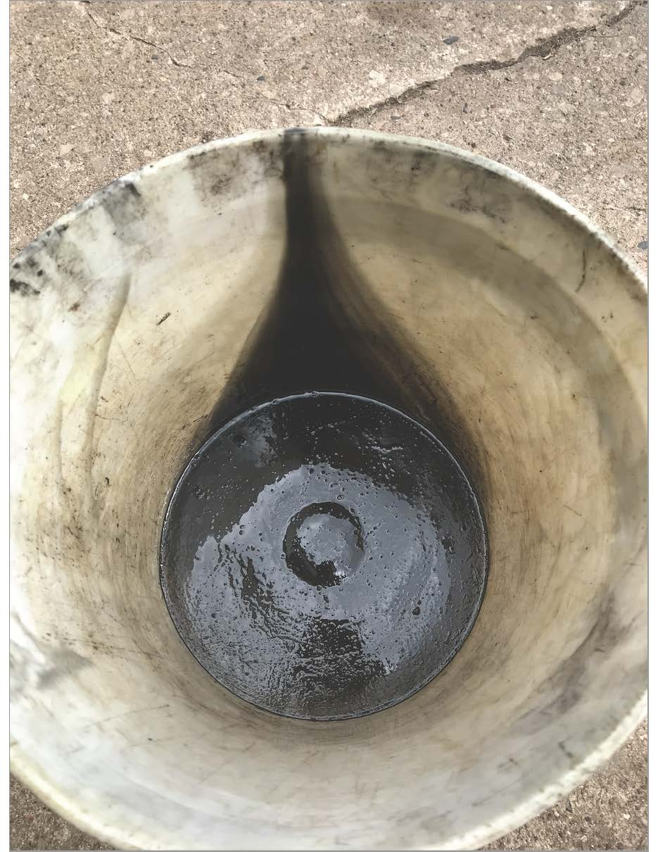

One recommendation I'd like to pass along. Check your hydraulic fluid for contamination on a regular basis. While plowing snow a year ago, my transmission became very difficult to shift. The transmission would get stuck in reverse and was difficult to engage into reverse and 2nd. 1st and 3rd gears seamed to shift fine. I was hoping it was a damaged detent or broken detent spring. The dealer had me apply a lubricant to the shift rails that made the hydraulic fluid more slippery. While applying the lubricant, I noticed the hydraulic fluid was a dark grayish color - something wasn't right! In the end, the dealer split the tractor and replaced the synchronizer hub and rings. The hub acted like it was filled with ultra fine grit. It didn't want to slide back and forth.
The photo is sediment left in the bucket used to catch the hydraulic fluid. The bucket hadn't been used to catch/hold any type of oil prior to catching the hydro fluid. The fluid sat in the bucket for a couple of days before I poured it into jugs to transport to the recycling center. I shared the photo with my Kioti dealer. They couldn't explain why there was so much sediment in the fluid.
I followed the service schedule for changing the hydraulic filter and fluid. If I had to do over, I'd of changed the hydraulic fluid at 200 hours, as I changed the filter at 50 and 200 hours. The dealer isn't certain what caused the fluid to become contaminated. That's concerning as my warranty runs out in another year.

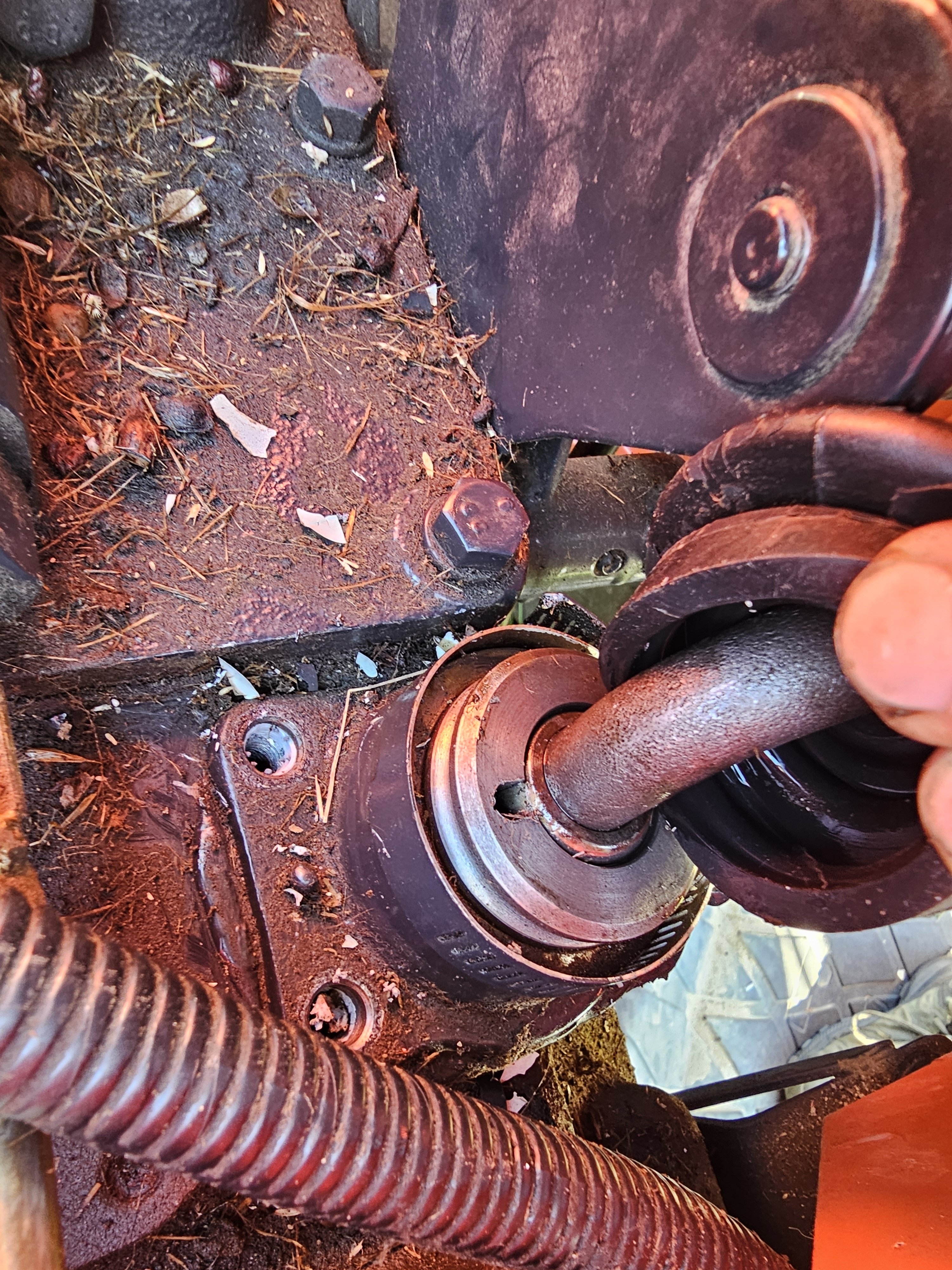

I hope you see these, and I'll attach pictures. I broke the main shift lever and I took the 4 bolts out of the base plate and can't figure out how to get the main shift lever and plate out so I can change it out.
Thanks
