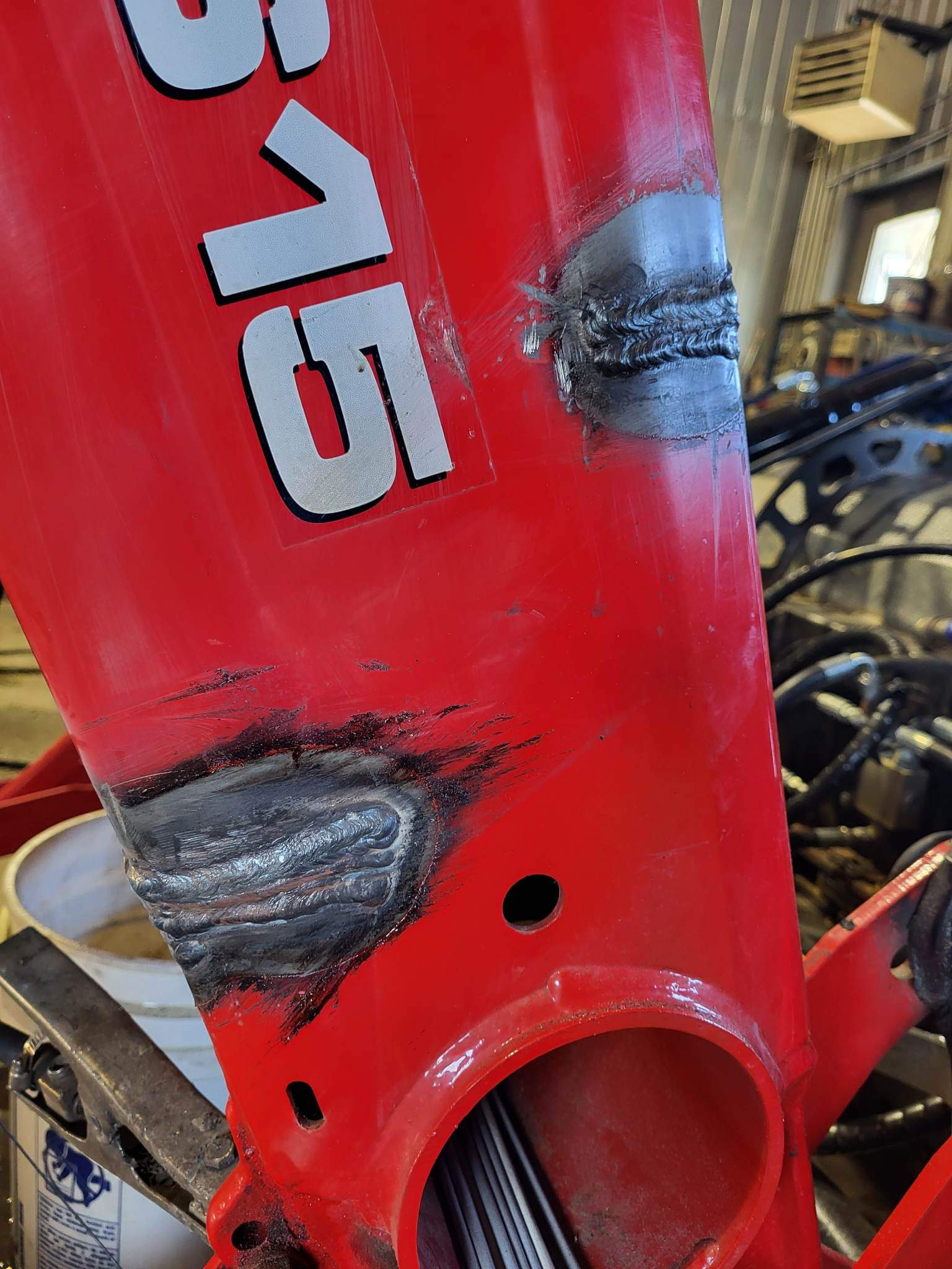

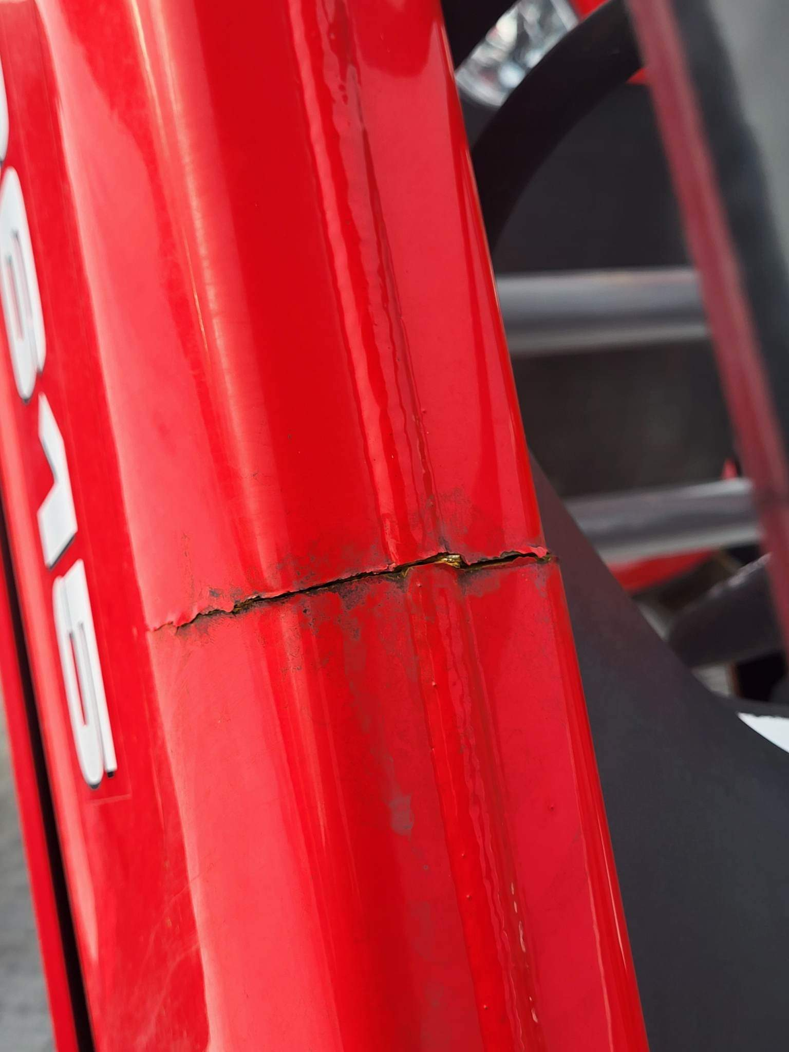

Does anyone have heard of a fl 3615 loader cracking? My buddy has one that has severely cracked around where hoses come out of bottem of loader

Pictures of loader

Pretty unusual. Most tractors/loaders do not have the strength of hydraulic force to break a loader like that. When they do break the ones I have seen usually break at welds and usually where some unusual leverage or bending was applied. I'm NOT a loader expert by any stretch but I've not seen this before.
I see where these FL series loaders are pre-stressed and the beams are narrower than traditional loaders. Claims are that they are stronger -- your buddy's experience brings that into question. I would think the MF regional rep needs to be contacted immediately and shown this break. And asked if there are others reported. Pretty serious stuff.

This tractor is used to push snow

Tractor is 3 years old dealer was contacted and pictures were sent to massey

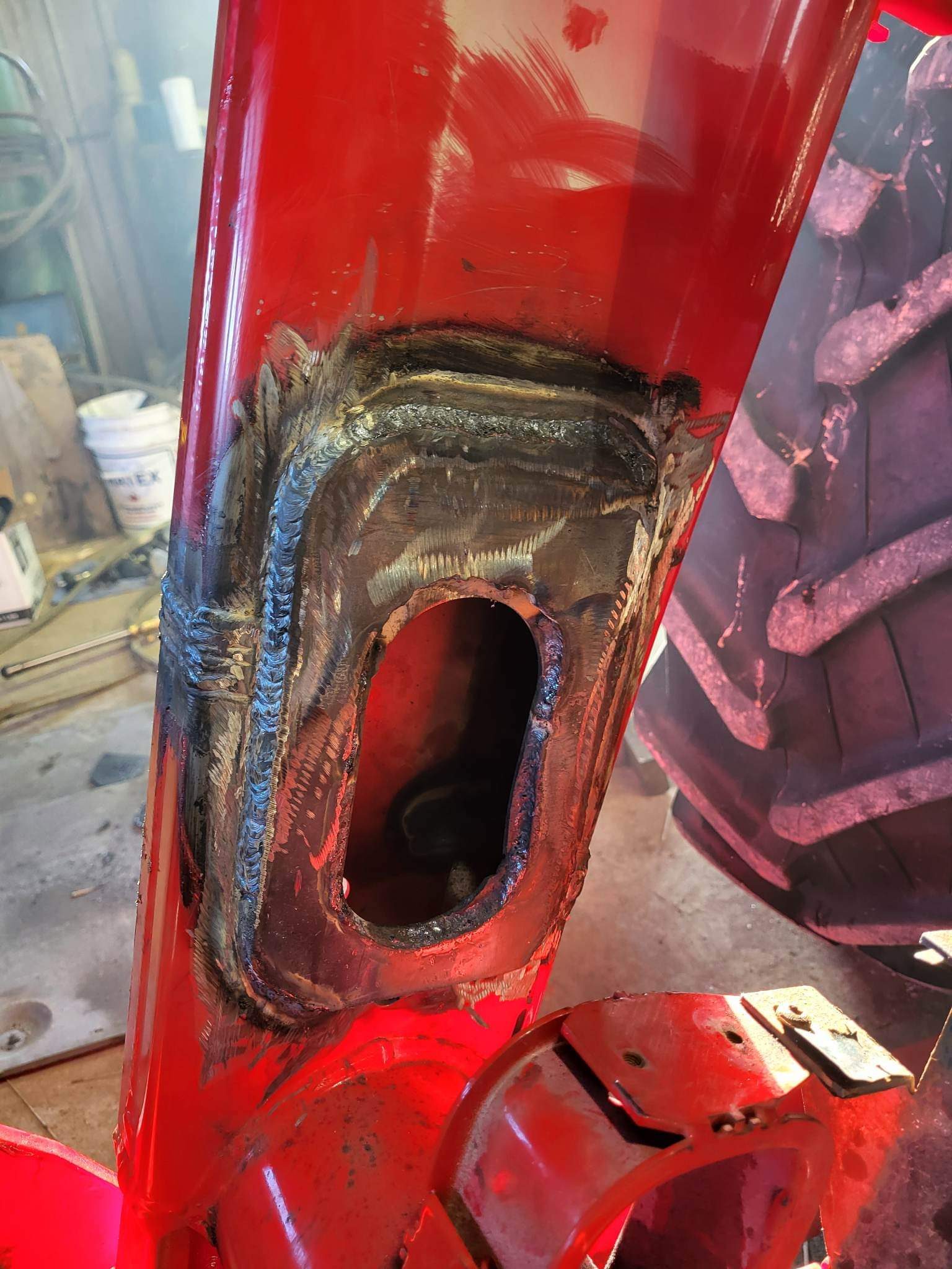

Pushing snow is hard on a front end loader hitting obstacles and whatnot looks like you're out of warranty so weld/fish plate it up and be on your way

Ive seen several broke ones. Weld it up and continue on with life.

If you plate it, weld one on the other side so it looks like it came that way.

Drill a hole at the end of the crack to stop the crack from spreading further before you weld it.
