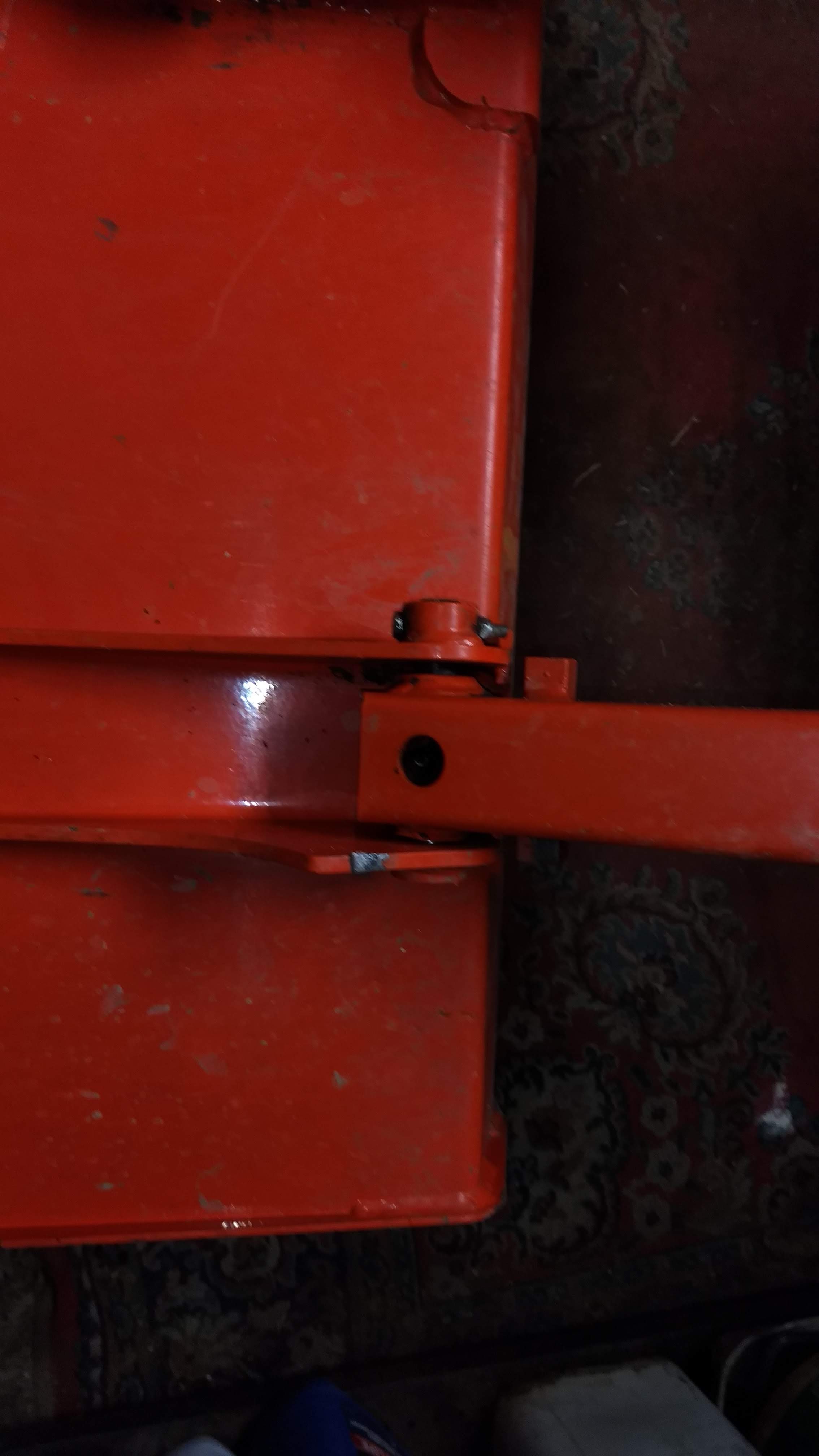

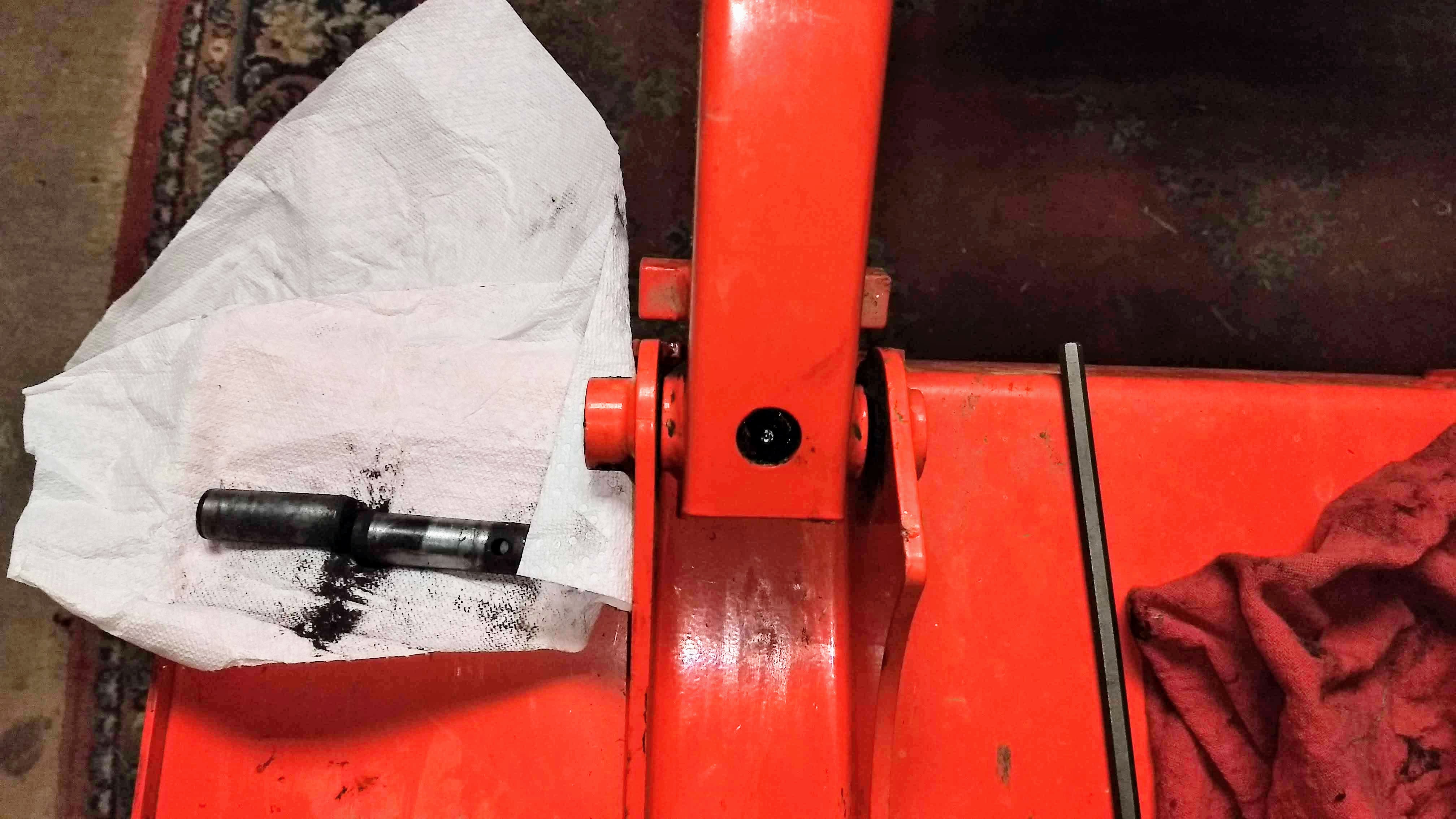

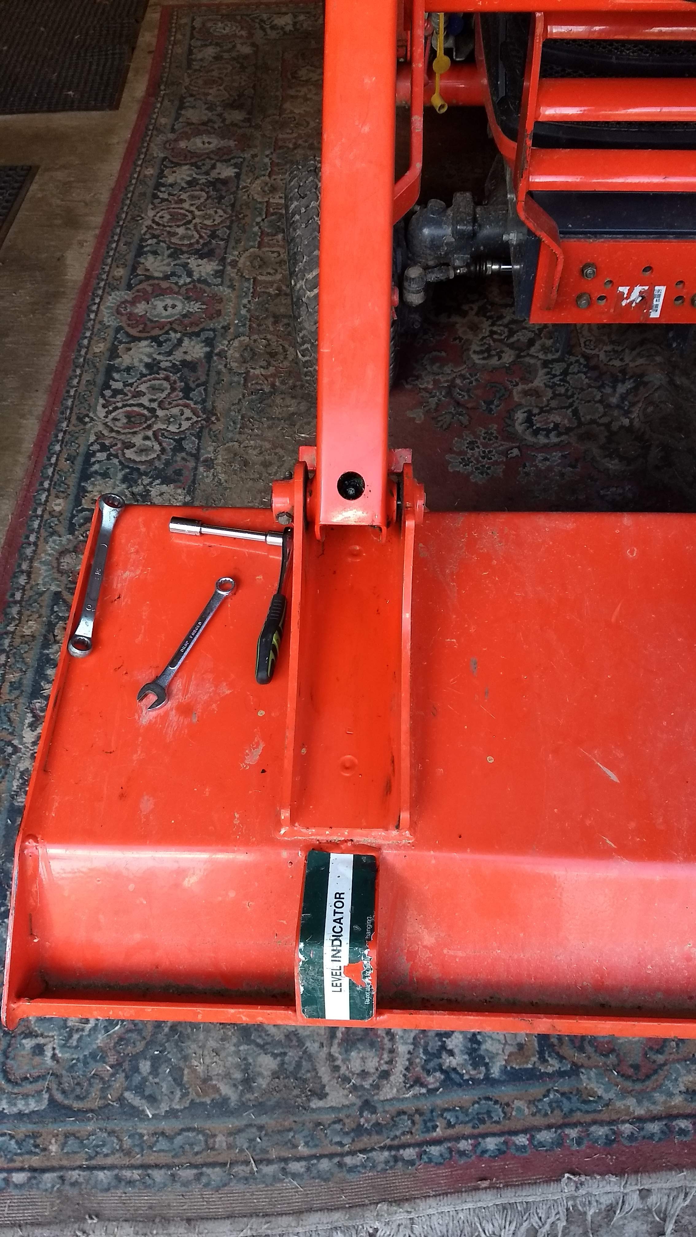

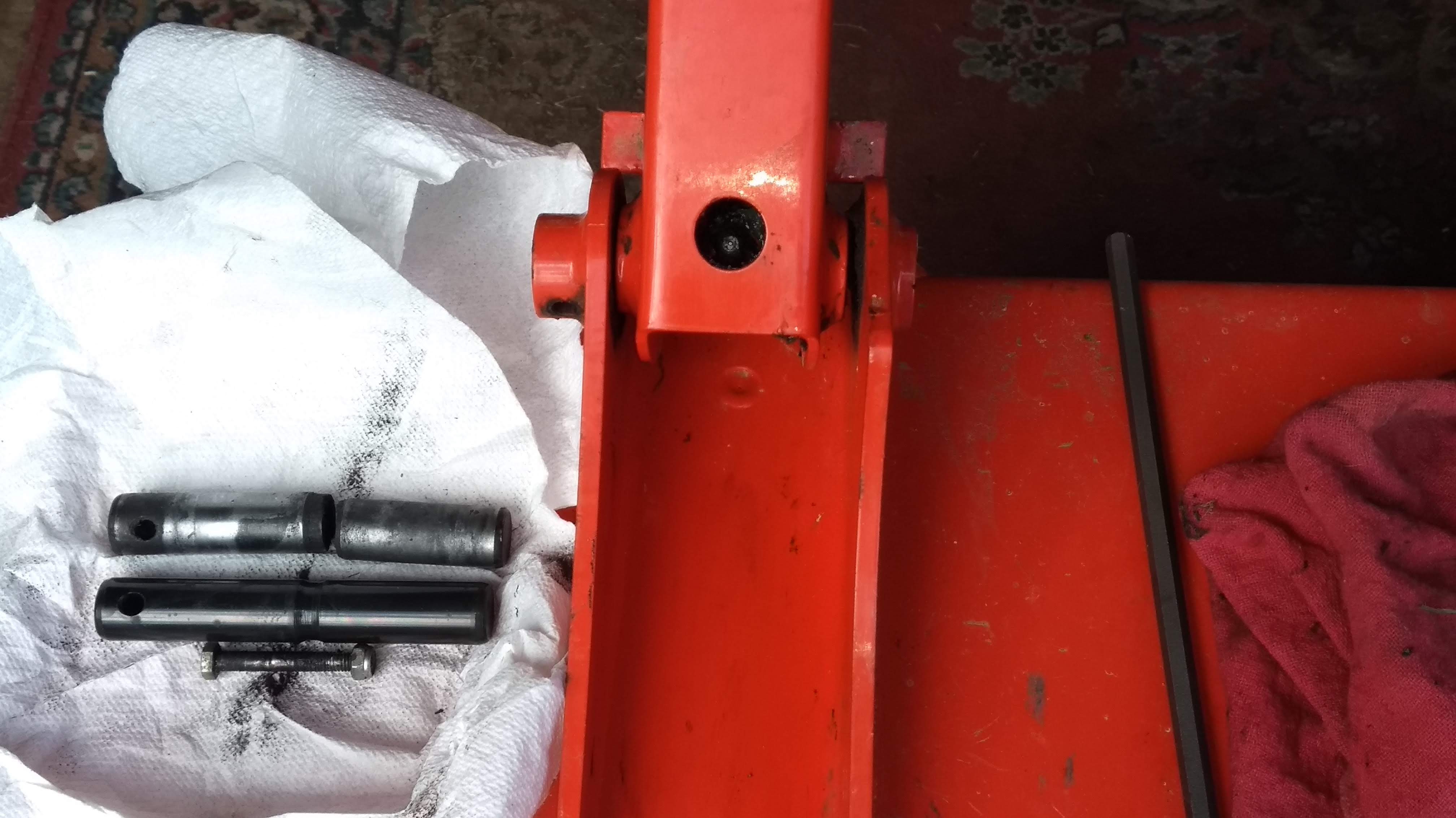

   / broken FEL arm to bucket attachment pin
IMG_20201002_170115802.jpgIMG_20201002_170106719.jpgIMG_20201002_165437818.jpgIMG_20201002_102416195.jpgIMG_20201002_102403605.jpg
Thanx moship & repete for the time and effort you spent to help me!!
Have a happy happy, KW
