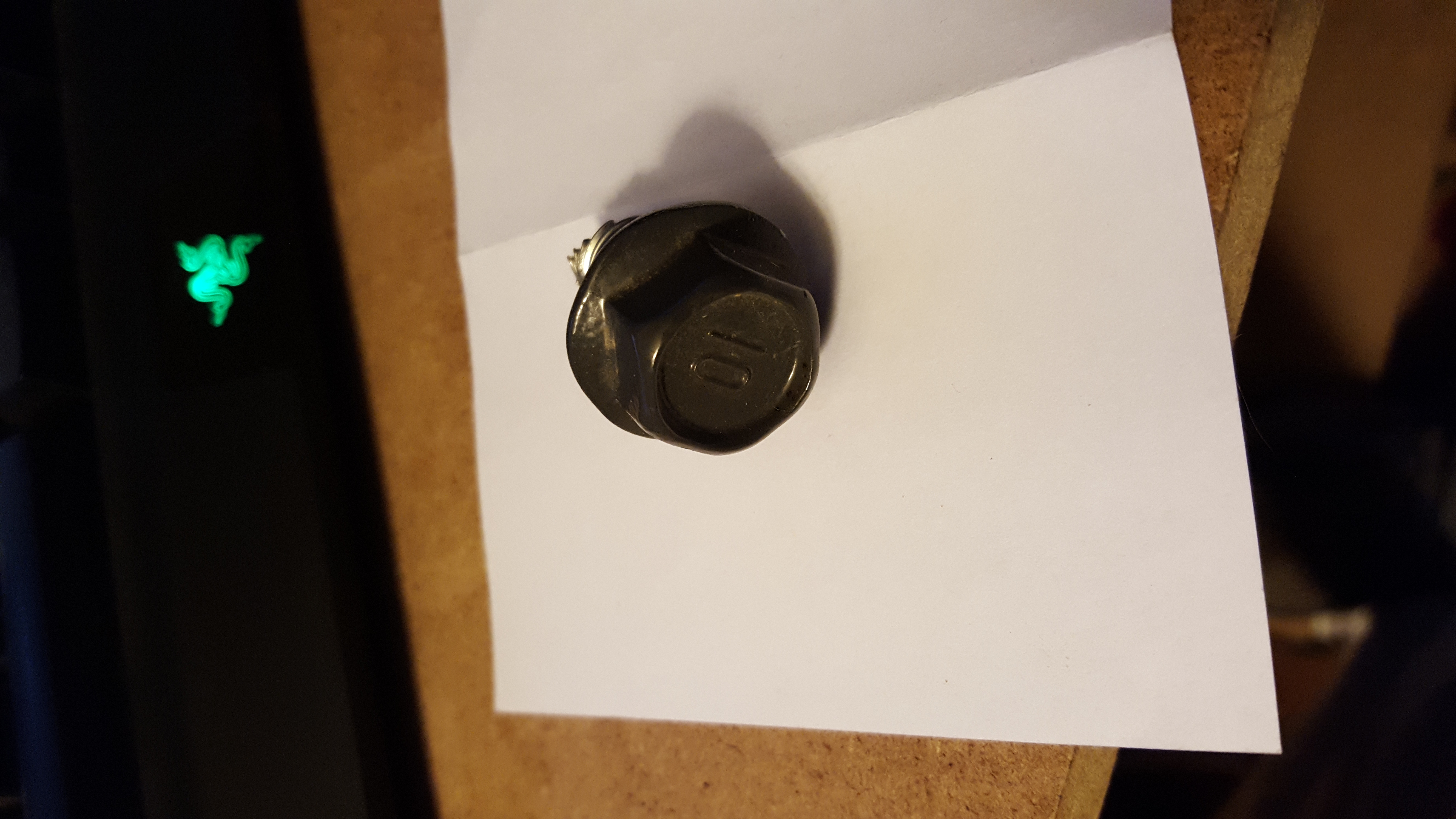

Lots of good info here. I plan to call the dealer in the morning as soon as they open. I would think they could just send a truck out, remove the broken part of the bolt and check the hub and replace 2 bolts. should take no longer than a couple of hours. you would think.... BTW here are pics of the bolt head and shaft that came out. Notice the head has never been touched after they painted it so they cant say I was messing with the bolt.
ovrszd, I also paid a premium for the warranty so I didn't have to worry about stuff like this. just sucks to be just getting ready to start her up and do some work and then a big POP while greasing the fitting. I was looking for the grease to come out of the bottom and then bang. oh well now to the pics....

That pic on the left - the bolt has an unusual appearance. Stress failure or stress fracture doesn't normally produce a bolt that looks like that. That bolt looks like its been squeezed and sheared off.

BOLT FAILURES
You might want to take a look at this link. Compare your bolt to Figure 3. Appear to have the same 45ー shear plane typical of an overload failure.
http://www.boltscience.com/pages/Failure Modes.swf
The second link - go to slide 7 to see the same type of failure mode, also shown to have resulted from overload.

I don't think the bolt was over-torqued, as that would have left somewhat of a helical fracture surface. In this case, it looks like it was an extreme tension load along the length of the boat. How the heck could that have happened? I am having a hard time envisioning a situation where that bolt would get an extreme tension load.
Might be interesting to see a closeup photo of the fracture face, to see if there is an obvious defect in the bolt. If that were the case, I'd expect it to fail in torsion when being torqued down, but who knows.

s219 - exactly my thoughts also. I can't figure how a bolt at that location would be subject to a load that would shear it off or stretch it like that. There could well be something else going on here. I figured the head of the bolt would be just popped off but that picture casts a different light on this situation.
Teddy - I would be sure that the dealership gets a chance to see that bolt - shown in your pictures. I would want them to determine the cause of this problem and not just replace the bolt. I would also have them check all the bolts on both sides for signs of failure.

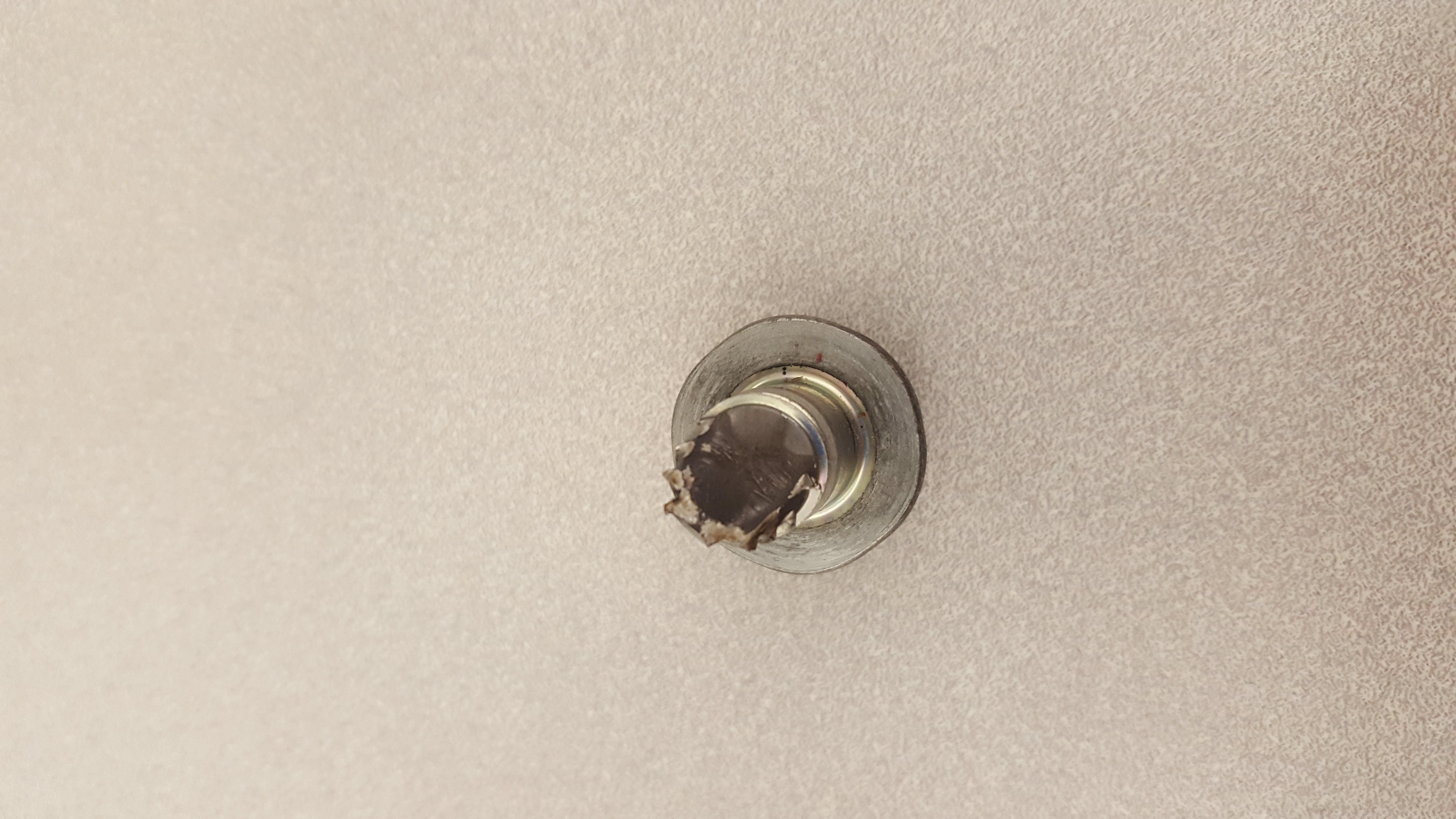

S219, here is a closeup of the bolt face. I am really interested to find out the cause as well.

Well, it looks like the outer part of the bolt, where you see the zig-zag of the threads in the upper-left of the photo, has both a shiny appearance and some rust, which suggests it was cracked for a while. The shiny part would have come from the metal rubbing against itself, and the rust from exposure. Hard to say from the photo -- does it look like that to your eye? The inner part looks more like a fresh fracture. As to what caused the original crack, hard to say. It's possible the heat treatment was not right, making the bolt susceptible to fail in this unusual way. Don't see any defects in the freshly fractured portion.
One possibility is that the bolt went in off-kilter for some reason, either cross threaded, or the receiving tapped hole was not perfectly perpendicular to the surface, or the bolt threads were not cut right, and then when the head was snugged down flat, it bent the bolt. Does it perhaps look like it may have gotten bent slightly? Any indication the threads took abuse? That would probably lead to the type of fracture seen in the photo.

At a guess. And only going by what my eyes tell me, that bolt had been partly cracked/fractured since it was installed, and just part in the middle is fresh. So it has probably been slightly bent if it's only been holding by a small area. Hard to say, only have a tiny screen but it sure wasn't grease pressure that did it, would it have been lashed down across the front axle, perhaps if the machine has nowhere handy as a lashing point, that it would be held down by a strap over there?
