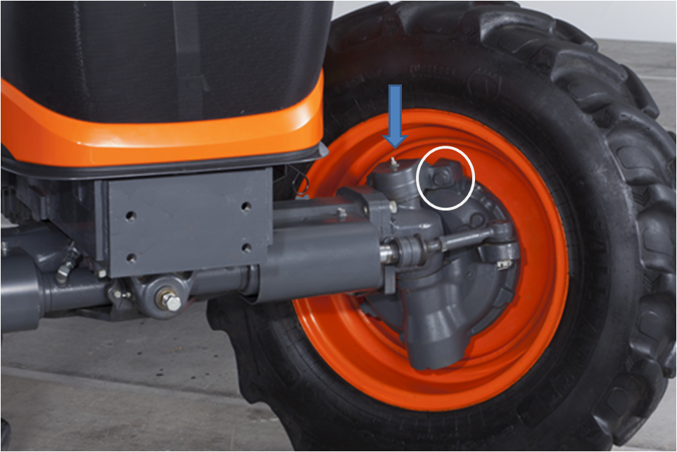

Yesterday I was greasing up the Brand new MX5200 tractor (70 hrs) I bought to clear 50 acres of cut-over land. While greasing the left front knuckle, the bolt holding the top cap on sheared off??? I hope you all can picture what that is. Its the grease fitting just inside the tire on top of the knuckle. I'll try to find a pic later.
So I have 2 questions....
1. how could a few zirks of the grease gun shear the bolt? could it have been over torqued during install? or did I do something wrong? I was taught to grease all the fitting every 10 hours or so. I'm just trying to figure out why so I don't do it again.
2. Is there anything special I need to look for when replacing the bolt? tips/tricks?
Sorry for the rambling but I would have never expected the bolt to shear just from the grease gun?
Thanks in advance for any help!
Teddy

You guys are AWSOME! I wouldn't have thought it was possible either???? I'll try to attach the pic here.
1. the white circle is the horizontal bolt that sheared off. the arrow points to the zirk used to grease the knuckle.
I dont have a problem extracting the bolt and replacing. are there any tricks/tips in the procedure? It looks straight forward only 2 bolts.

Yeah, Sorry for the delay, the Zerk is good it was the bolt holding the knuckle end cap to the hub I believe. Its a big bolt so I'm thinking it was over torqued and had a crack, or just a weak part?
Teddy

Grease has nothing to do with that bolt shearing. Look at his picture carefully. He has an arrow pointing at the grease zerk. If that joint is over greased it will simply squish out around the bottom edge of the cap. I grease mine until it does.
The large bolt that he circled is the one that is broken. That is a very serious breakdown. The tractor should not be used again until that's repaired. By used I mean don't drive it at all. Tomorrow morning you need to call your dealer or visit them with pictures. They will have to service the tractor where it's sitting.
