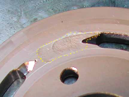

After splitting the case, I first removed the motor (1st, 2nd photos). On first inspection, it
looked OK. The slippers looked smoother than I am used to seeing. Other HSTs
have pre-cut scratches in the slippers to help retain an oil film. I will check the
thickness with a micrometer later, after getting the spec from the manual.
I meant to report on the slippers, but I do not have a good close-up of the
pump slippers. I did mike them.
The manual has no spec on the slipper thickness, as I would expect, so I
just compared the thickness of those from the motor to those from the
pump.
They were the same. The pump slippers do have the pre-cut micro-scratches
that I expected to see on the motor slippers. This indicates to me that
none of the slippers had experienced significant wear.
Why the maker did not use micro-scratches on the motor slippers, I do not know.

Sure was cavitation, I was going ask how it was getting air but Roy posted the
reason.
Whether the proximate cause of the erosion of the valve plate was boiling or cavitation, which are very
similar, heat was a major factor.
Cavitation or boiling occurs when the vapor pressure of a fluid exceeds the ambiant pressure. Get any
fluid hot enough and it boils, even when the fluid is in a closed system under high pressure. In a
dynamic system with fluid flowing, any interruption in the flow causes lower pressure regions in the
fluid, sometimes resulting in bubbles of vapor to form locally (cavitation). Usually those bubbles
immediately collapse, which can cause damage to the surrounding surfaces of the fluid passages.
Cavitation can also occur at the inlet of any pump, as it attempts to move fluid by applying
low pressure to it. That is one of the reasons there in a charge pump to pressurize the
inlet on the HST pump. A pressure test by Bob's mechanic showed it was working.
The system RV, passing full flow of the implement pump at 2000psi, to the tank at 0psi ambient is
going to cavitate the fluid, as OnS says. After minutes of this abuse, the fluid in the tank is
going to probably aerate with all that agitation. Will the whole 5-7 gals of fluid get a bit foamy?
Possibly.
Entrained bubbles can even explode (Diesel) when pressurized by the system, if they
contain the right combo of oxygen and oil vapor. It is possible that the fluid was
dieseling at the high-pressure region near the valve plate. I suspect that dieseling
would foul the fluid rapidly.
But Bob reported that the loader still worked fine while he was experiencing loss of HST power.
Was it under-performing due to entrained air? Maybe, maybe not.
To me, that points to more localized boiling at the point of highest pressure on the fluid, at the
pump valve plate. Just my opinion. I welcome others, too.

It may be me, but I don't see the wear you refer to on the port(s) etc. I do see subtle scratches on some metals you
showed and some darkening of the metal discs in others. Can you possibly circle the exact areas you're referring to,
if not too much trouble, for us feeble minded older guys?:confused3:
See yellow dotted line.
When I refer to a "fingernail" test, if I can feel any ridge with my nail, that is a failure. Also used
with engine cylinder bores, cylinder heads, other critical mating surfaces, etc.
