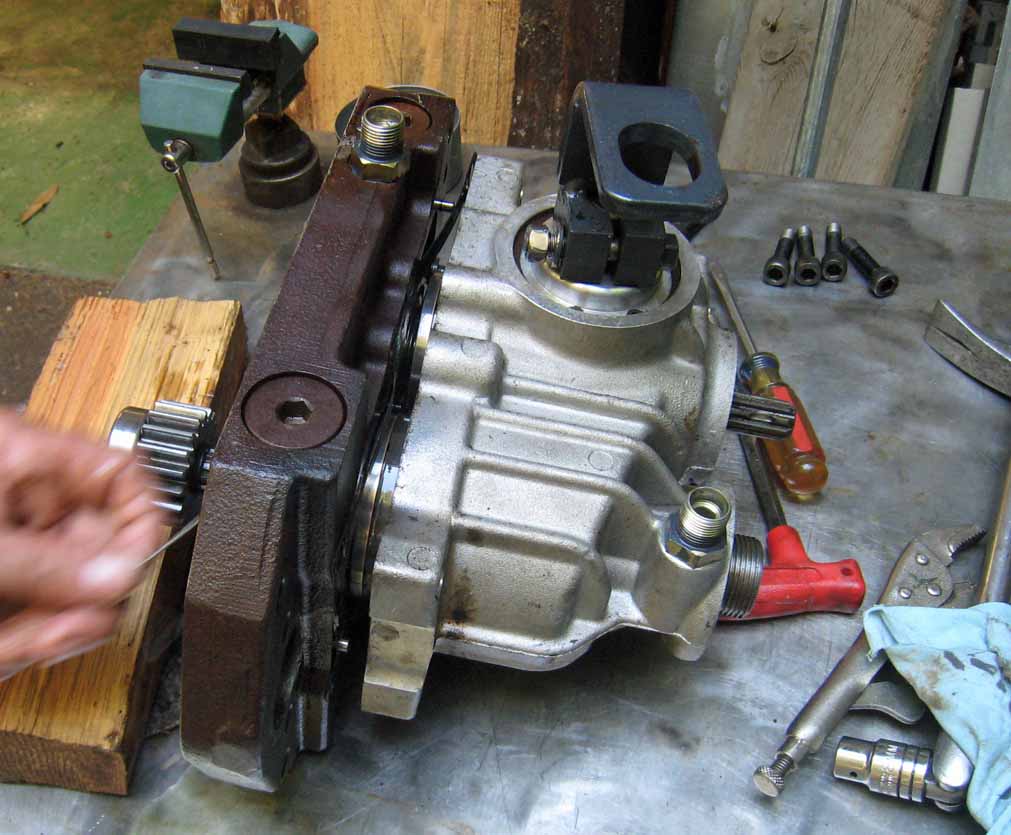

/ Broke Hydrostat twice? Why? #163
Good photos of a failed GST unit, MHE.
Back when I repaired my Kubota B21, purchased with a bad transmission, I was able to get a quotation
for the HST pump or motor separately. But components of each were not sold separately; the pistons
were all "matched" to the cylinder blocks. I do think that any bad pistons with slippers should have
been replaceable separately, as long as the bores were in spec. Even in a case like yours, as you say.
I did end up buying the charge pump separately cuz the rotor and block showed some wear. In that
HST, the charge pump is on the front of the HST. Other HSTs have it separate.

OP here. I'm back home after a really beautiful drive down and back on the coast highway from northwest Washington to just south of Big Sur. Just wow!
The visit with Dkrug was very satisfying indeed. I am sure he is right in his analysis (it was fascinating to watch that analysis develope through the postmortem).
It is now my responsibility to use the knowledge gained here to change my methods/habits so that there is no repetition for me and perhaps avoid such failures for others who read this.
The way I see it, the cavitation was caused over time by oil thinned by excess heat. The likely culprits and remedies are :
The rear remote detent lever. It is almost certain that the tractor ran for extended times with the lever pushed over into full detent position, deadheading the oil flow and creating heat. This process is particularly diabolical because it would have to happen as I climb onto the tractor, sometimes brushing the lever over into detent - then starting the tractor and not noticing the slight lowering of RPM and slight straining of the motor. No relief valve sound to my ear.
So I can't be sure how often or for how long this happened.
Anyway, it won't happen again. I will devise a way of locking it into neutral position and if I have any doubt at all of its effectiveness, I will have a quick connect hose made as described by others.
I will be more conscientious about cleaning the oil cooler.
I will install a temp guage. I'm not sure how yet, but I'll learn.
I will fix the front grill. It won't be pretty.
I will pay more attention to RPMs in future, using more when there is more work to do.
I will lean towards using low gear more often.
I will not use cold weather oil.
Please feel free to add to or modify anything on this list.

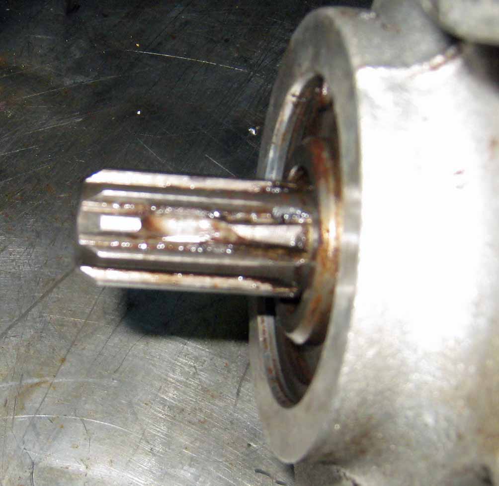

/ Broke Hydrostat twice? Why? #169
Here are a couple of photos that Susanne took. One is a better look at the broken
spline on one of the shafts.

Interesting thread even 2 years after the fact. As others have pointed out, I agree the manual is incorrect. Transmission neutral at full HST pedal is useful to check charge pressure since you would have the additional fluid loss introduced by the motor rotating instead of just the pump. Then put it in gear and stall the HST to check the forward and reverse high side pressures.
As far as the postmortem photos, I'd attempt fixing it. What is the depth of the erosion? If it's not all the way through the brass/copper colored coating, my father an I have resurfaced those plates by wet lapping by hand starting around 150-200 grit emery cloth and slowly working up to 2000 grit crocus cloth until smooth again. Need a very flat surface and even pressure, but aside from a few dollars for emery/crocus cloth the only investment is time. My 4400 was done that way 2 years ago and my grandfather's 400 garden tractor about 20 years ago. I've got about 75 hours on my tractor, his had several hundred last I checked, both running fine.

Update
I brought my tractor to the dealer and they replaced the hydrostatic transmission. The part was $2000 and the labor was another $2000. My tractor is now working great. I took some pictures of the broken transmission in various states of disassembly in case anyone is interested. Kubota BX2200 hydrostatic transmission - Google Photos
The damage was pretty obvious. The end of one of the pistons on the pump side had worn completely through and the spring was poking through it. The housing holding that piston was severely worn. There was also one other piston with a slightly worn housing. I'm planning to keep the old transmission for parts. If anyone is interested in buying some of the working parts, send me a private message.
