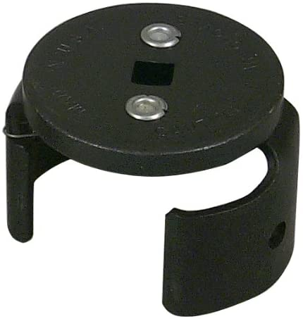

The second post by Indyjay is probably the best filter wrench I have but you can’t always get it in places. I’ve also got a very large set of channel locks that work if there’s room. Like everyone else I’ve had a few I used some very foul language on. It must always work because the eventually came off.

I know the feeling....sounds like we all do. I've got a drawer full of oil filter wrenches now. Including a set of cannister sockets, a gearwrench, and a 3 jaw. Back when I was doing mechanics for a living I only had on a strap wrench. What changed? I have no idea.

I had a '79 VW Rabbit that to change the oil filter I could kneel down in front of it, reach up behind the radiator with a 3-Jaw Oil Filter Wrench and undo the filter. EZPZ. The filter was pointed down with easy access.

My CUT filter is in very close quarters.
After rejected my collection of filter tools I resorted to a DIY method.
I use a short length of seat belt material and a pair of vice grips.
Wrap the seat belt around the filter can and grip the belt close and lever with vice grips using the fat side to lever tighten the belt as I rotate.
Works great.
LOL, then catch the mess.
The belt barely clears as I slip it onto the can as the clearance is that tight.

My first oil change on the Kubota - both engine & hydraulic. Long, thin bladed kitchen knife. Cut the "paint bond" between the filter and the tractor. Removal was much easier. They all came off easily with a band wrench.
/ Broke 2 Oil filter wrenches #31
Broke a new strap wrench, a different on slipped. Finally went and got a pair of Channellock filter pliers and that was that.
I discovered those were the only thing that could reach in past the rats-nest of loader hoses to loosen the fuel filter bowl ring on my Yanmar.

I changed the oil on my first car way back when, and made sure to put the new filter back on, nice and clean and dry. Next time, I had to rip it off pc by pc, and finally chisel the base plate of the filter loose. It wasn't on tight, but was just dry and wouldn't turn. Rub some oil on the gasket and 100% success from that point on. Some lessons really are learned the hard way. Why on earth do they continue marching forward with a known problem.
