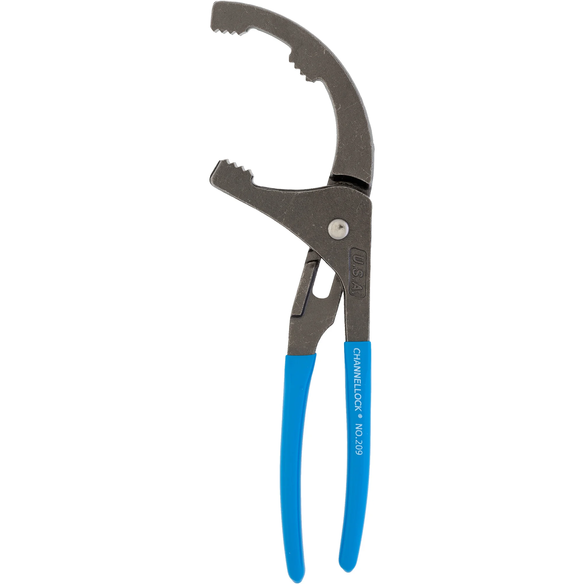

My first fluid change on my DK4510 was similar. Broke a new strap wrench, a different on slipped. Finally went and got a pair of Channellock filter pliers and that was that.
Those work well. They are messy because the typically punch holes in the filter, but they usually can get the filter loose.
