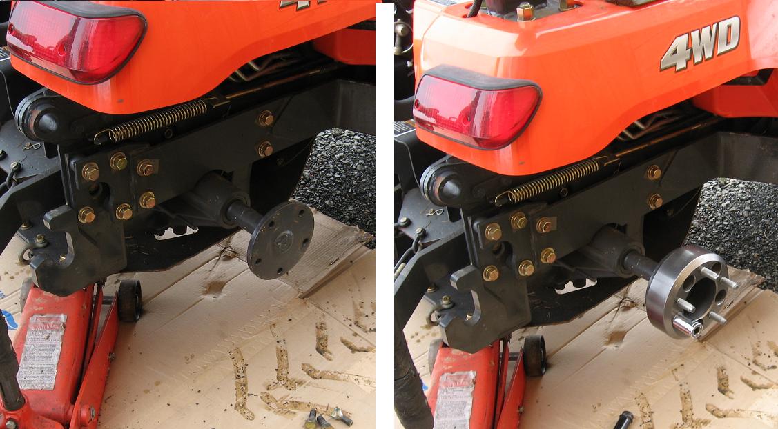

I mounted the Bro-Tek wheel spacers today and the tire spacing went from 44" to 49.5" out side to out side. It feels more stable using the bucket and I don't get that woops feeling when having the load at the outer edges of the bucket.
One other improvement is that I now have 5" of space between the tire and the side of the tractor frame. That will make it nicer when I mount the backhoe next time.
And as someone said you need a reguler socket to mount the wheel on the adapter, the heavy wall driver sockets won't fit.
All in all a very good improvement to the good old BX2200

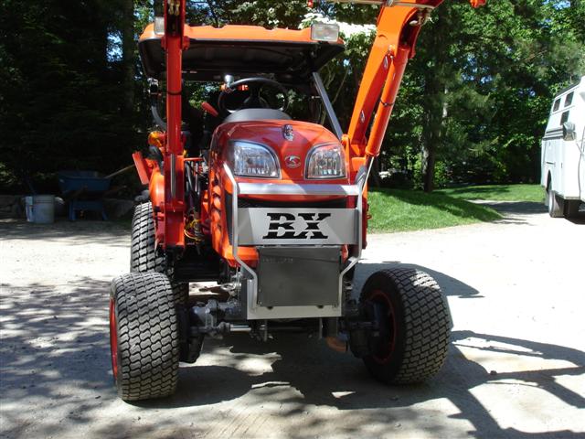

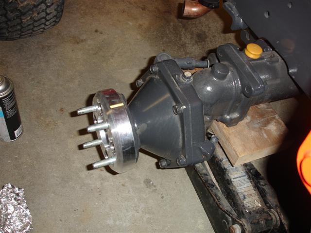

Here are some pictures of the spacers & the stance also. He fabbed front spacers for me also, but not as wide as the rears. Richard is great to do business with - have his bash plates also but have not had time to install them yet. By the way, if you order them make sure to set the studs with a punch - some of mine were not pressed home.
