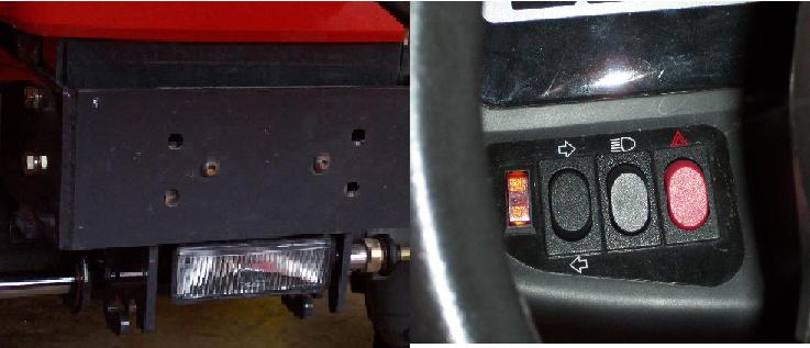

I too wanted to be able to see under the bucket in the dark so I mounted a single rectangular light under the front of the tractor and added a switch next to the other switches on the dash. I used some sheet metal bent on a 90 degree angle to mount the light to, and then used holes that were already in the frame to mount the sheet metal to. (See Attachment)

That would work for me too - what kind of light did you use? Looks like a fog or backup light
