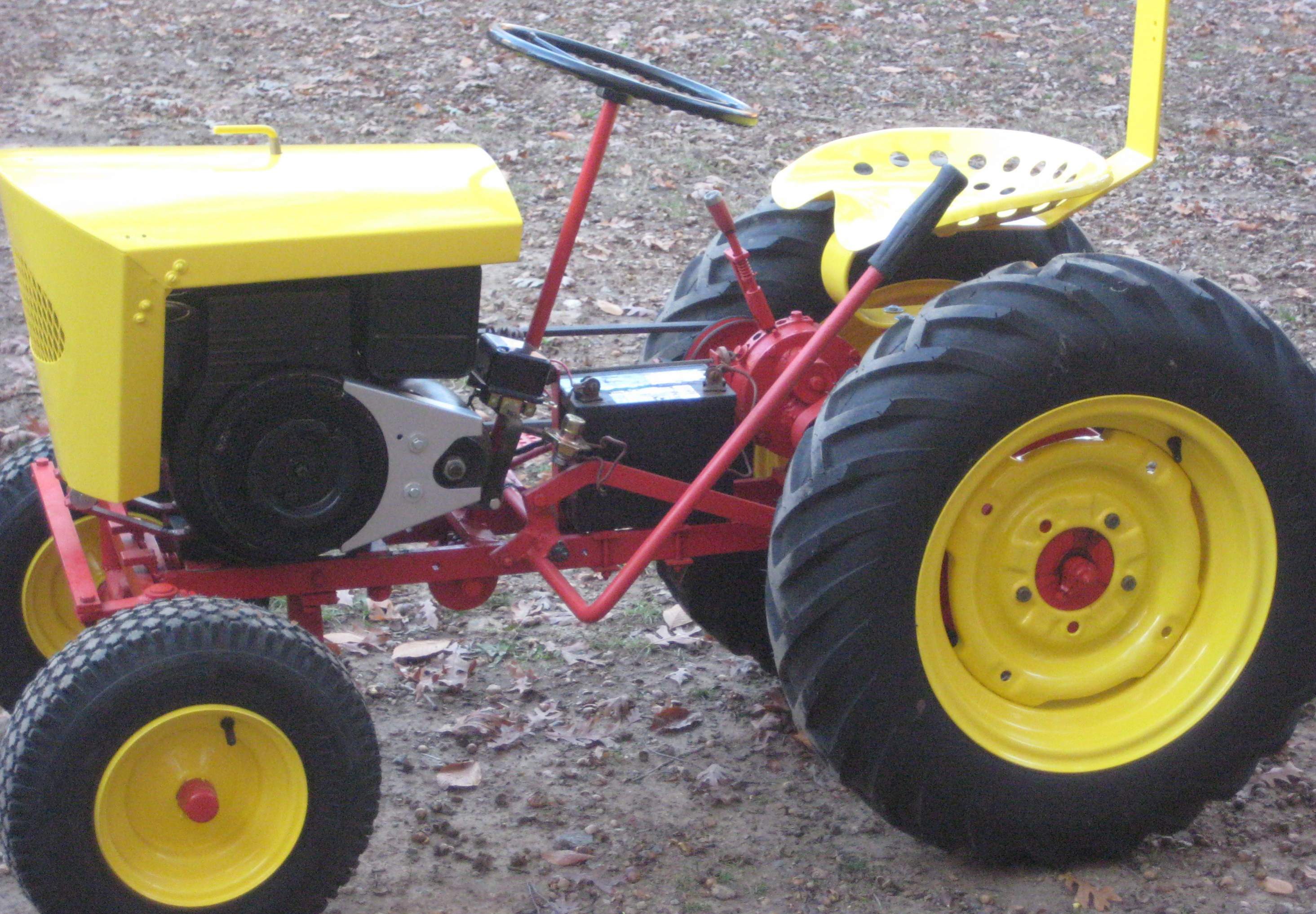

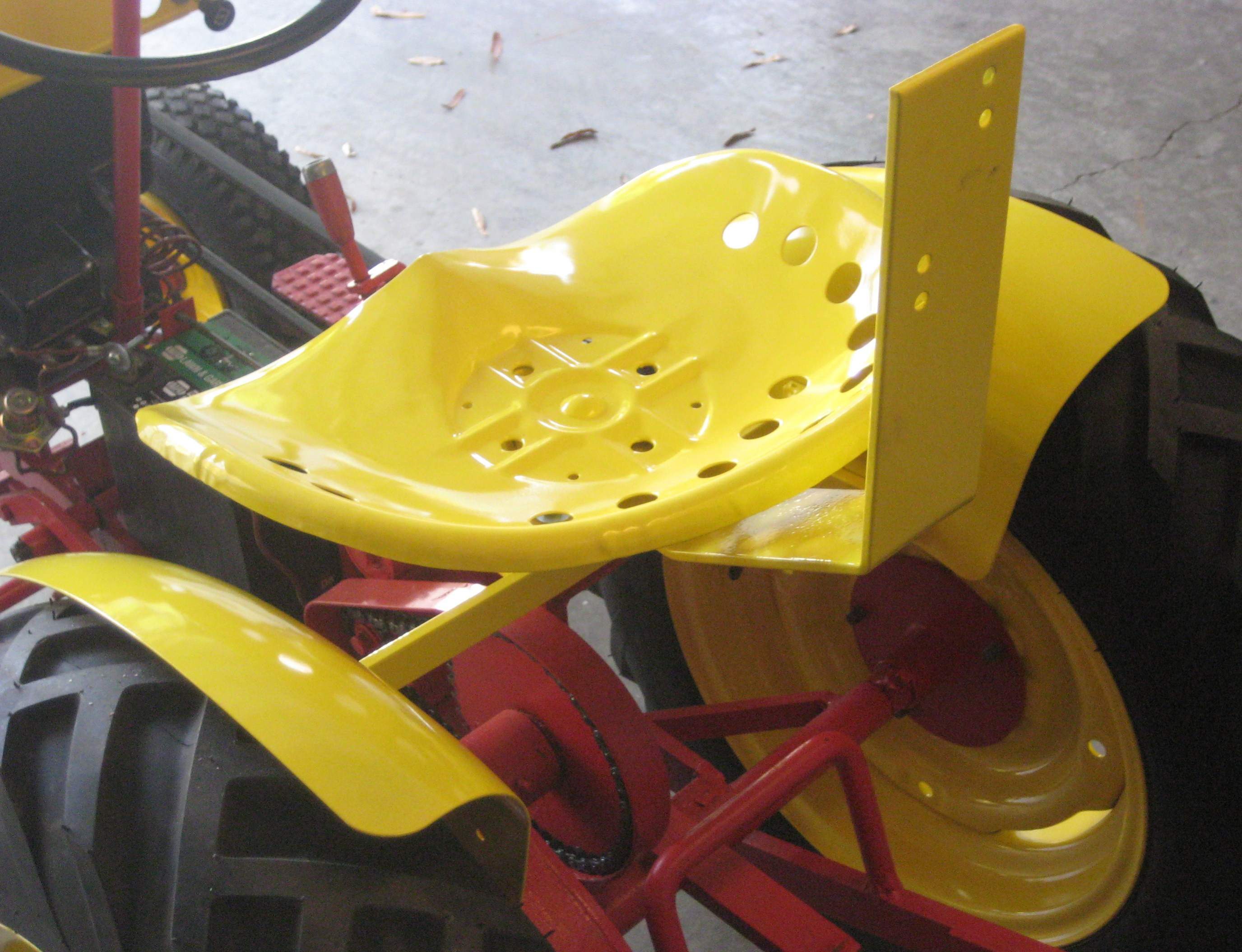

#68
ok I am getting really close to beinge finished. All I have to do is hook up the throttle cable and choke cable going to have to do alittle fab work on the choke cable mount. I made a mistake and left the throttle cable bolts in when I sent the hood out to be powder coated and they got covered and I am going to have to drill them out. Last thing will be put the belt cover on and all new decals on the tractor and motor.

#69
ok the speedex is getting closer to being finished
/ Briggs has no spark. #70
You have a nice looking restoration there. Something of which you should be proud . Good work.
/ Briggs has no spark. #71
Are those the original colors? Never saw one with yellow as you have it.
#72
the rims and the fenders are the orginal J.D. yellow but the hood and seat I thought I would do them in yellow also to give it a different look.
/ Briggs has no spark. #73
Good Mornin Warburtonplayer,
Im with johnk, that is a beautiful restoration, thanks for sharing all the pics with your fellow TBNers ! :)

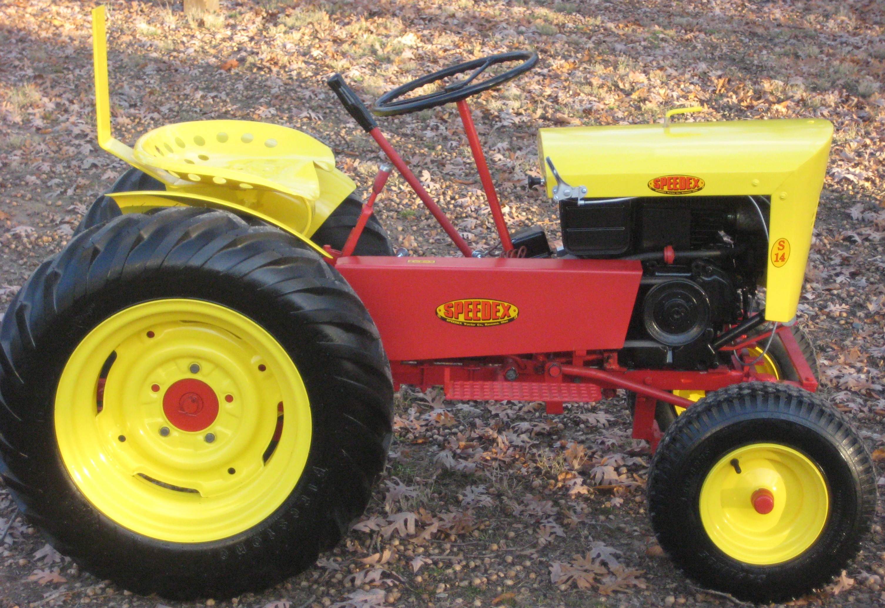

#77
ok got the tractor back togethernow. I got the motor running but I cannot get the idle down to where the motor will not cut off. It will run wide open but then when I pull the throttle down it chokes out. I rebuilt the carb so I know that is good. Here is the deal I can unhook the throttle cable and hold the tractor running by hand and it will stay on. I ordered new springs for the car linkage because I noticed alot of play while the throtle cable was moving., I would have to move the throttle cable about a inch and a half before the linkage would even move and then would just fall down and choke out. Any thoughts on this?
#78
Ok here it is finally FINISHED!!!!!!! All the decals are on all I need to do is put the seat back rest on and it will be done. Let me know what you think.

/ Briggs has no spark. #79
Well that's real purty! Is it a Christmas present for some lucky codger?
Maybe your throttle rod that holds the air plate is loose in its bore in the carb. When you hold it by hand you move it in/out a little and close off the extra air, but the cable lets too much in??? Just guessing.
Anyway nice work, and nice to see the old girl fixed, not scrapped.
Jim
#80
Yeah I checked the orginal manual and I have the spring in the wrong place. It is getting too much air so that is the problem.
