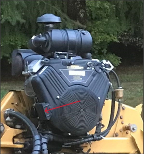

Your post caught my attention since I also have a Vanguard engine in a Vermeer SC362 stump cutter.
It's a 35 hp 993 cc engine with about 800 hours on, and as one would expect it's a pretty tough service in stump grinder!
Question: Does your engine have an oil cooler (see the red arrow)?

No, my Eng doesn't have an oil cooler. Mine is in a Husqvarna lawn Tractor 24hp. Trying to find a way to repair a valve guide that has moved. I was thinking of trying Loctite

The Vanguard isn't the same engine as the OP which is the Intek series. The Intek is more of a 750-1000 hour homeowner engine where the Vanguard is a commercial rated 1500-2000 hour engine.
