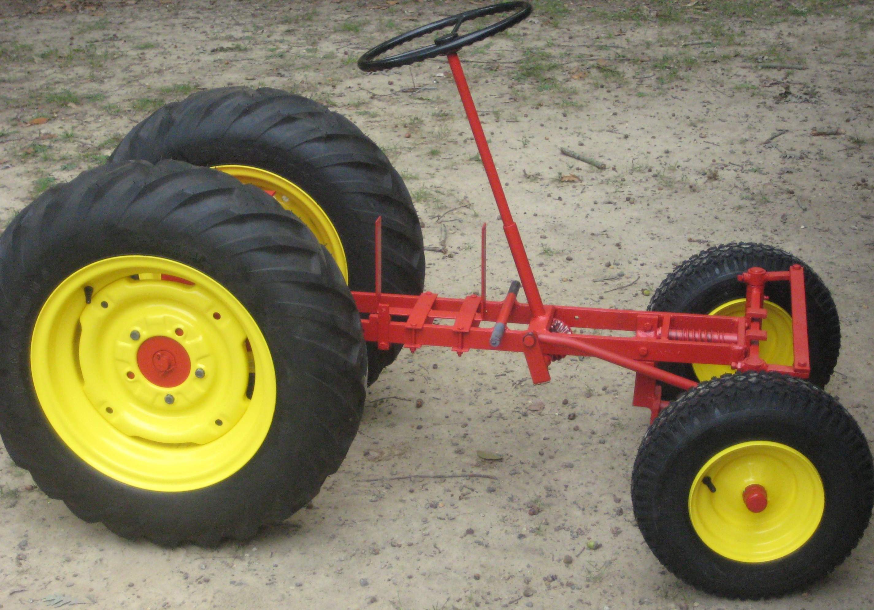

this is for a restoration project. I am tryin to keep it as original as possible. I know norther has engines but this is a restoration. I have all the parts I could run the engine as is but I would like to put the electric start on it. Here is a picture of it minus the engine fenders seat and hood.

Oh dude, that's beautiful.
Ditch that ebarf motor and fix the original.

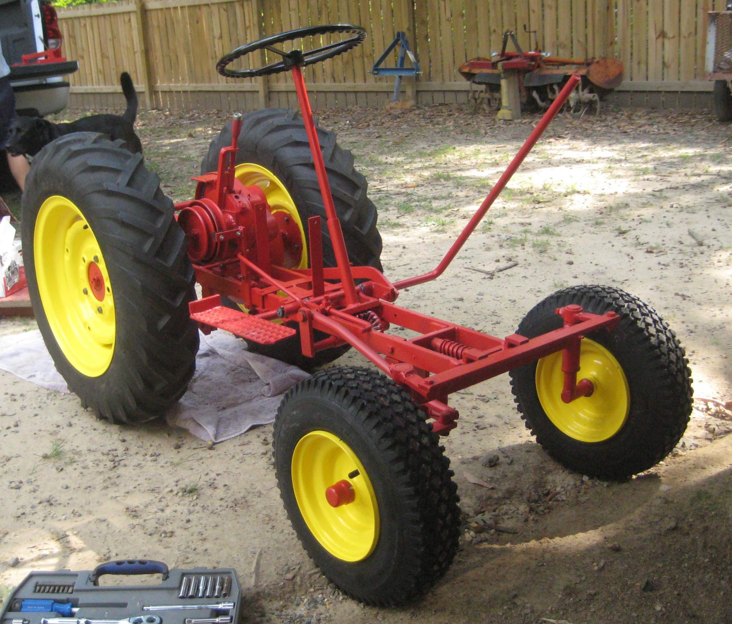

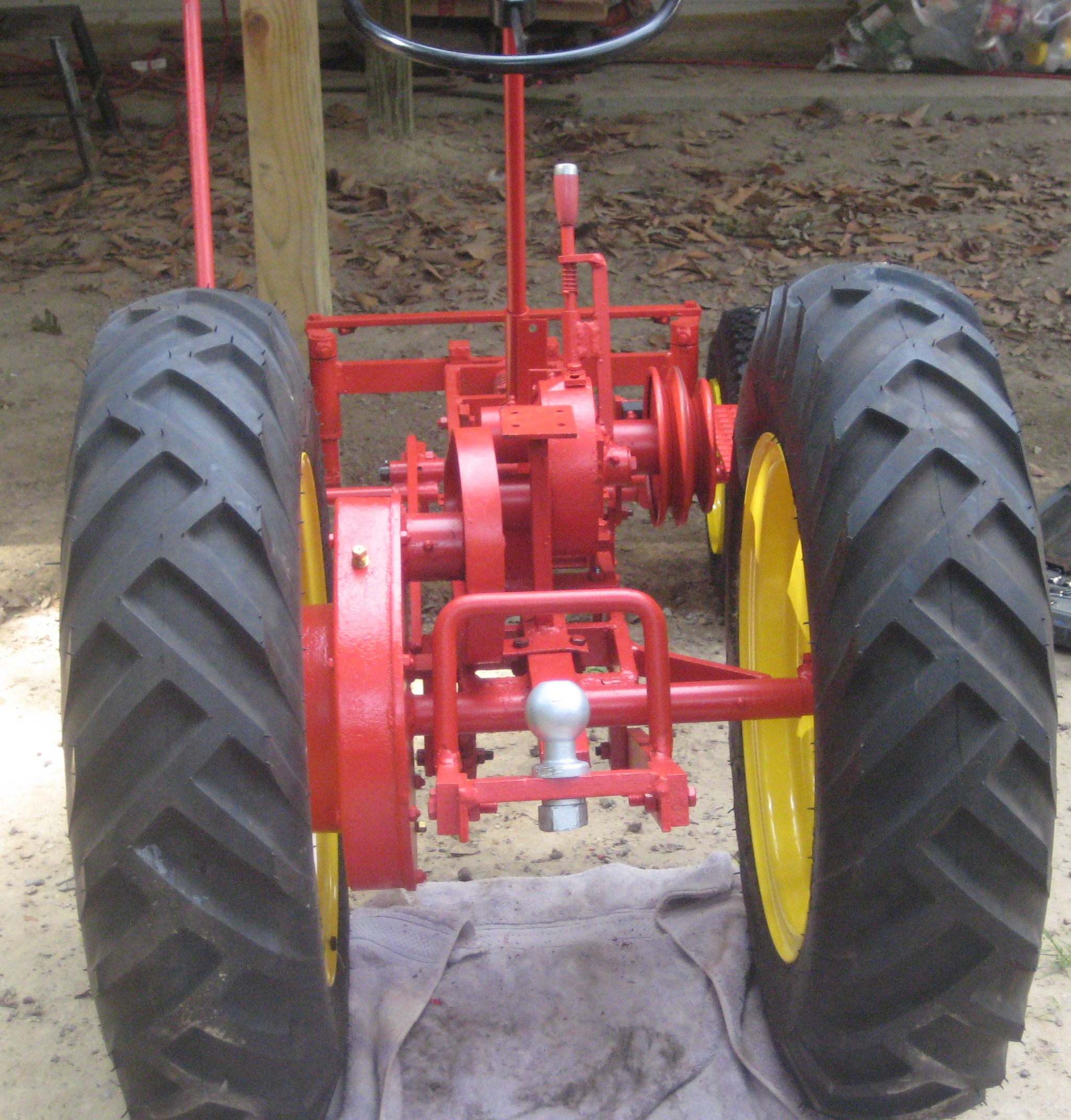

here is one picture the day I pulled it out of the barn this is how it looked before the restoration and one from after
