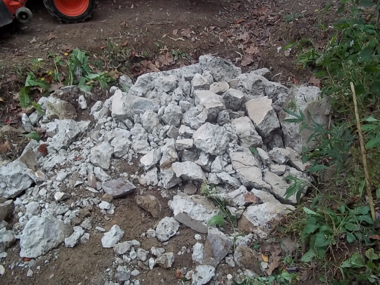

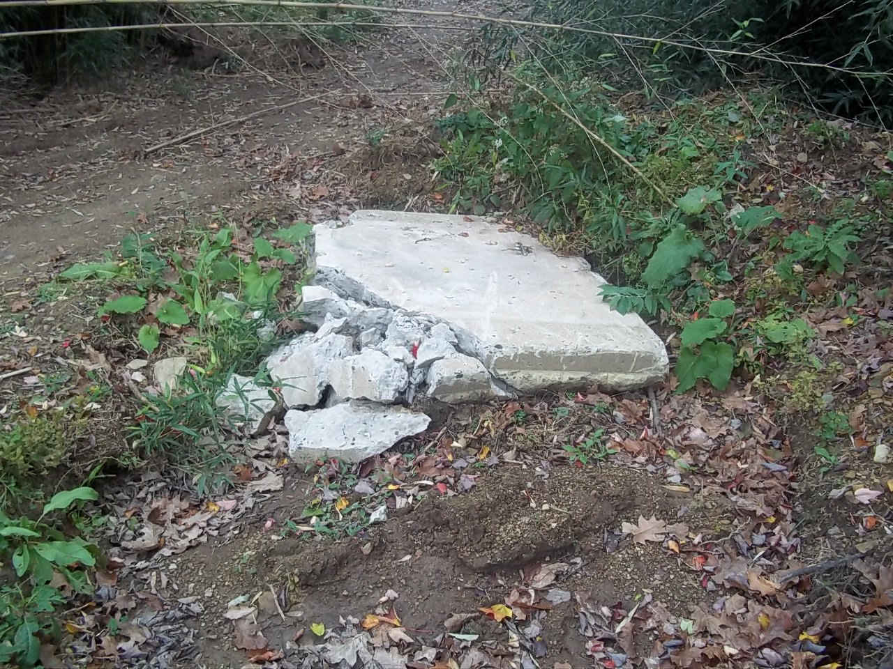

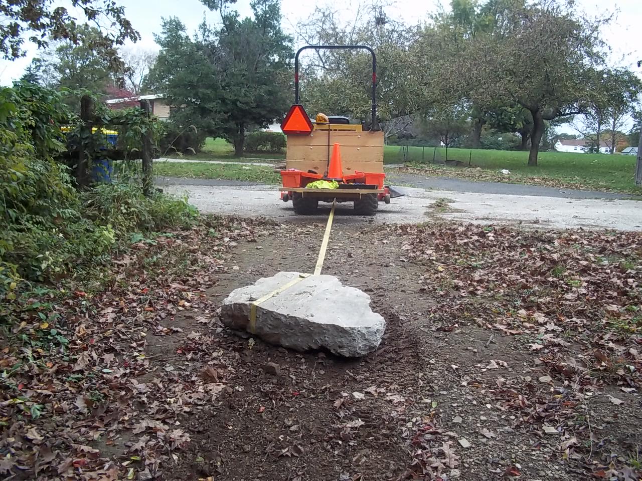

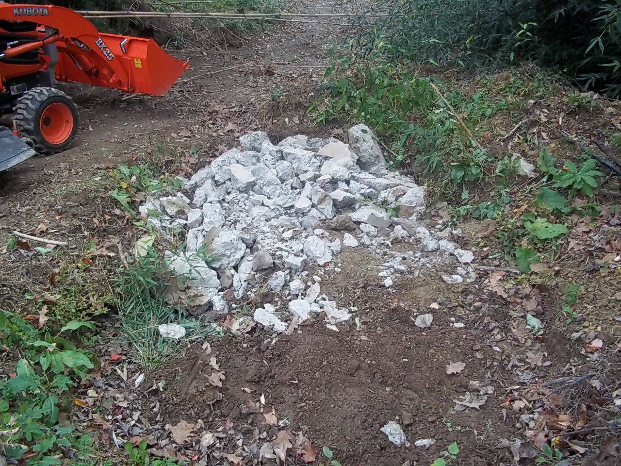

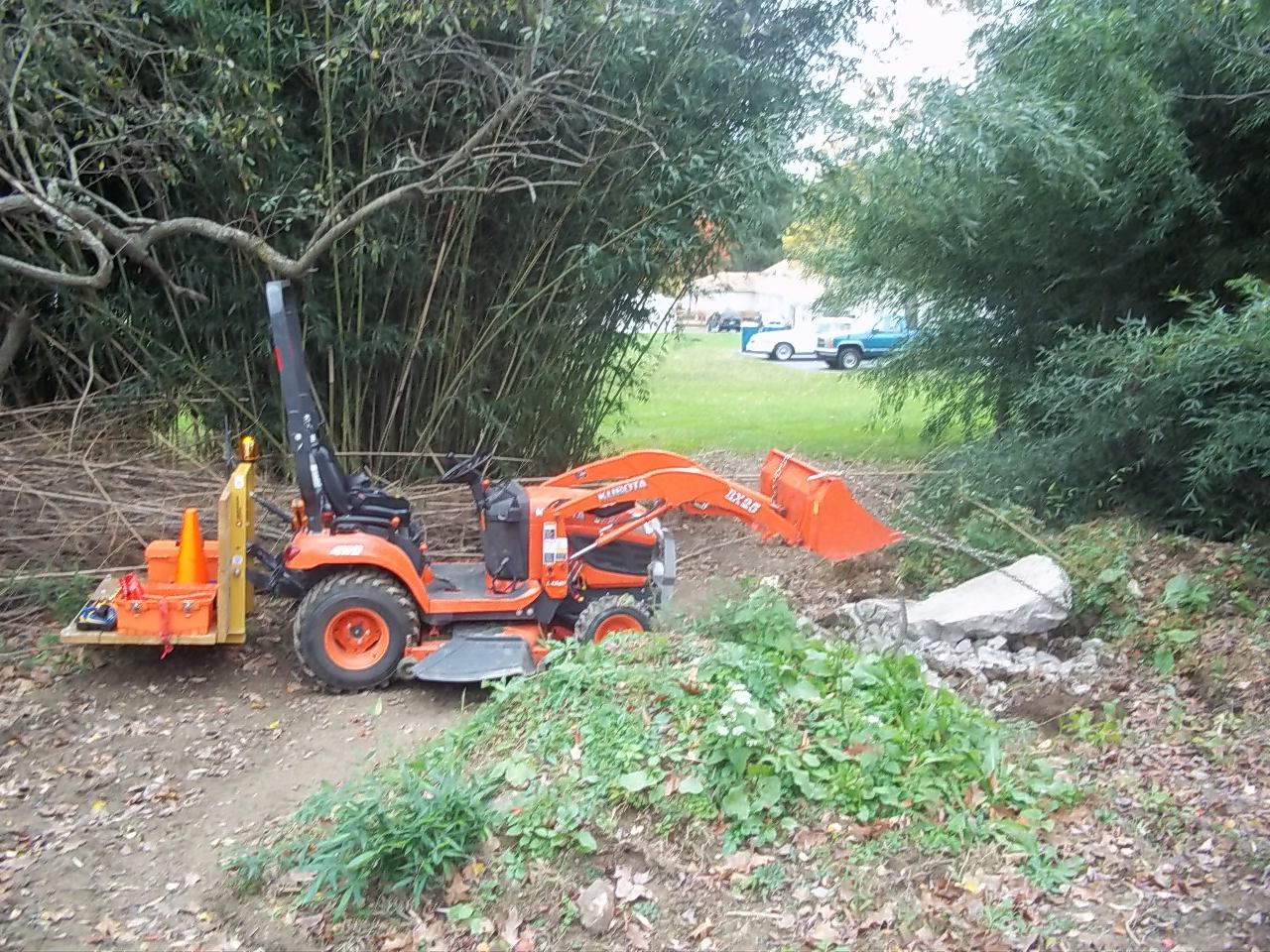

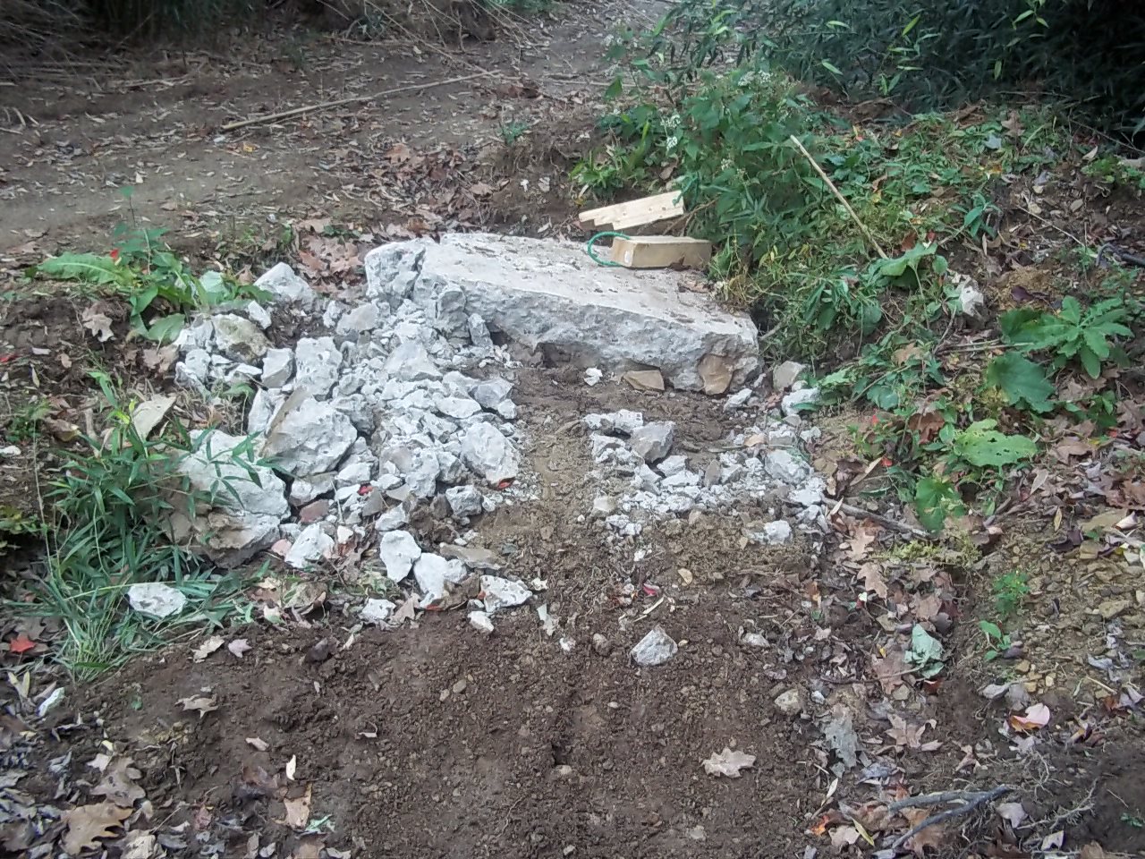

Spent a part of the day today breaking up this big slab of concrete and hauling it off with the BX. Broke it all with my grandfather's 16 pound sledge hammer.

sweet! And looks like the BX25 got it's fair share of fun in on the slab too. :thumbsup::laughing:

Looks about 8 inches, you must of got a good work out. that's about the limit for breaking a concrete slab with a sledge.
I've got a 24 pound sledge, that thing is crazy. you don't really swing it just kinda drop it. Also have a several jack hammers, my first choice :eek:

Yeah, it was thick. It was hard work, but I was actually surprised at how easy it broke. I did not think it would break at all.
24 pounds??? :confused2: I thought the 16 pound one was big. I just did a quick Google search and the biggest I could find was a 20 pound one. My dad want's a 20 pound'er...Easy for him to say, I was the one swinging the 16 pound'er all day. :D :laughing: ;)

I know it's too late to give advise now but maybe it will help in the future or for someone else. When you have to break up concrete and the only option available is the good old sledge (or even when using a jack hammer); if at all possible, raise the concrete off the ground at one corner and work at that till you reach the point where it is against the ground then raise some more of it. Having the concrete directly on the ground doesn't allow much give when impacting with the hammer so you have to work harder to bust it up. I know it's not always possible to get the slab off the ground but if you can it will go much easier.

My grandfather sugessted I jack it up with a car jack, but it was breaking OK and the ground was really soft, so I did not bother.
