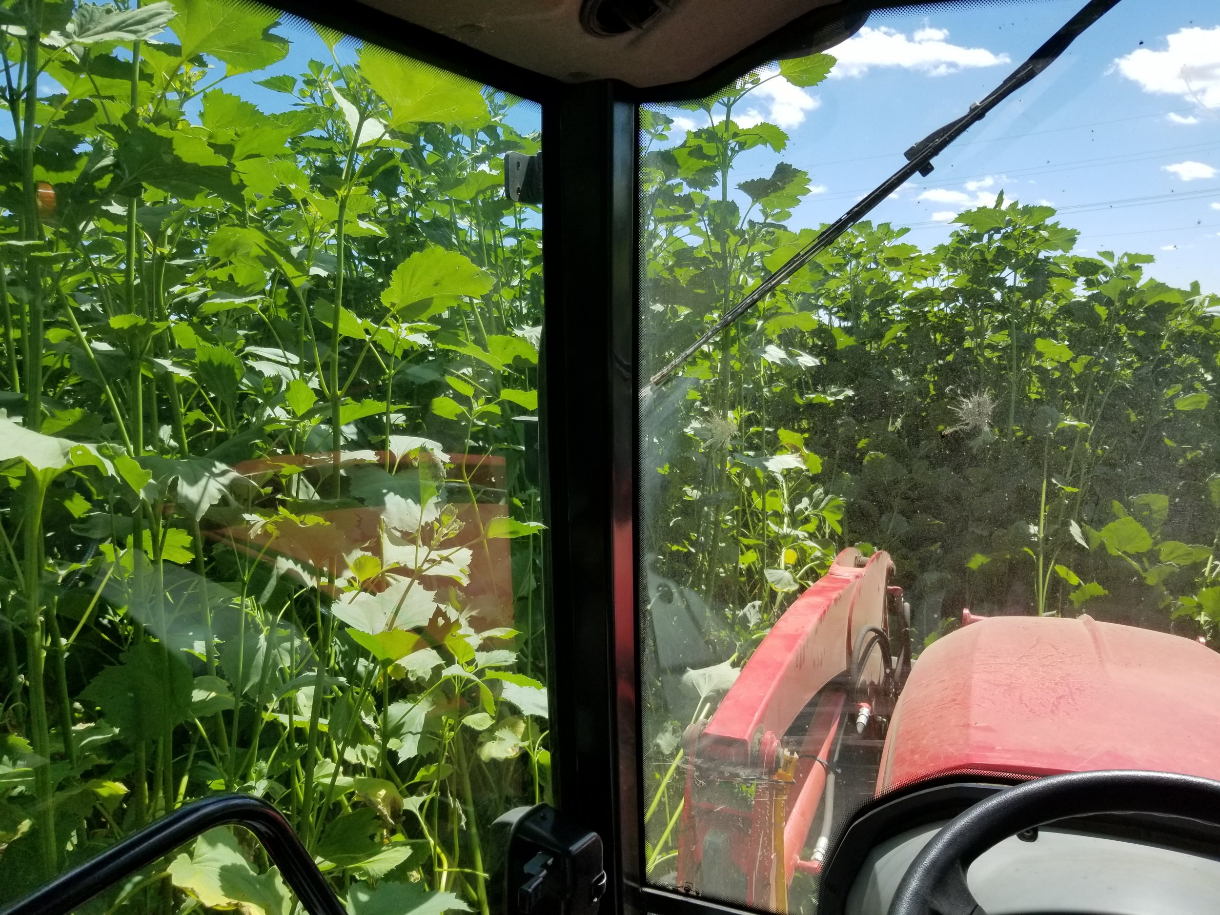

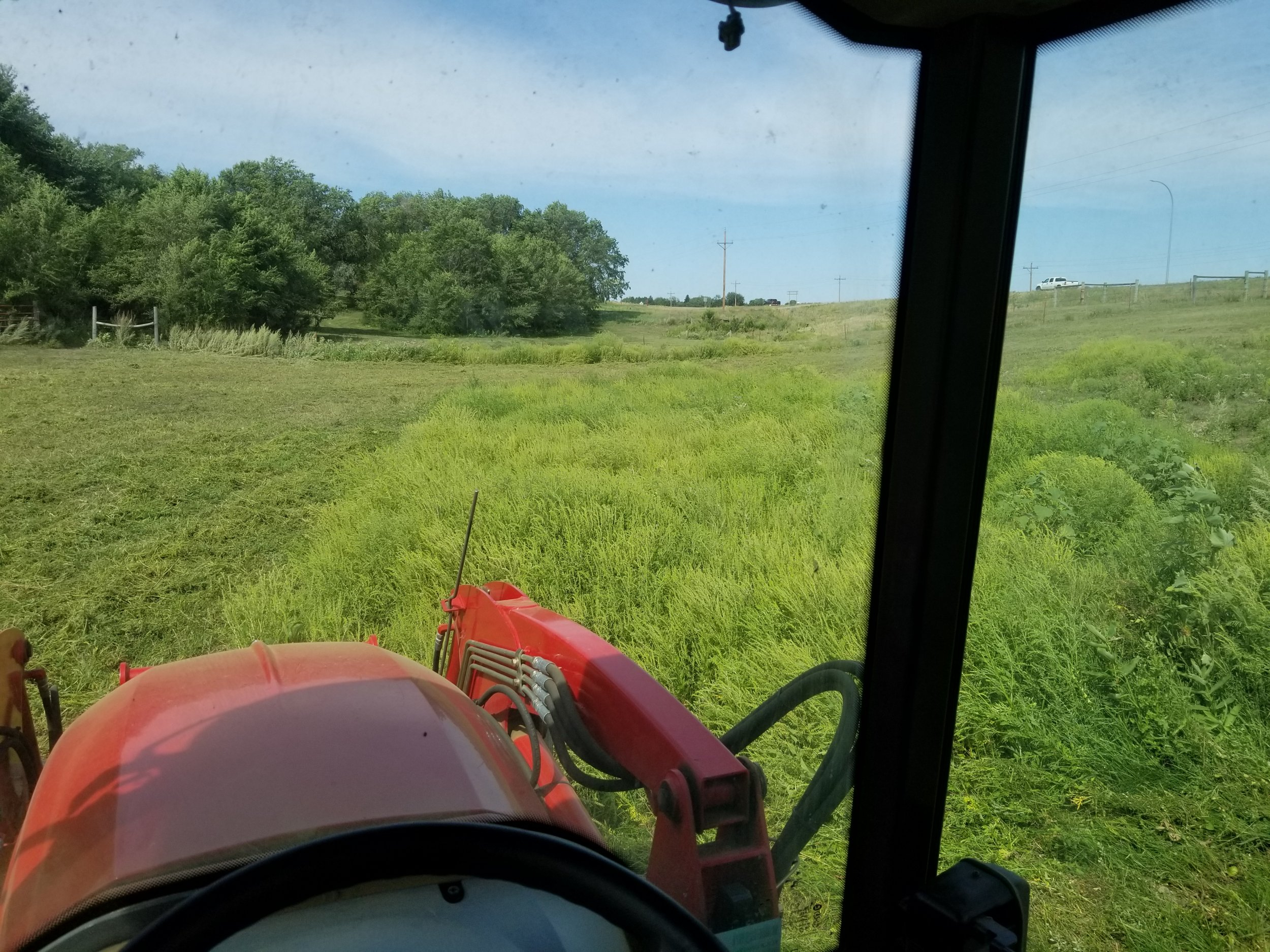

For my own uses, I only use the 540E setting when I'm mowing light brush and grass, like this one:
For heavy and thick mowing, I'm only using the "standard setting" 540:
This wasn't just 8 feet tall, it was also very thick growth, I couldn't see the ground, or even 1 foot in front of the bucket. You can't use the "E" setting here.
This was all done with a 6 foot cutter on 32 PTO hp.
Normally I'm burning less than 1 gallon per hour (37 engine hp), but for the *very* heavy stuff, it does go up to almost 2 gallons per hour.
