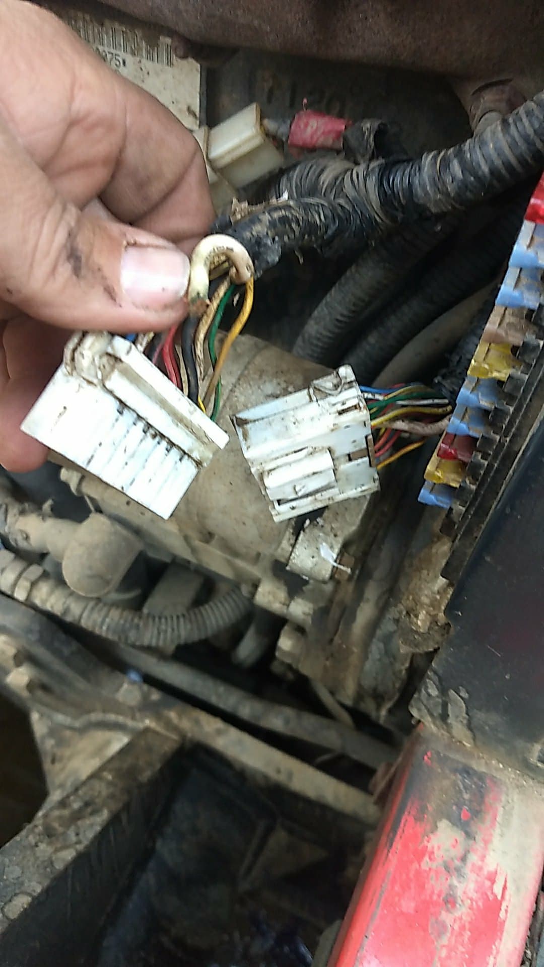

I have a 3510i. Bought it new almost 11 yrs ago. It's been my self employment ever since. This is the third time it's stopped on me. Very frustrating the first time.. So now I know to open the hood and remove the left engine cover and wiggle this plug. Well now it's not even making connection. I have replaced the factory fuel pump with an electric one.. so if the culprit wire makes a connection, I hear it. Well.. Without have the wiring schematic.. I'm guessing this large white wire is the problem. I don't know how to remove the metal plug\spade from the main plug so I can solder it and hope it fixes the intermittent issue.

I'm not sure how those spades clip into the plastic connector. Generally if you have good eyes and good light and clean up the connector you can find a tab that is down inside the connector that is attached to the metal wire end connector. Technically they make special tools to depress the "hidden" tab and the wire slides right out. But without that tool, you can sometimes use a paper clip to release the tab. I know that isn't much help, you probably know all of that already.
You could do a temporary fix to make sure that your white wire is the issue. Jump a wire around the connector. If that works, you can mess with the connector or just bypass it for that one wire.
/ Branson 3510i suddenly stops. #3
If that does not solve your issue, you might clarify the problem and you will get suggestions on possible other things to look at. If it stops suddenly, I'd suspect the fuel shutoff is not allowing fuel into the pump. If it stops more slowly, as if you are running low and almost out of fuel, it could be the fuel lift pump....and so forth.

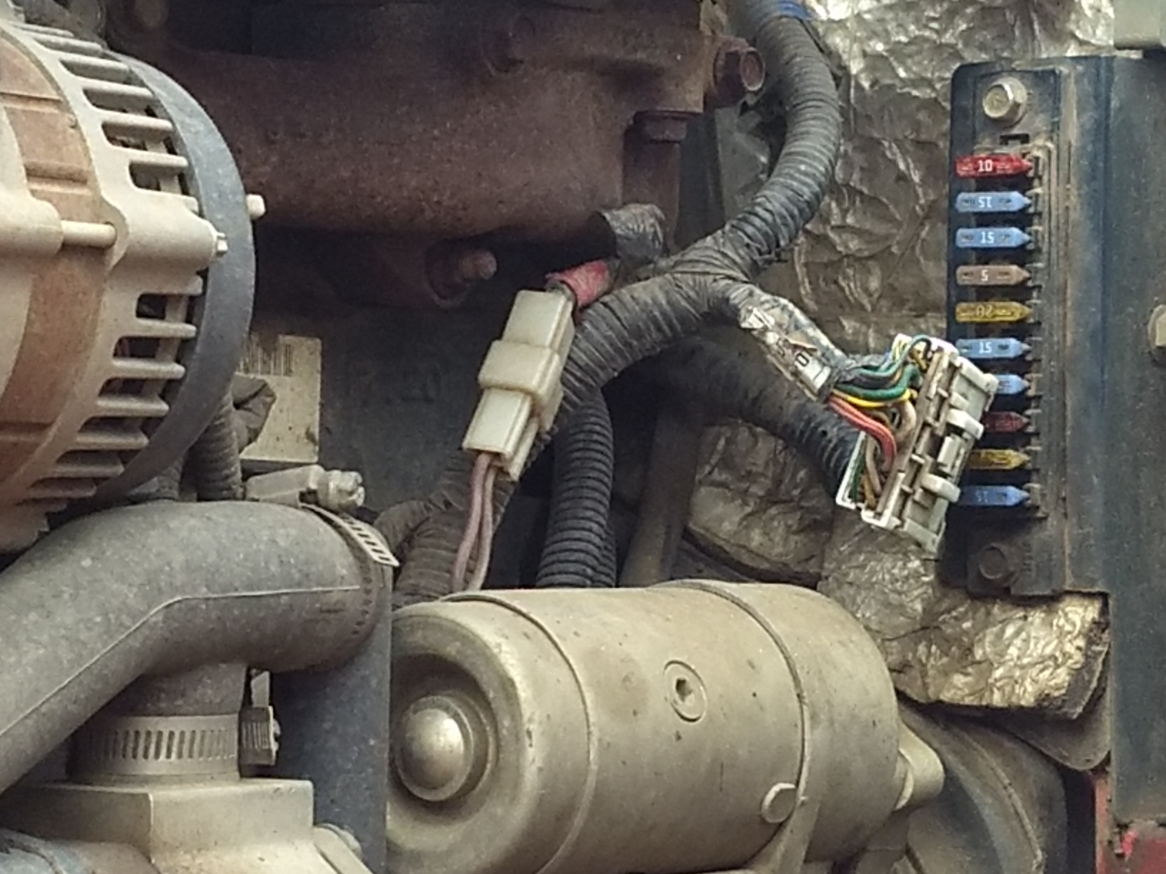

Hey there.. I was living in Sacramento and came up to Dave's tractor and bought a new auger with the downforce kit. I haven't been real happy with it.. It pushes so hard it wears out the soft metal cutting teeth adfter a dozen holes. I need a real nice ROCK BIT for it.

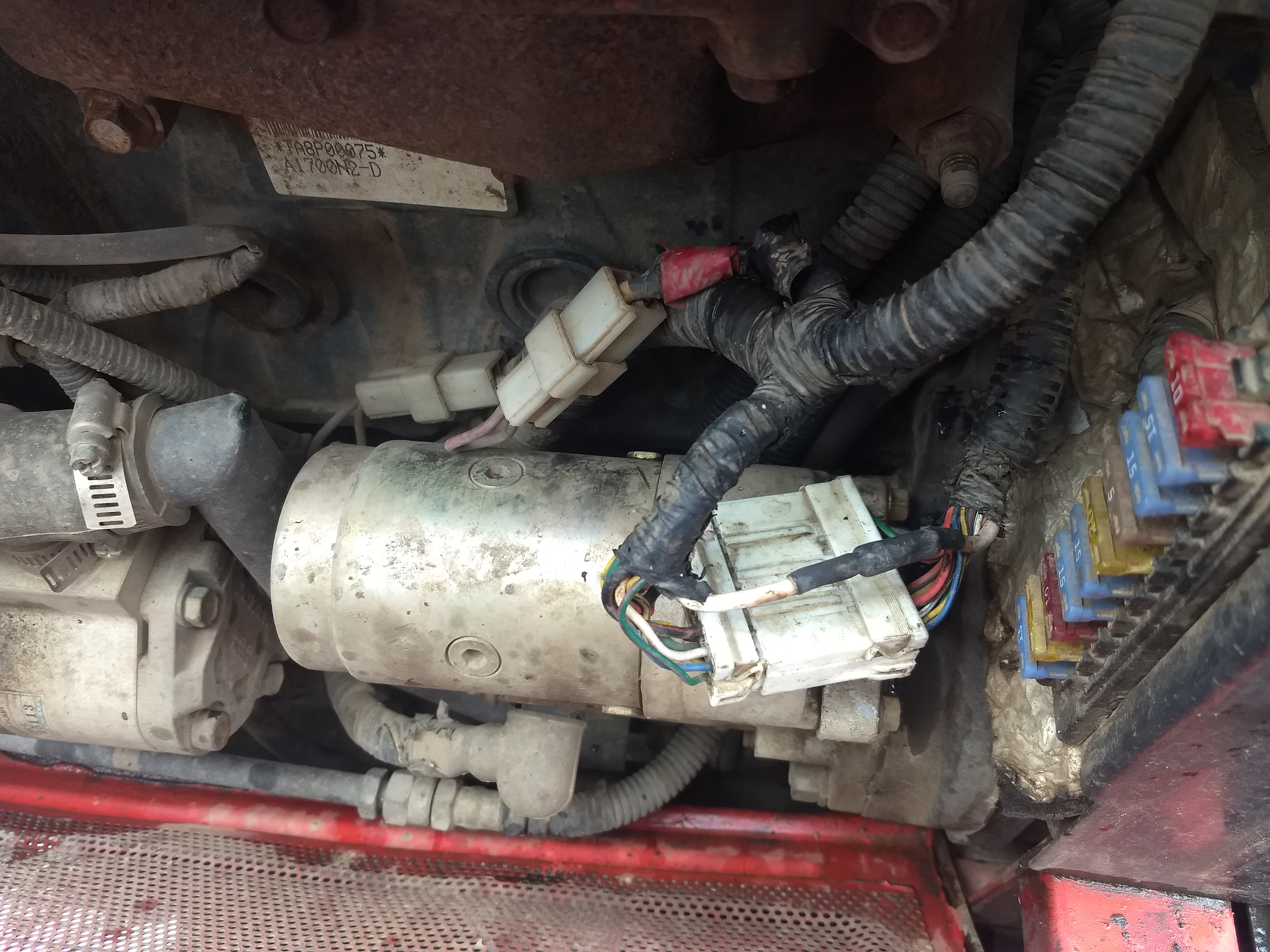

So.. back to the main subject.. I went to an auto repair shop this morning and showed them the problem. He pulled both sides of the white wire and put a bullet connector on it. A 5 minute fix. Thanx for the reply "Dave". Speaking of Branson.. I was passing through Grants PAss today and saw that someone is selling Branson's there.

Problem is fixed.. and speaking of fuel. My fuel gauge has been way off for a couple of years. Is the sensor easy to replace on it..? Which tank is it hiding in..?

So, what was the problem - the white wire? If so I'd wrap the entire connector with some landscape fabric or hydraulic hose connector material and then cable tie on either side to keep dust/dirt out - AFTER cleaning the entire connector with 'Letra cleaner or similar and blowing out all the crap that's already in it with compressed air.
The fuel sender is hiding in the tank with the wires on top, most likely?!:thumbsup:

Yep.. a bullet connector was installed to keep them together. Then it was heat shrink wrapped and sealed.
It's a permanent fix to a temporary solution.

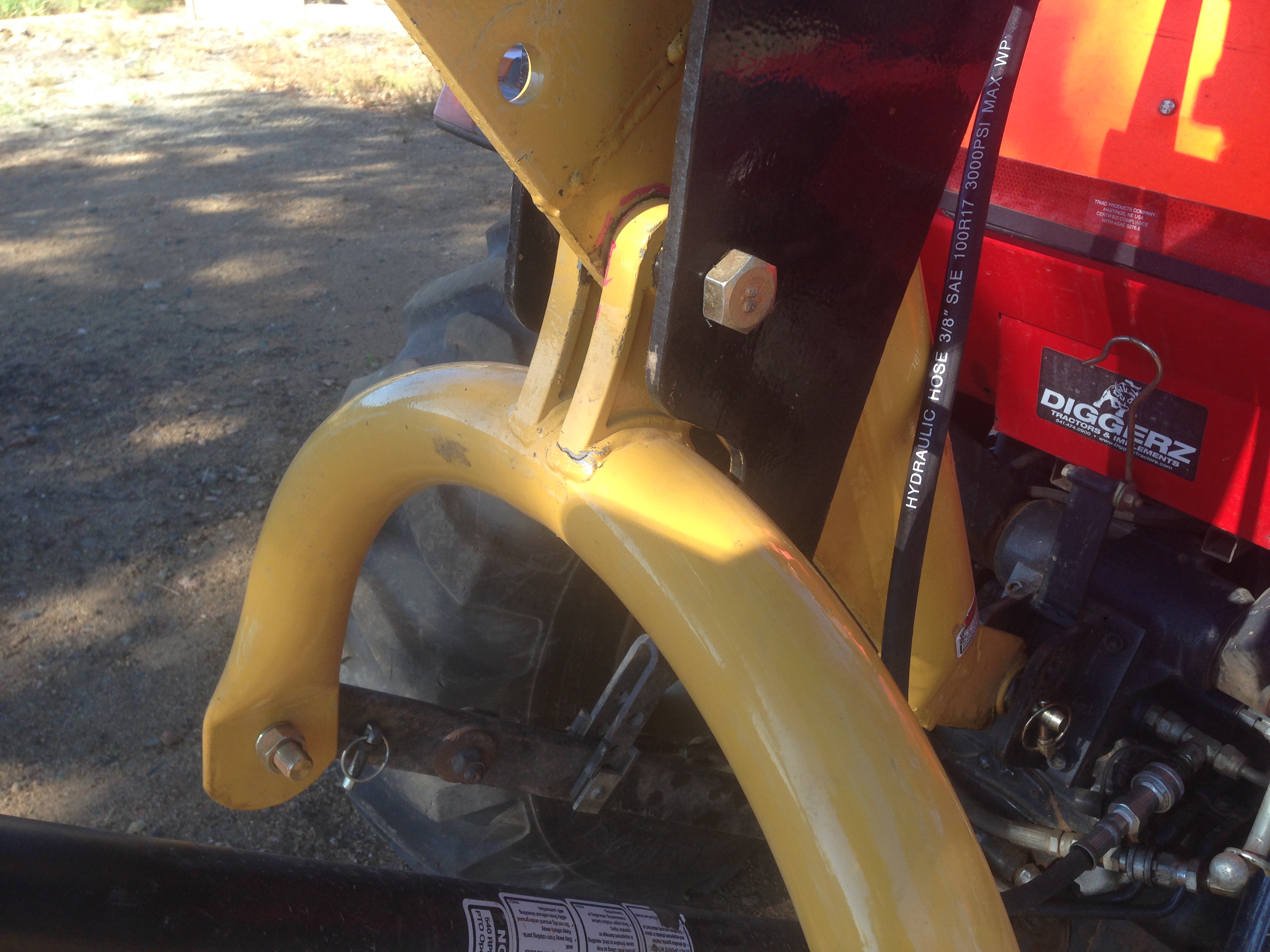

LOL.. funny guy. I have tried to adjust it, but a gauge is the only way to know for sure. Auger holding up well.. Hmm..1st picture is inside your shop. 1st job I did with it, it cracked. It wasn't worth a 3 hr drive up and to get it welded or replaced and then 3 hrs back.
So it's doing ok since..

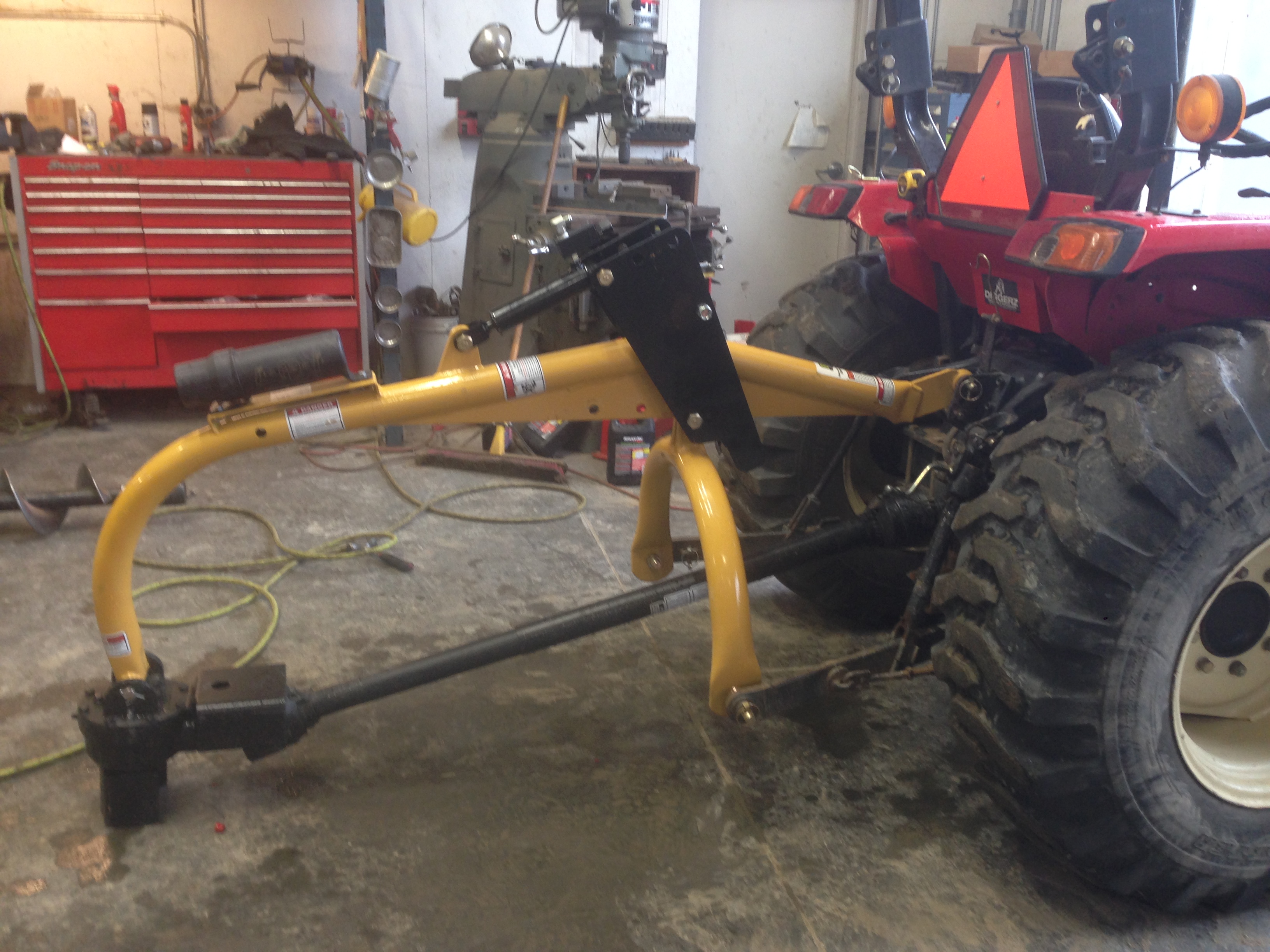

What does that black thing on top of your auger do (with what looks like a hydraulic cylinder on it)?

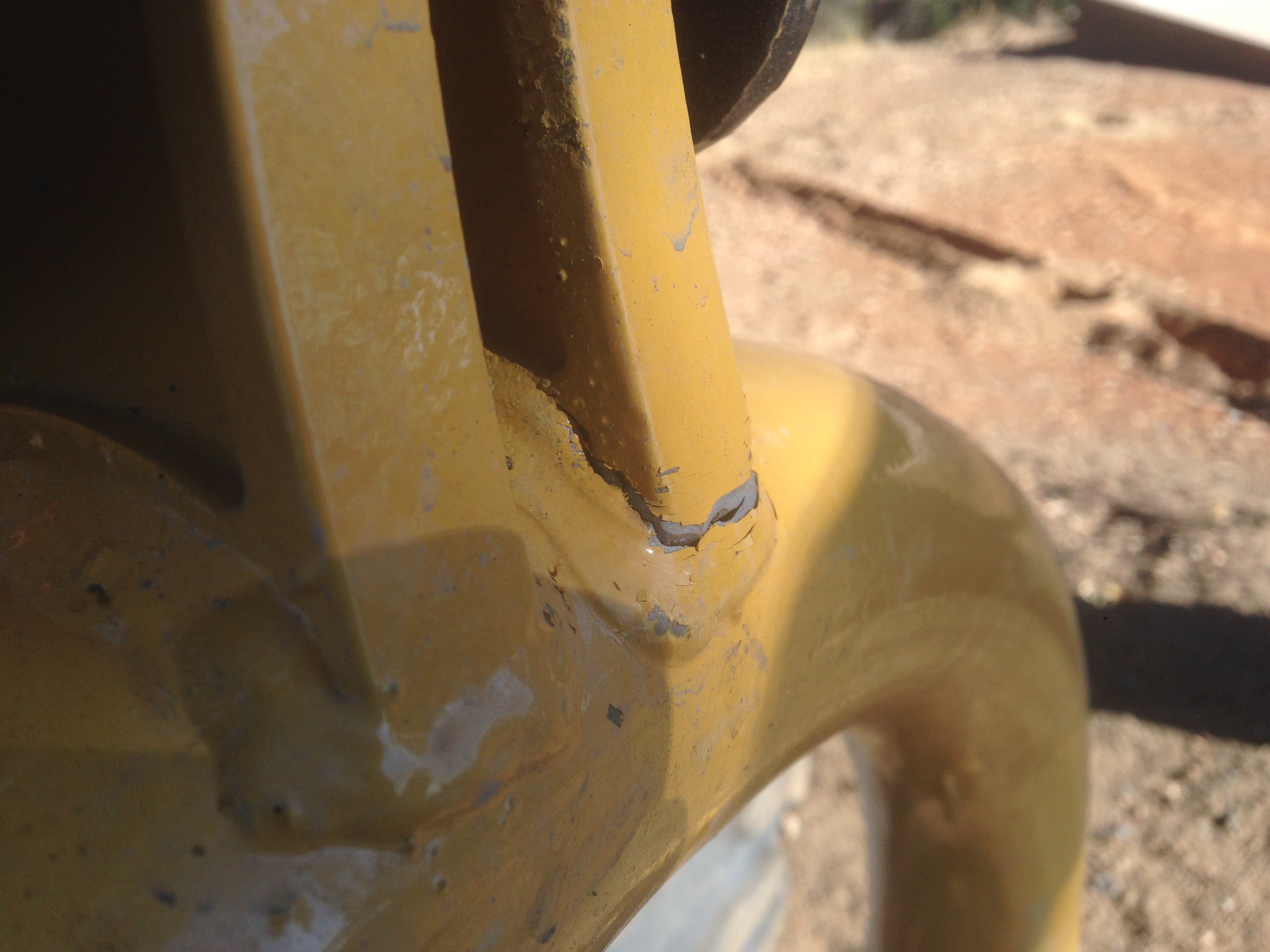

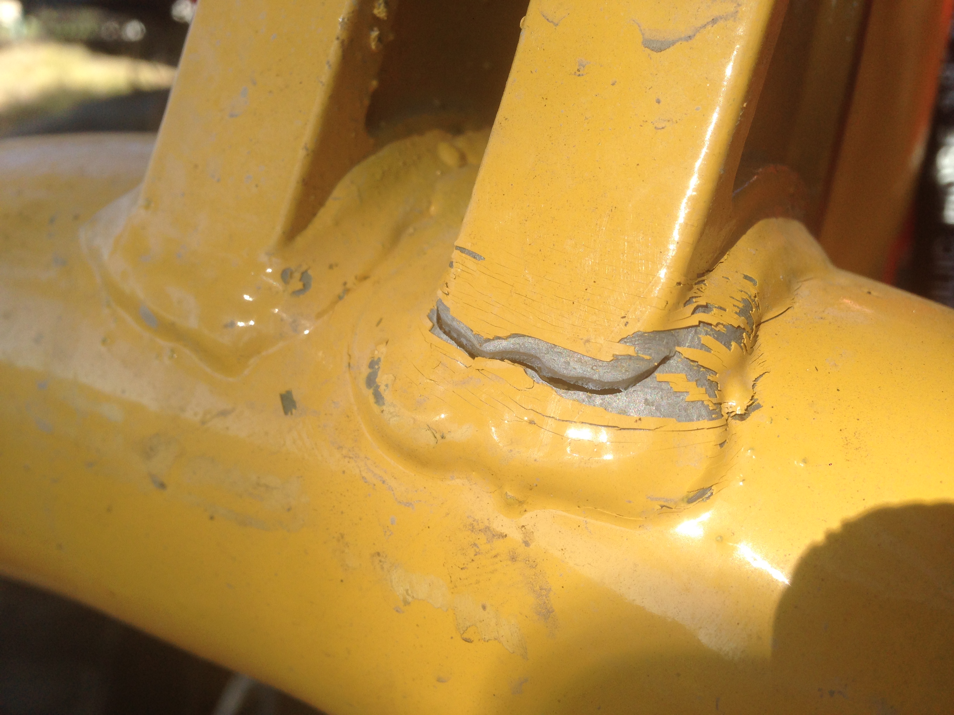

That's a shame that factory weld came loose. I agree it would not be worth driving 6 hours to have a half hour of welding done. The down force kit does apply quite a bit of force. But you don't have to use all the force all the time. You just need enough push to keep the bit doing it's job. But you know that. That weld should not have done that in any event. I'm sorry you have had this problem.
/ Branson 3510i suddenly stops. #14
Issues happen welds break , part of life sounds to me like Dave does best he can with customer service , I wish he was my dealer
It's a hydraulic cylinder. It's for putting up to 800 lbs of downforce on the auger tip.. Bought it from Dave's Tractor.

Ok. Never seen that before. Sounds like a neat feature. Sure explains why you wear out auger tips while mine have lasted for for years and years, even going through some fairly rocky ground. But I'll bet you can drill a post hole a lot quicker than I can in rocky ground. Getting that frame re-welded should be pretty easy to do.
