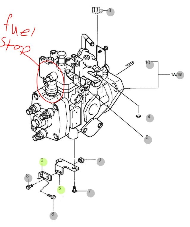

I was using my 3510i about 2 hrs ago, and it suddenly quit, like I had turned the switch off. Now it will turn over, but won’t run. I replaced the fuel filter (it was time anyway), bled the air out, and it still won’t run. I also cracked two different injector lines to see if there was an air lock - still nothing. A very small amount of air came out of the first injector, nothing from the other, and no fuel either. The fuel pump is working. Will any of the safety switches still allow it to turn over but not crank? Or will the injector pump very suddenly stop pumping?
/ Branson 3510i suddenly cut off. #2
this sounds like the fuel stop solenoid on the fuel injection pump, when you energize the key it retracts a stopper pin that when not powered blocks the flow of fuel through the fuel injectors, if this has failed it will not allow fuel through the fuel injectors and into the engine. creating your issue of turn over but not starting

Thanks so much for your response. That fits the symptoms perfectly! Unfortunately, I had to leave my tractor about 2 1/2 hrs away and won’t be able to check the solenoid for a couple of weeks. I’ll let you know if that’s the problem.

I can’t test it if I can’t get it out. I’ve moved everything I can move but still can’t get a wrench on it. There is a piece directly above the solenoid that is in the way, but has a do not tamper type of cover over it. I’m reluctant to rip the cover off and remove the piece to gain better access (socket from the top) because I don’t know what it is or does. Asteral, it’s inside the circle on the diagram you sent. Any ideas what it is? And is there anything I need to know about the removal of the stop solenoid?

There is a link to the service manual for your tractor at the bottom of this post. There is a small section for the solenoid but some good information about the pump in the engine section.
The part you are asking about is the fuel adjustment and you do not want to mess with that. The solenoid should have enough clearance to slip out best I can tell. You will need an open end wrench to remove it. A socket will not work.
There is some test you can do without removing the solenoid but the likely symptom would be tractor starts but will not shut off with the key switch. In this case the thought would be the plunger failed to retract after power is removed from the coil.
Be careful removing anything else from the pump. Many of these thing require special care and calibration to get back correctly.

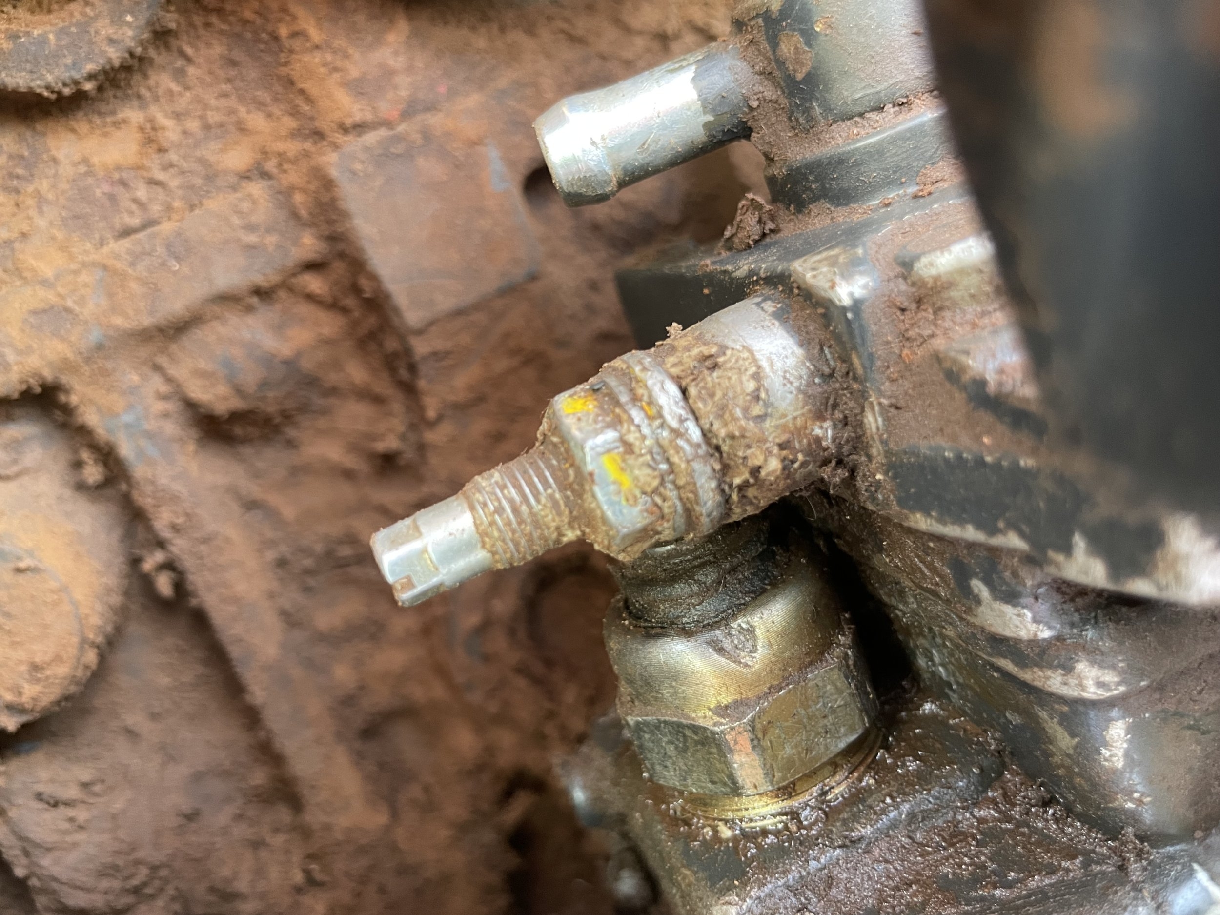

It happened again and unfortunately I didn’t check fuse first, and it was fuse, but I needed to replace old brittle wire, I have a good solenoid.this is easier to remove 1/4” nut , I set up two mirrors so I could see nut ,now in progress of removing nut and wire, hope this works.

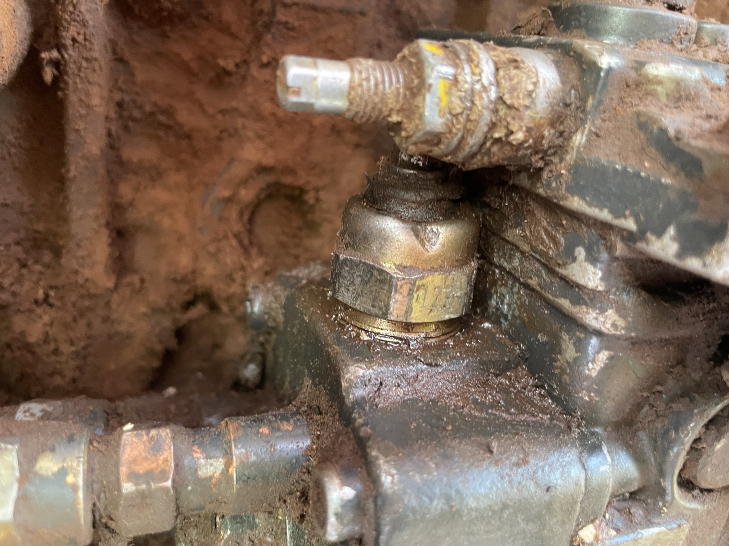

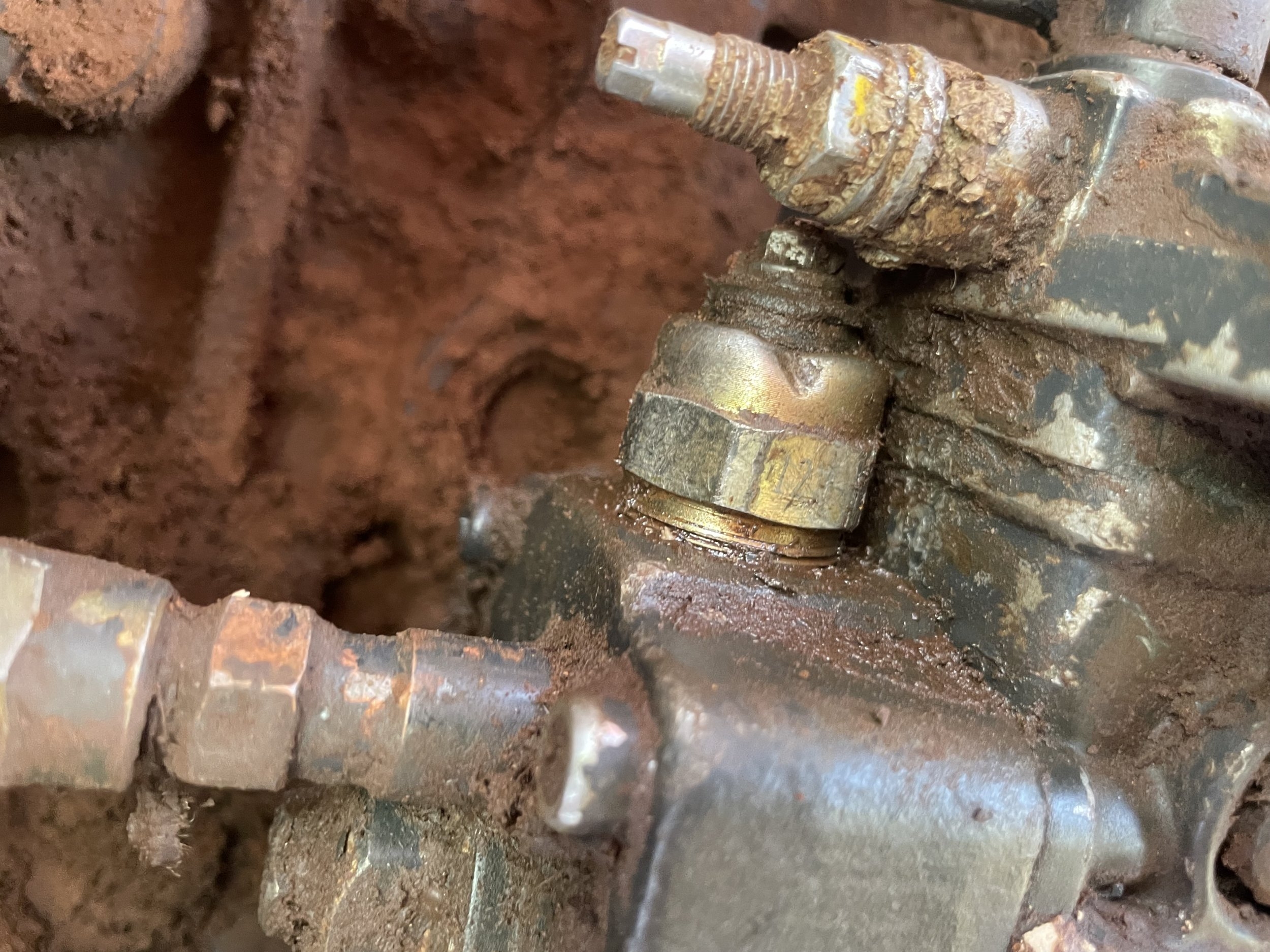

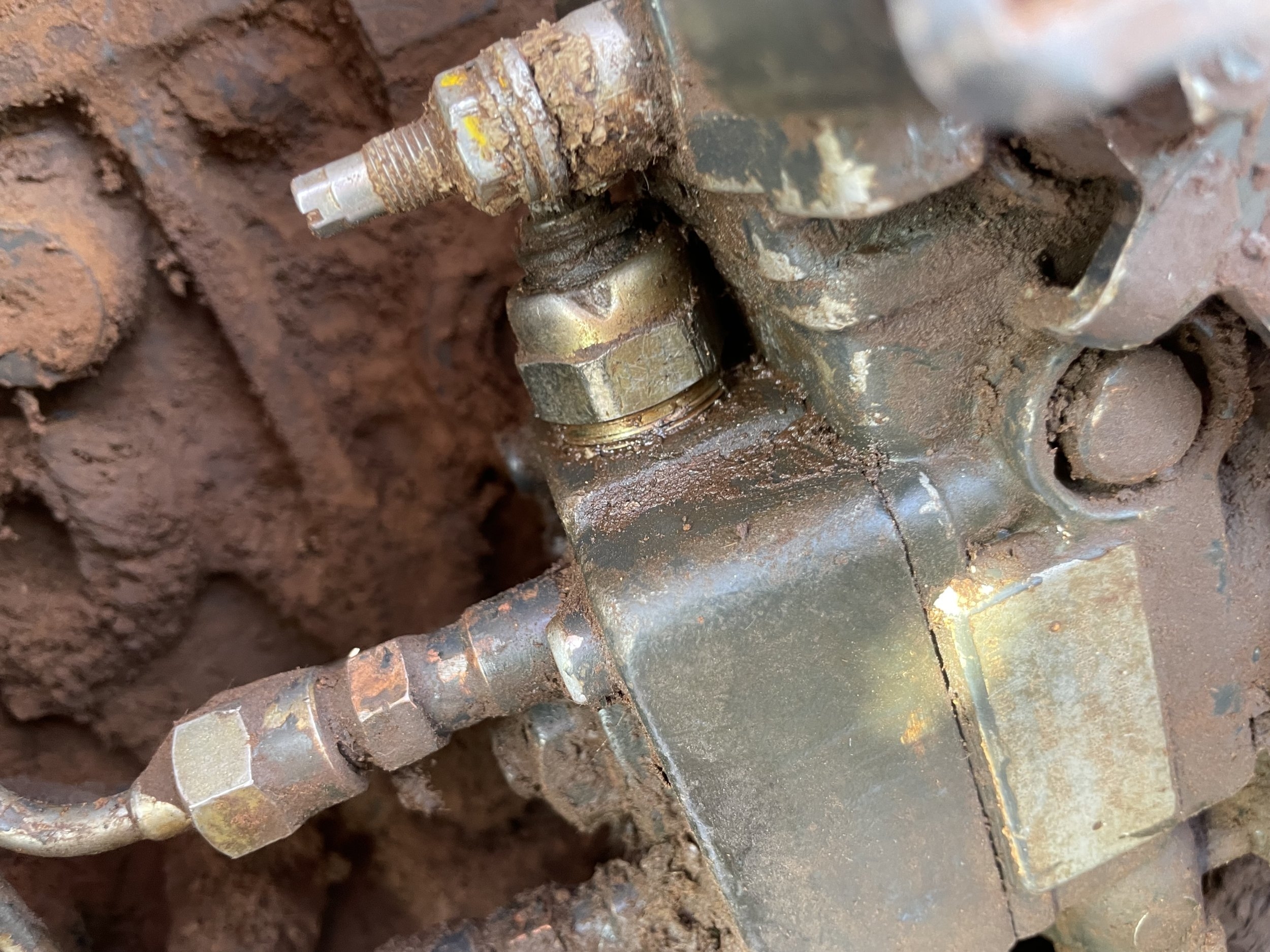

Just an idea remove fuel filter assembly then remove the do not remove part (that's the adjuster but it can be removed with wrench) you should now be able to get thin wrench on fuel shut-off solenoid, another little advice do you see connecting to throttle DO NOT REMOVE, i made that mistake, you mess up Bosch Ve fuel pump, my brother finally got it right. When you remove any of these parts watch for springs, small nuts,washers, o-rings. Now you can test fuel solenoid. You will need 12 v from battery, put clip on positive side of battery and probe on top where wire goes, you should here a click from solenoid if it is working. the solenoid operates using magnets. I also learned from first to buy a set of thin wrenches, the first time I ground down regular wrenches, for 20 on Amazon.

Here are pictures of location of fuel shut off solenoid. It is directly under adjustment valve, you will need to remove adjustment valve before you can remove fuel shut off solenoid valve.this is same as yours,mine is 2910i. Maybe this helps
