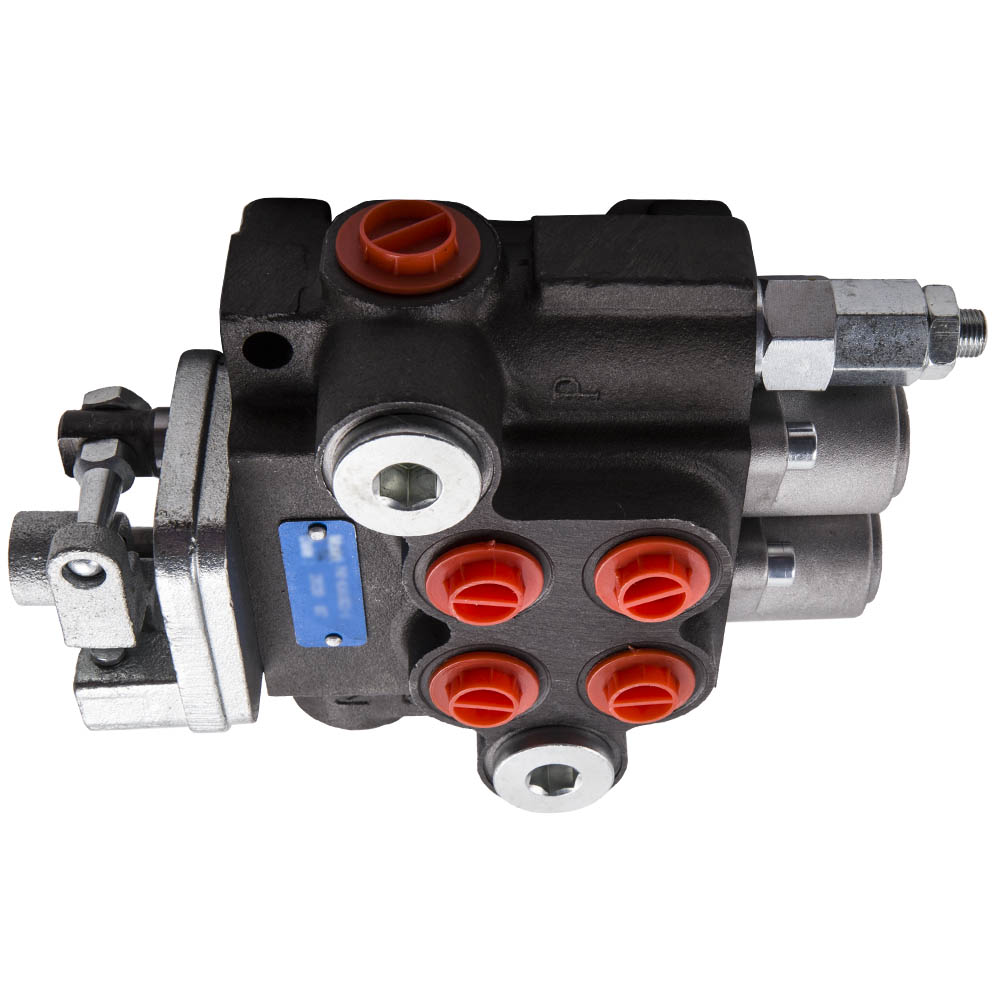

ericm979, My tractor does have what looks a adjustable relief valve similar to the pic you attached.
I think I need to come up with a pressure gauge to find out what pressure I’m operating at.
I have never adjusted that valve, if the pressure were on the high side, I wonder if it could have caused my failure over time?
Will the relief valve protect the whole hydraulic system?
If I didn’t have a front end loader, is there no other relief valve on my Branson?
