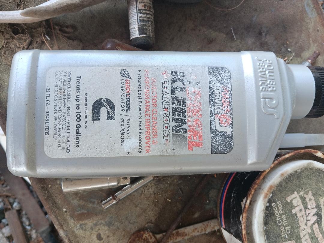

I changed fuel filter and added this.
Runs good less white smoke if any.
