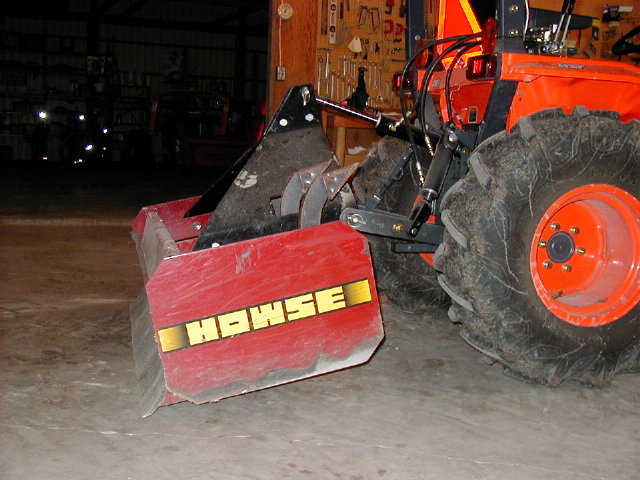

Harv, I needed to take the FEL and box blade off this morning, so I snapped a couple of pictures of that dirty sucker first. With the blade tilted all the way forward, it rests on the sides and even the front blade is 2.25" off the surface.
Bird

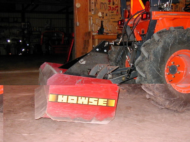

And I have no idea what I did to screw up that picture, but here's one with the blade tilted all the way back and that leaves the front blade 2" off the surface.
Bird

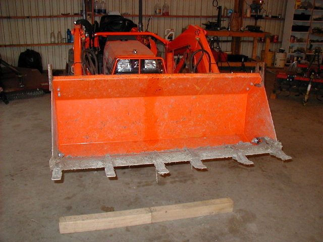

So while I was at it, I snapped one of the tooth bar on the FEL.
Bird

A question for you Bird...
When you've got the box tilted all the way forward does it actually ride on the side plates, or do they dig in and let the cutting edge get a bite?
   / Box scraper basics #49
<font color=blue>I have no idea what I did to screw up that picture</font color=blue>
That's an odd one, all right. Did it look that way on your computer before you uploaded it?
Good shots, though. It never occurred to me that the sides would bottom out if you tilted too far forward. I guess that supports the "small adjustments are best" theory. I think the back-tilt picture demonstrates pretty clearly that an extended top link is what you want for smoothing operations, especially if the front blade is clear off the ground as you say.
And the tooth bar -- man, I didn't really think I was interested in one, but the more you guys talk and show pictures, the more I think it would help me in my up-coming projects. Digging out my "muddy road" stretch when it dries out, for example.

Rob, they dig in and just cut a little narrow trench, unless of course, you're on a really hard surface. And you can tilt it back a bit to lift the sides of the box off the ground and still be cutting with the front blade.
Bird
