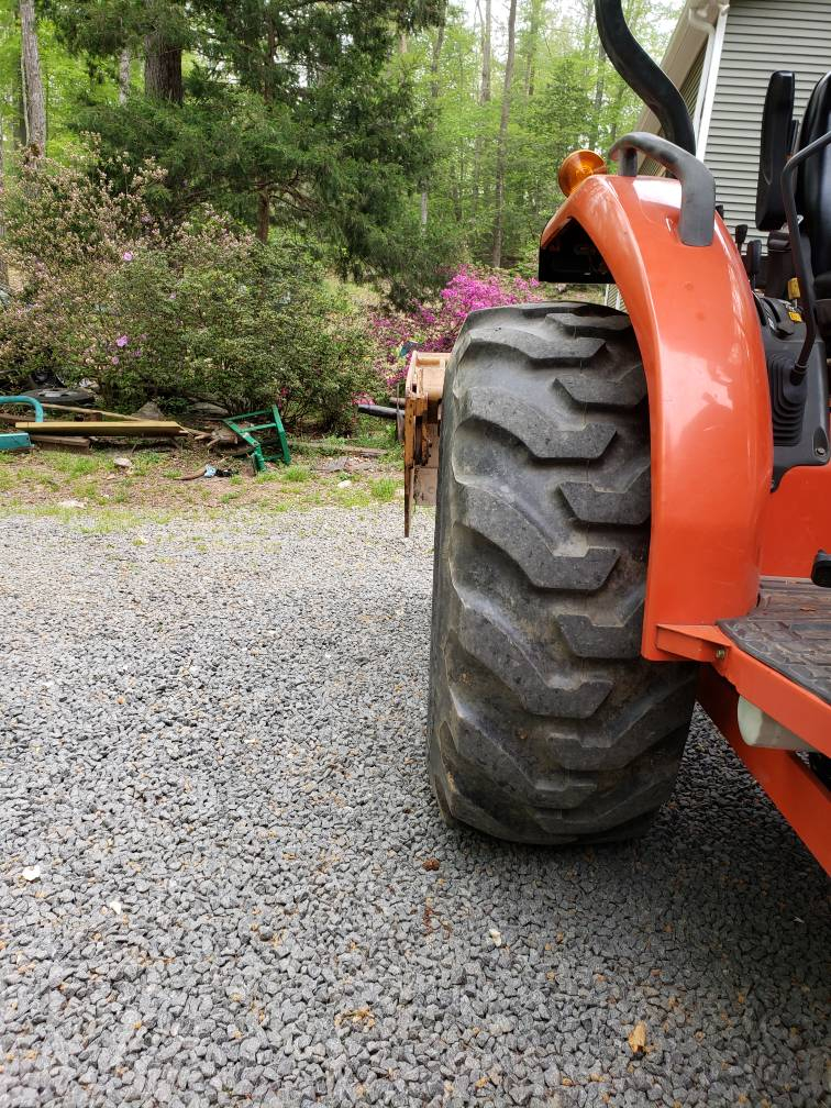

If wishing to level material, you really need it to a few inches wider that the outsides of your rear tires (typically wider that the front ones). Otherwise you will ge in a constant battle after your first pass, 1 tire will be on ground you have removed while the other will be on higher ground, this just to avoid leaving a narrow strip that you must come back to work and guessing ad to how deep to dig when leaving that narrow strip.
this may make limited difference to you on non m-ground engaging implements but is huge on ground engaging or material moving implements.

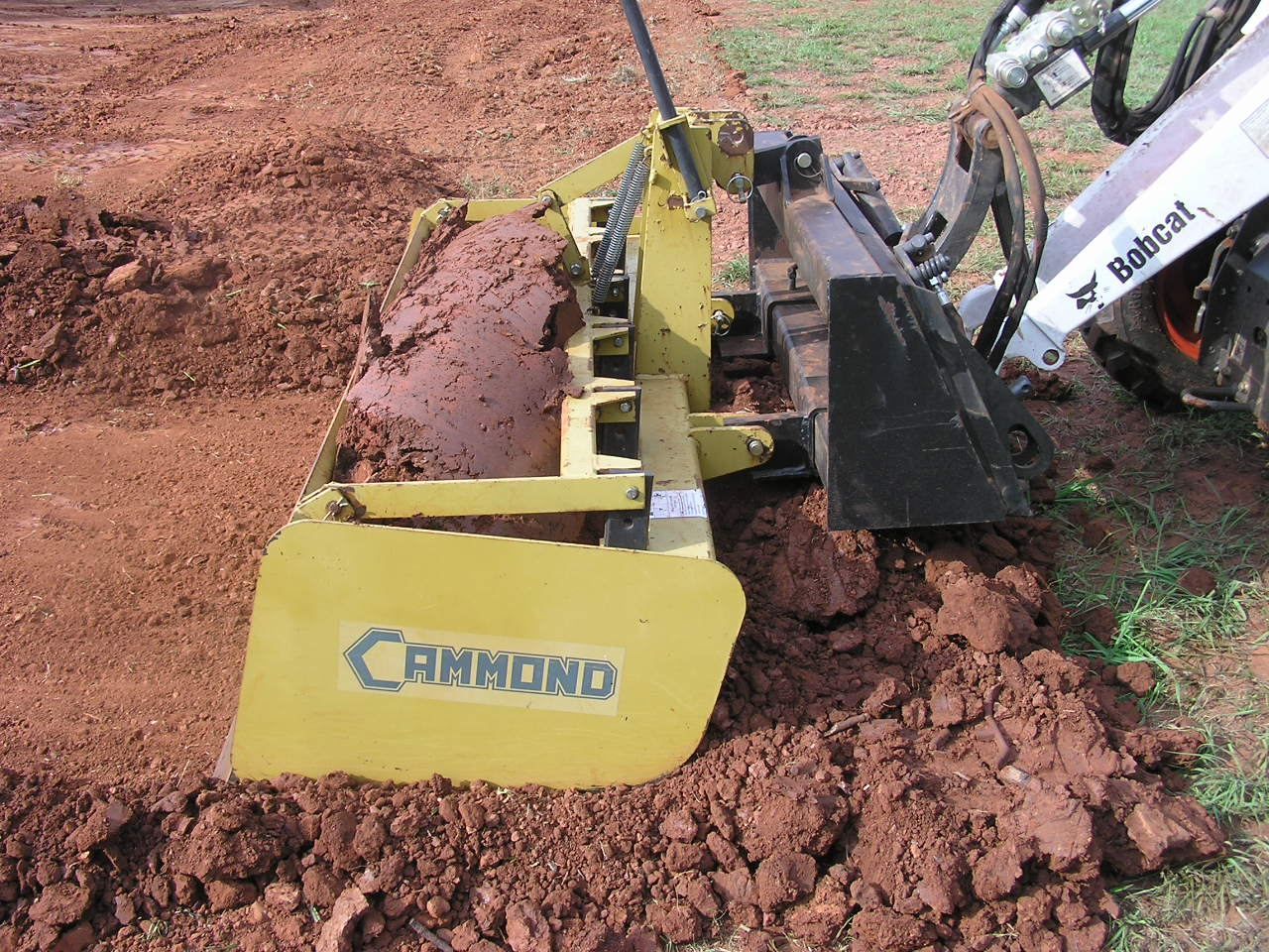

For best finishing results I run backwards. Hydraulic top links should be standard issue on ALL tractors! If you go really slowly you can feather your way along (you really need to concentrate and be coordinated in your actions/responses).
/ Box blade #31
For best finishing results I run backwards. ------------

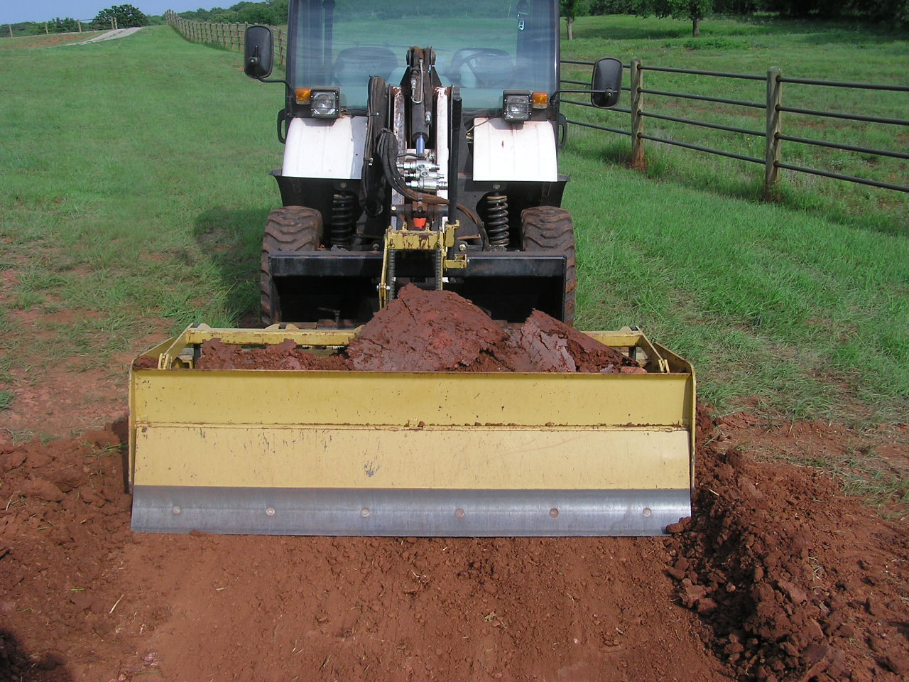

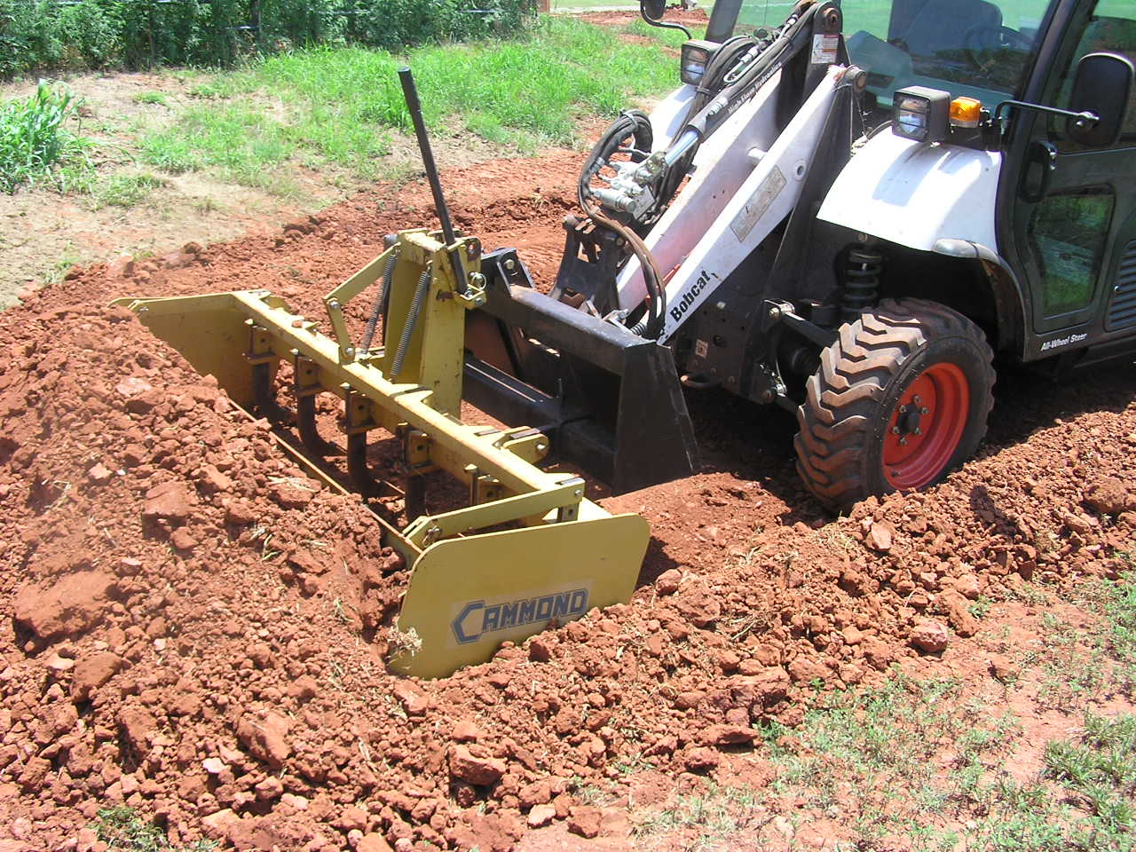

I run backwards, but the box blade is going forward:
If I go forward the box blade becomes a dozer blade:
/ Box blade #32
^^ Yeah, yeah, I heard about guys like you! :p (I finally discovered a fully farm-functional telehandler [gotta have a mechanical PTO for mowing!], but it's WAY too much - Merlo Turbo Farmer; I can dream!)
/ Box blade #33
View attachment 696782 View attachment 696783
That would be handy to get the clay or turf rolls out of the blade for sure. Even with the hyd top link sometimes I can get plugged. What happens when a rock stops the machine on one of the corners? The leverage must start add up on the loader? I popped a stabilizer clevis off my 3pt arm but it just welded back on. It wasn't this rock but one similar brought things to a temporary halt.

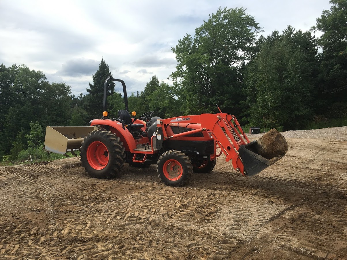

This is an 84" Gannon from an old skip loader I believe, that is a bit heavy for the tractor in virgin dry clay soil with the 8 scarifiers down and the blade digging in. But I find it works good with just tilting the box to engage only the scarifiers to rip up the turf and then level it and start cutting with the blade. If you can find a super HD one I recommend it as I don't worry about doing anything to this one. If the driveway ices up bad I just drop two scarifiers and let the whole weight of the box down on them and bust ice 2-3" thick on the gravel driveway. Or sometimes to hook a bigger rock like this one out of the ground without a lot of digging I just use one scarifier and the hyd top link to roll it up, or pulling stumps. I think on average having the blade wider than the tractor is better for dirt work, in tight areas not so much but with the 3pt all the way up and the blade curled up it kind of gets out of the way, or atleast aways off the ground.

I was looking looking for a 6ft box and ended up with a 78", which actually worked out better as I have about 3-4" of blade past the rear tires.
I also wanted heavy for loader counterweight when I have my unloaded tires on, mine comes in close to 160lbs per ft.
If figure out what size you want and then features and weight, then see whats available, I really like the everythingattachments build quality and materials they use. Only downside is the 12-14 week wait.

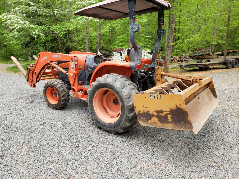

Here's my BB on the L3240
And a view of how much it extends past the tire
Yep, here is the hyd top link ;) getting a good angle for the rear blade to do some leveling.
Hasn't happened yet🤞. The loader arms are very stout.
