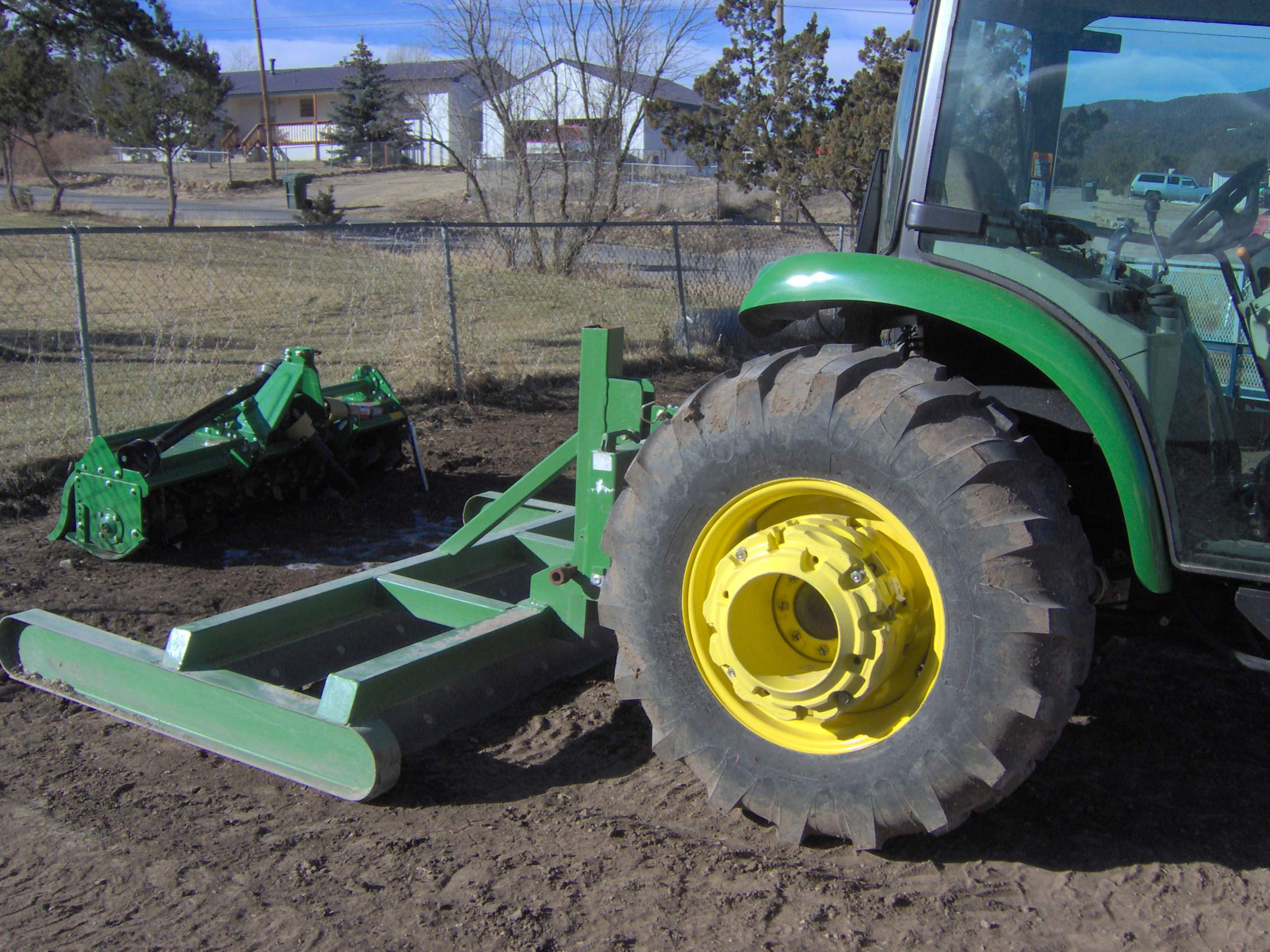

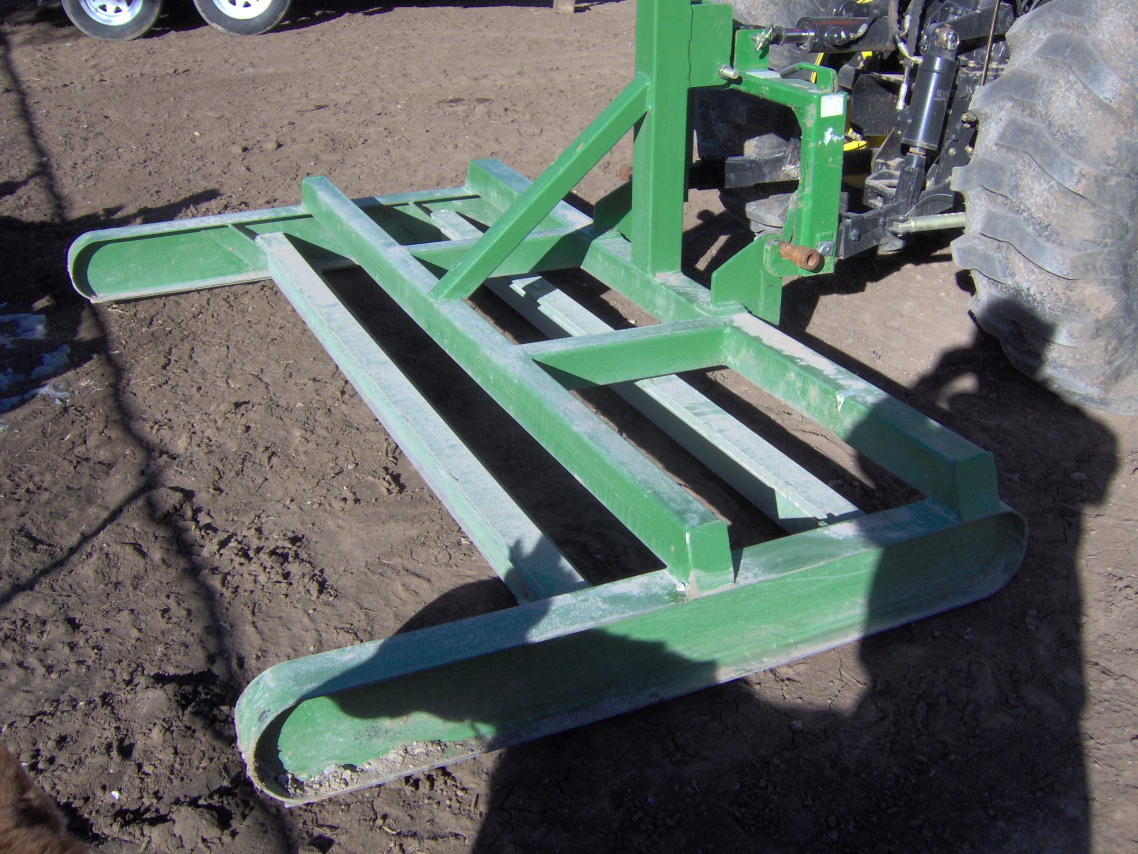

If the HB84 is in good shape I think the price is very good and would grab it. Get a top link from Fit Rite hydraulics and tilt if you have a second remote to use. If you have your tires loaded you can manage the boxblade as long as the ground is dry enough. I have a similar sized boxblade that I use with my 110tlb and 4520. If you can get your tractor weight to 5000 to 6000 lbs you should be okay. That is a good price, it takes some time and money to acquire good implements and I recommend picking them up when you get a good deal like this.
For most smoothing and flattening I use a landplane grader blade for lawn and field prep. Much easier to use for people with little experience than a box blade. I did use both a box blade and a landplane for my lawn largely because I had the box blade first. Here are some pics of the 8' landplane I built in 2009 to smooth up my lawn area. Also pics of the lawn after smoothing and planting the grass.
Beautiful place you have there in somewhere.
