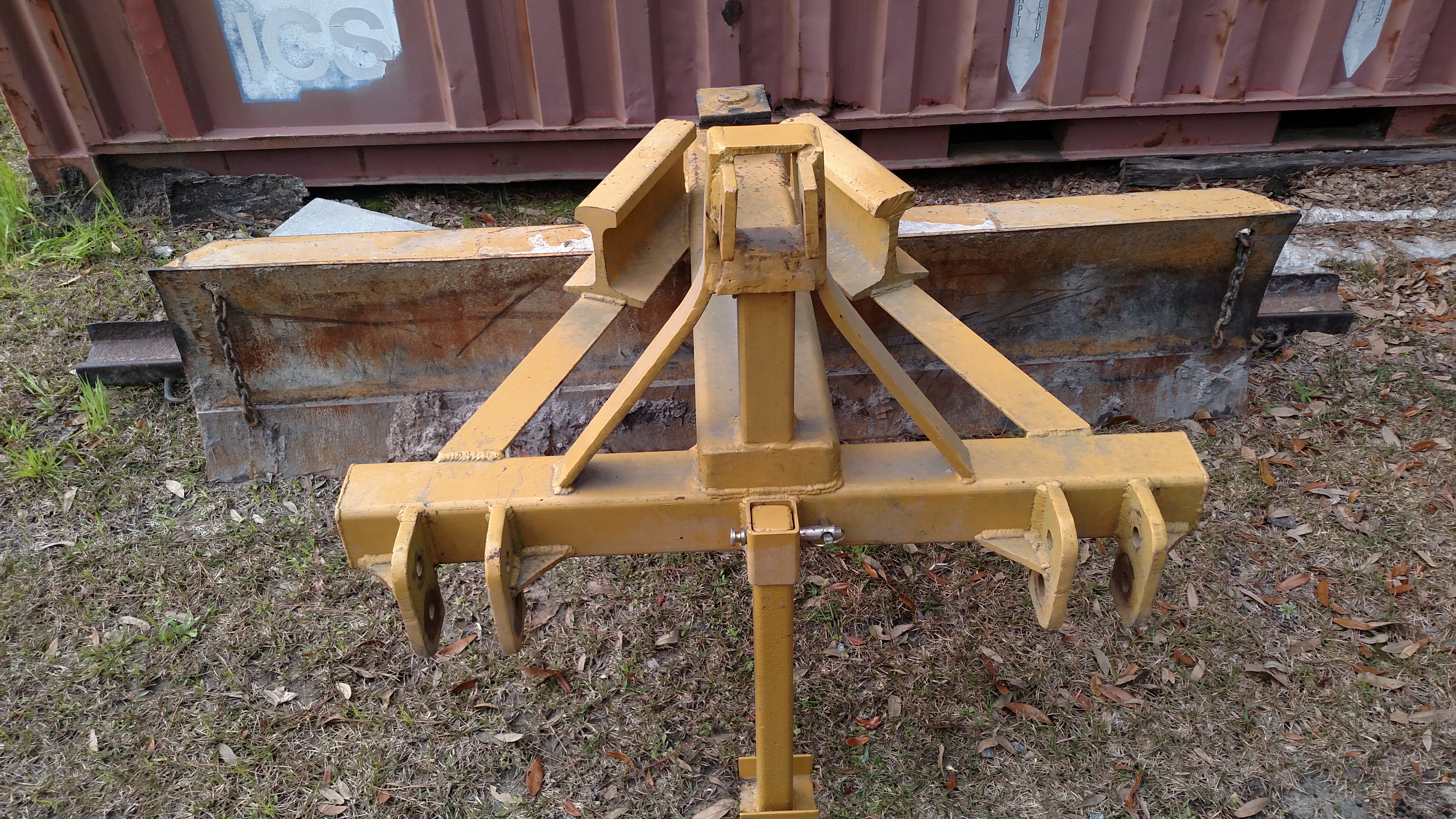

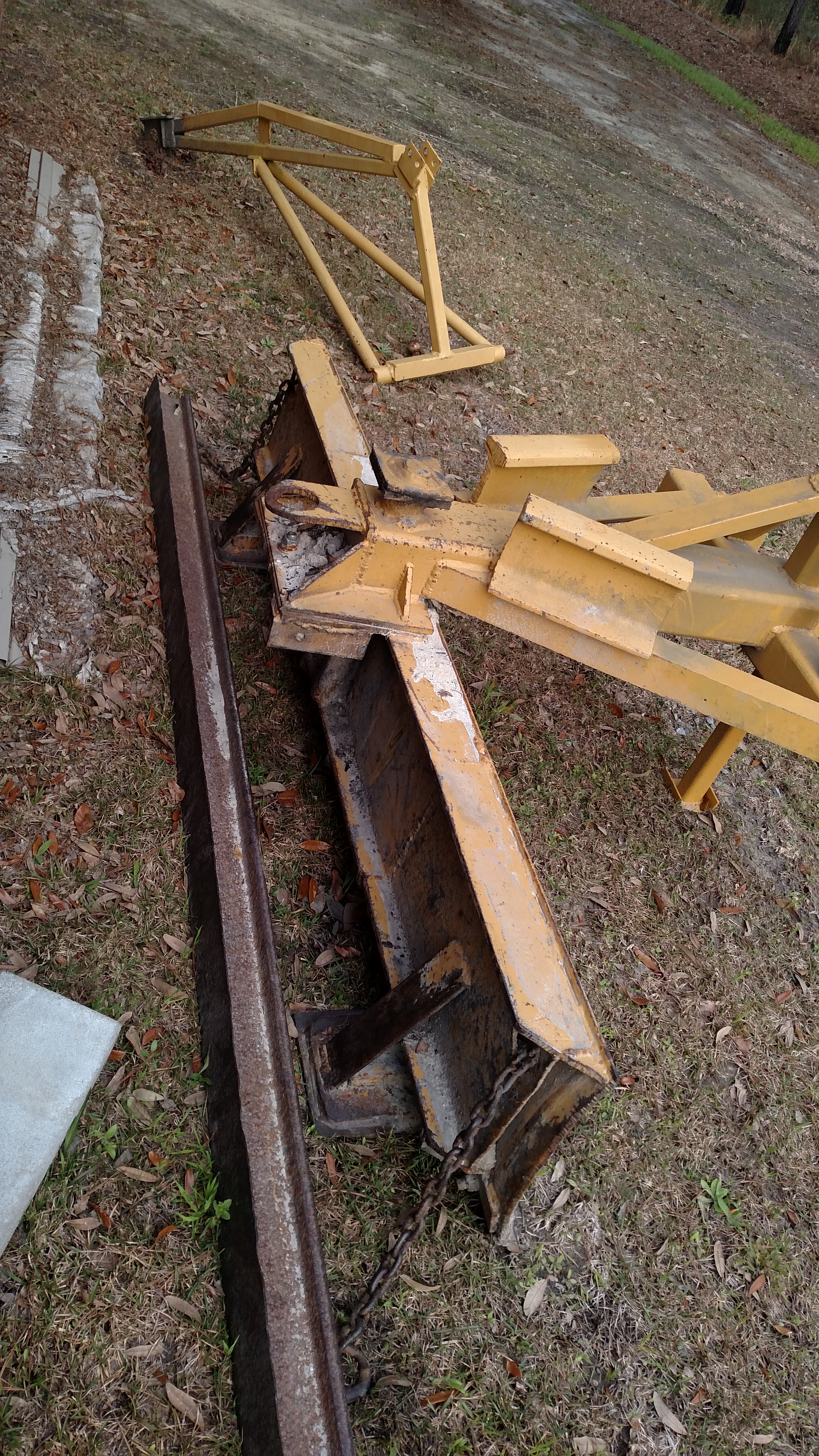

I would suggest something like this for rolling dirt, crowning and keeping ditches pulled..
Product Details
Product Details
I'll post a pic of my custom job..
