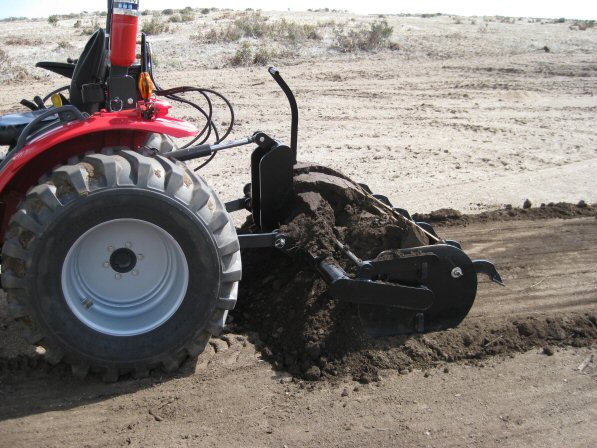

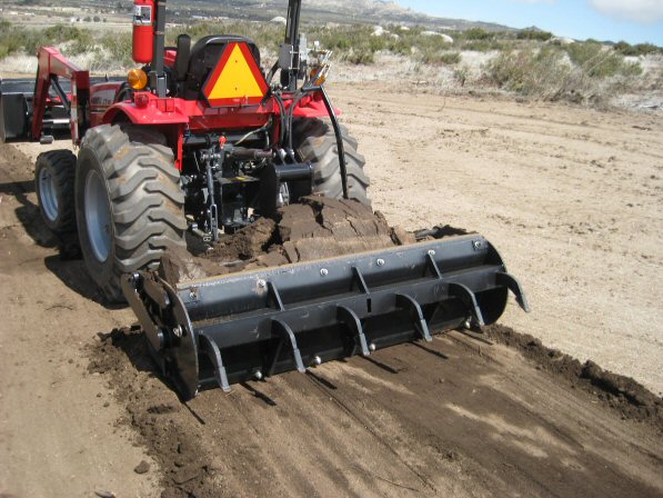

Sort of depends on your terrain. If you are going to have filled tires or not. No filled tires and hills = 5 footer in my book. Filled tires= 66 incher. I have a Mahindra 3215HST and I have a 66" roll-over box blade for it. I have some hills and my tractor will scrape and pull an over flowing load up hill. I feel that you should be able to pull a full load in what ever your worst requirements would be.
Just my opinion, others will vary. ;)
