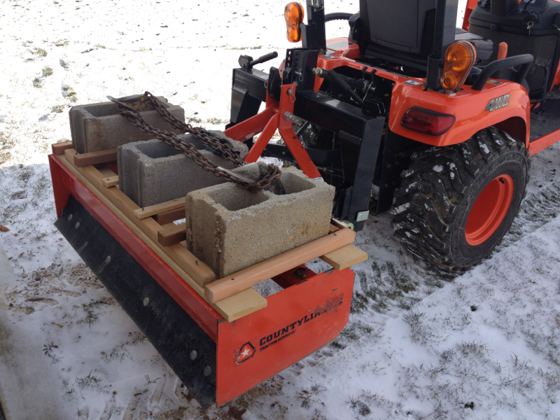

I have a BX2660 but was looking to go the fairly cheap route and bought a Countyline box blade from TSC. It's light duty but works well and I use it for the same uses you mention. I just recently added a little extra weight to it which helps. I even use this as my ballast box until I get my actual ballast box made.
I'd assume the 375lb bb would be even better, being heavier, but you could always add even more weight to it. There have been a lot of examples of this shown in another post recently.
