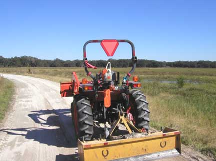

No kidding, that gets old real quick, the TNT is painless! /forums/images/graemlins/wink.gif
See attached action pic of Bush Hog SBX84.

I see you have 2 horseshoes mounted for extra weight! /forums/images/graemlins/grin.gif

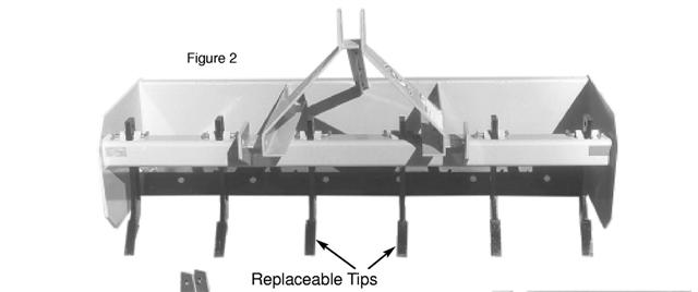

Travis,
I took a look at the SBX manual from the Bushhog website. On page 7 there is a picture of an SBX 720 with scarifiers.
The scarifiers extend well below the bottom edge of the blade. If your scarifiers don't look like this then you have the wrong ones as others have said.
Good Luck,
Kevin
