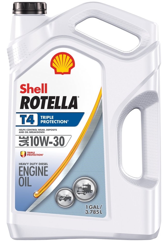

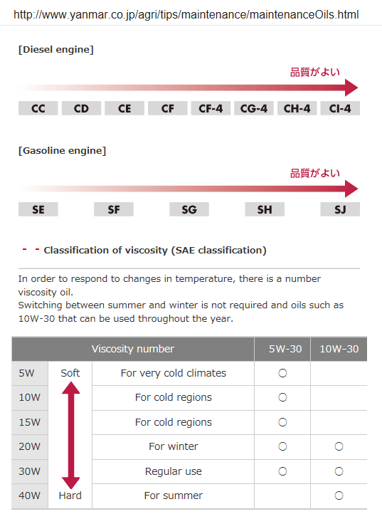

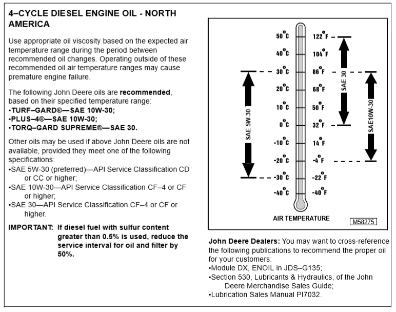

I'm running 10W30 synthetic in my Yanmar right now.
Yanmar 2018 info, The translation seemed to work via google.
This too is echoed by Deere.
Shell Rotella T4 is acceptable as well. T6 is the synthetic.
Aren't those two guidelines somehow contradictory?
Or better,we should distinguish what is considered summer temperature.

So the 10w30 would not protect diesel engines adequately.
The only 30 grade engine oil capable to do so is the single grade 30w SAE.
I think that if we need to act by-the-book for mitsubishi or any other old japanese engines, there is no other option.
