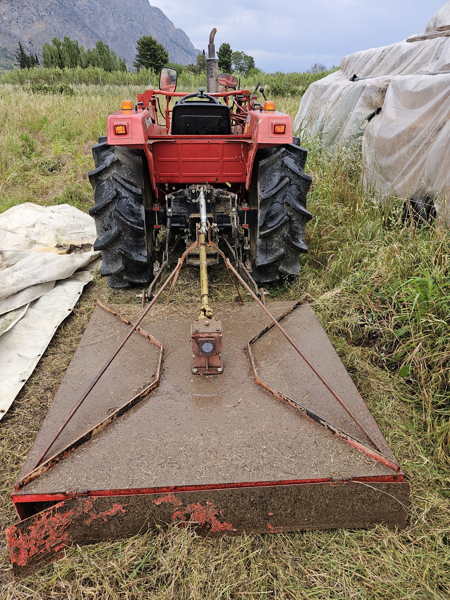

We had a come back of dusty rains here in Europe for the last few days, this is why eveything is mud covered .

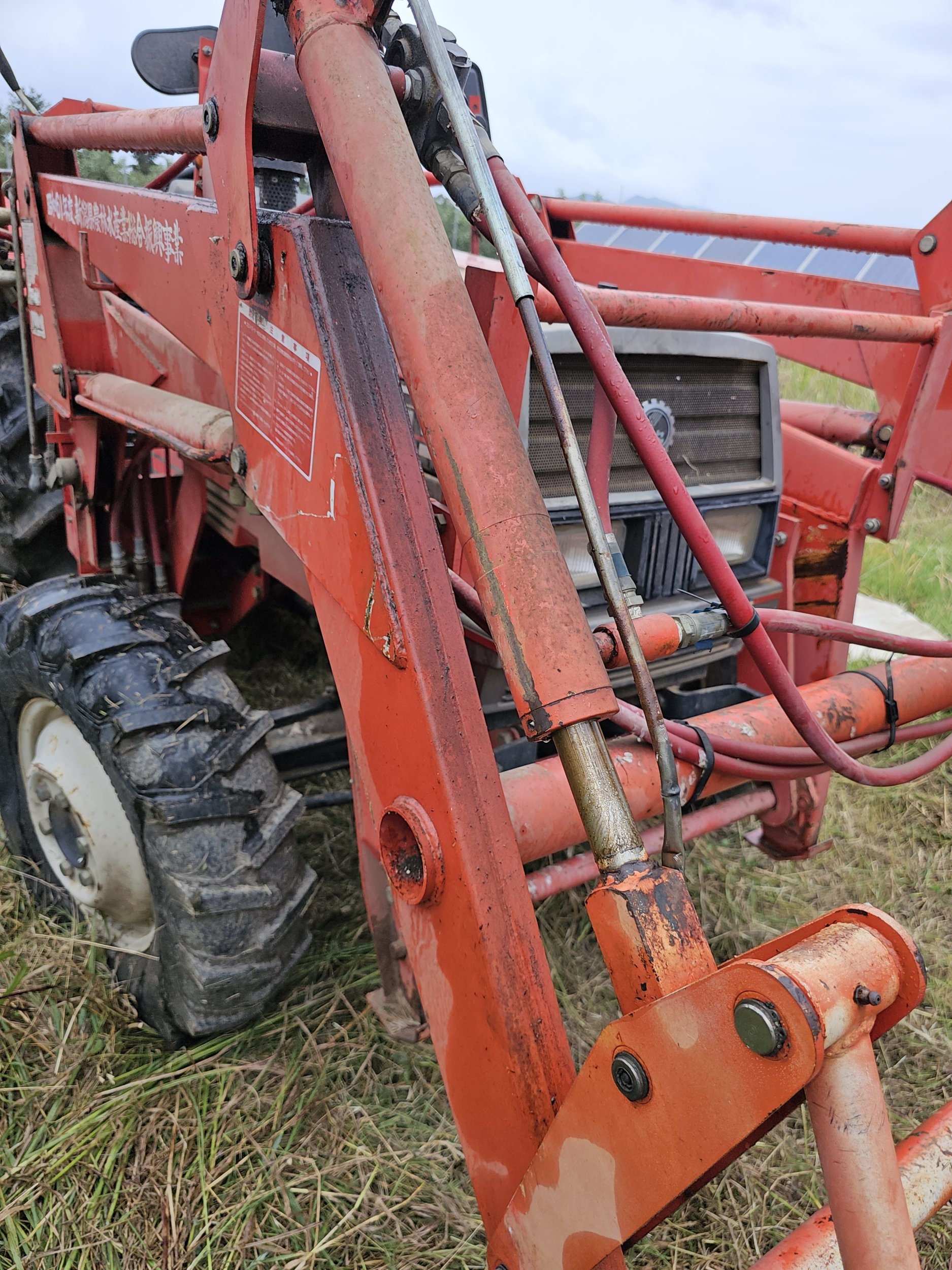

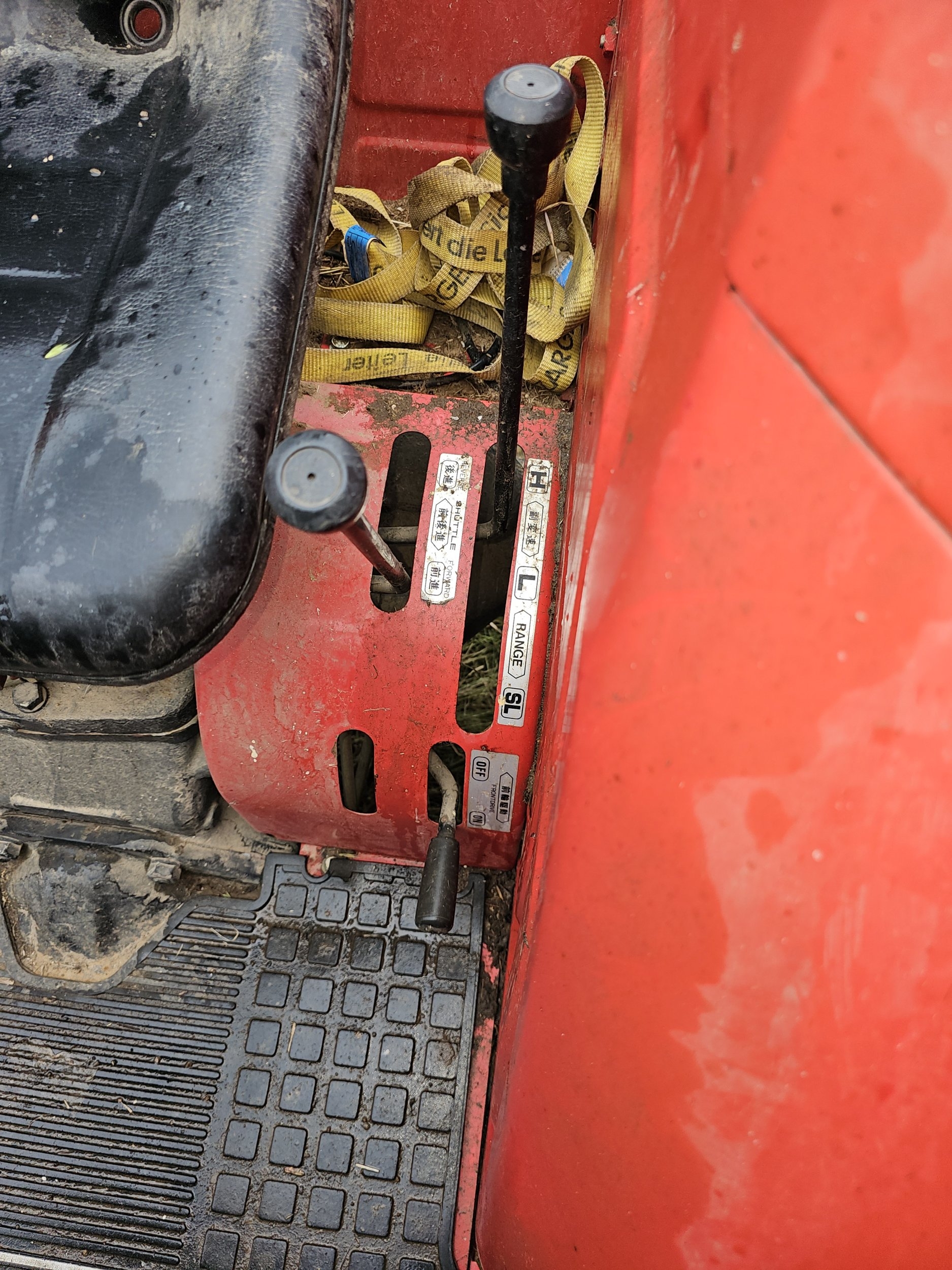

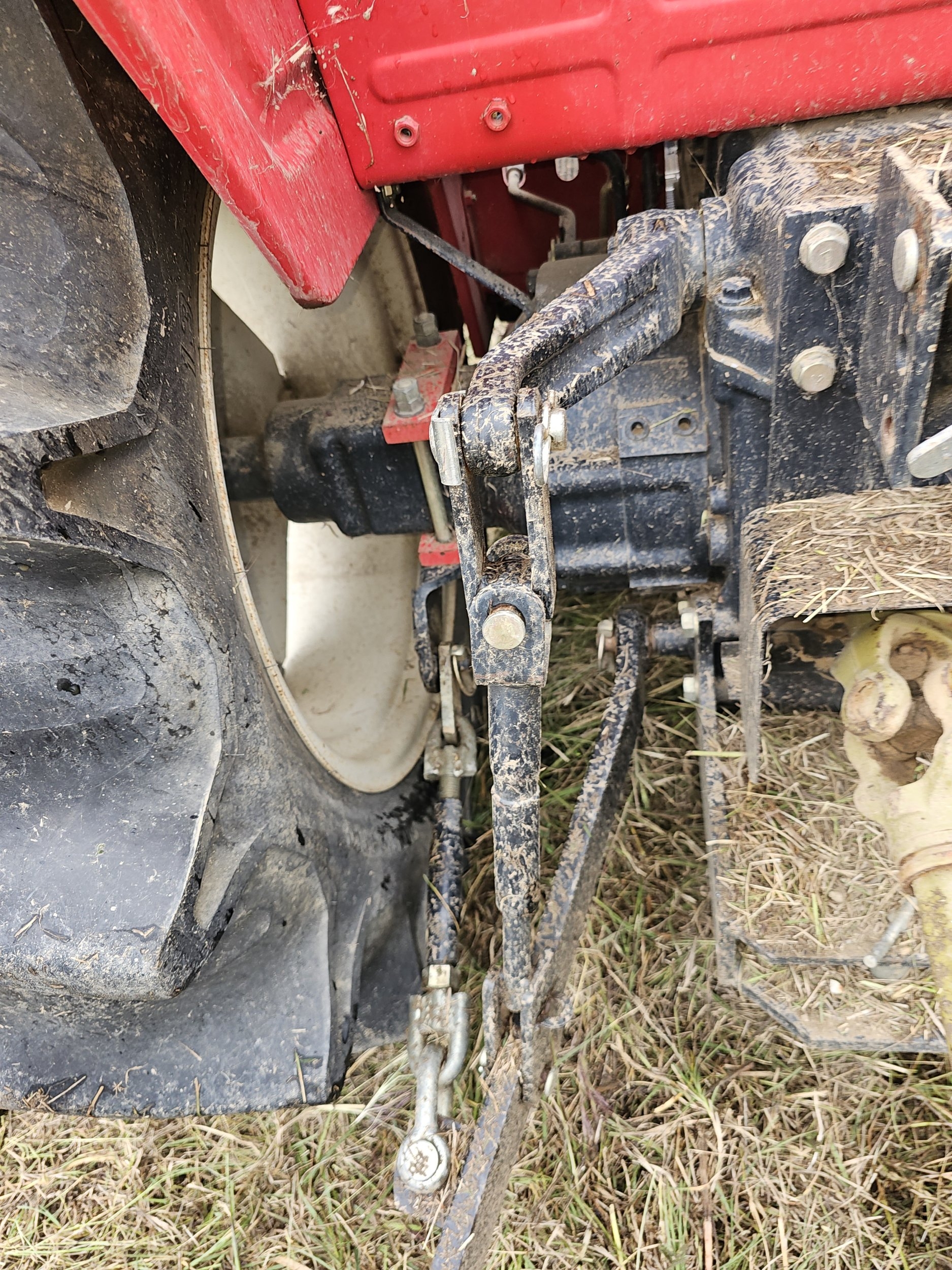

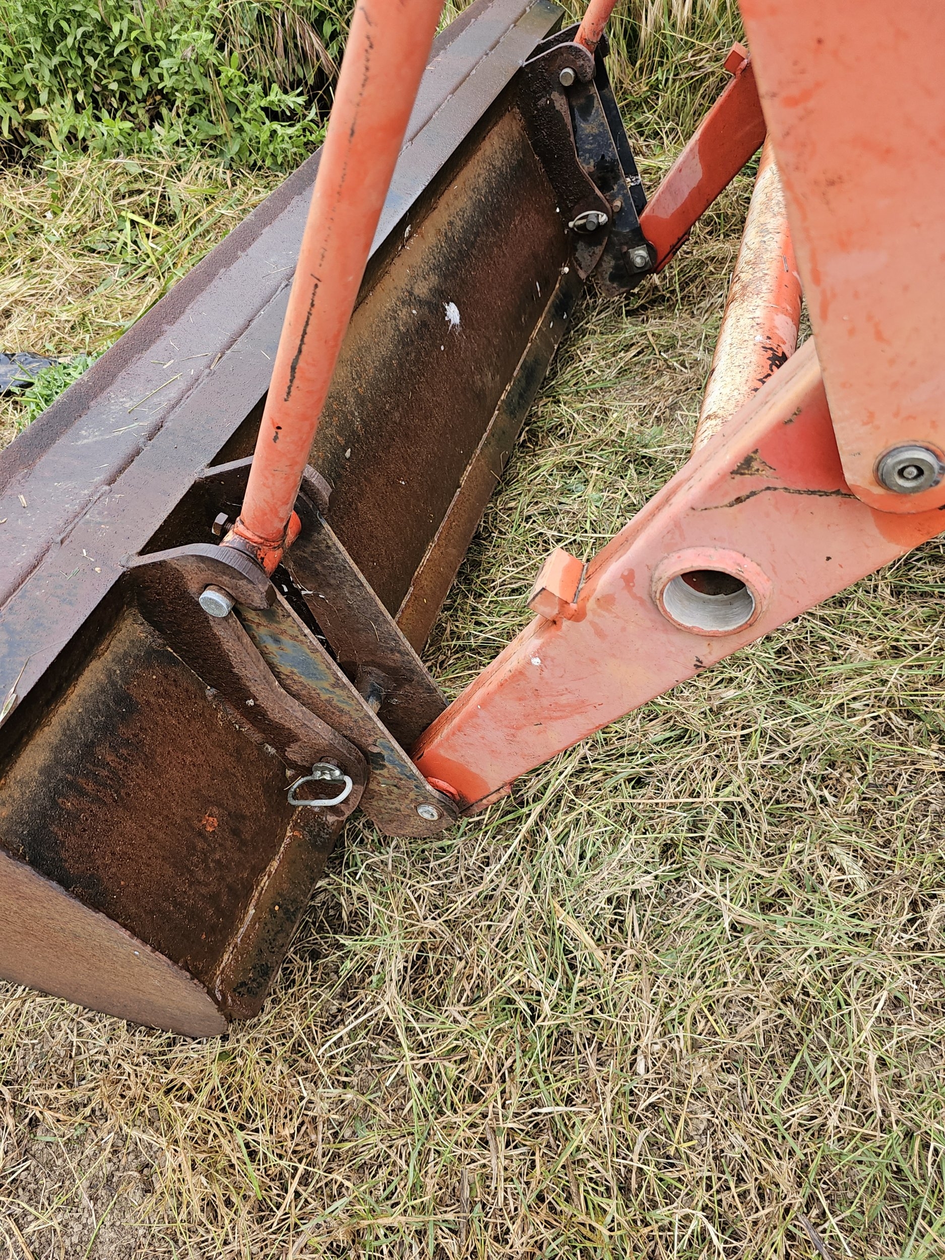

Apart from new gearbox oil ,front differential oil and engine oil replacement ,few things need to get fixed.

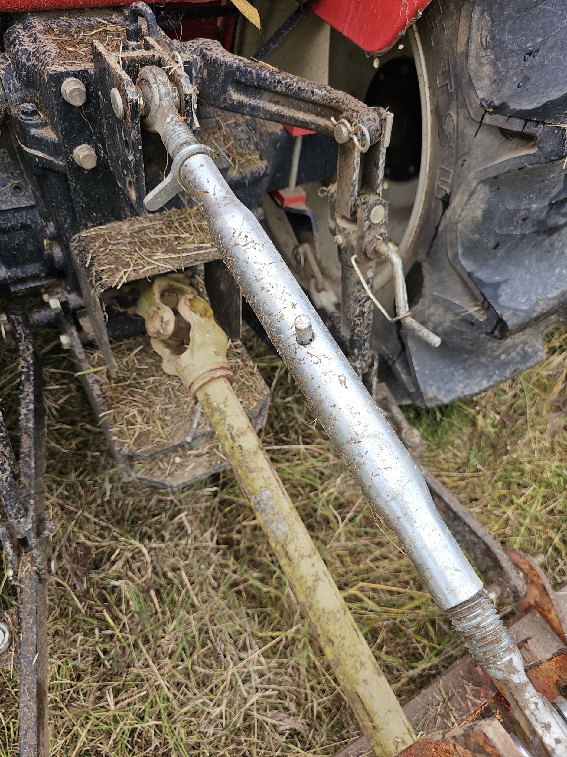

3 point hitch lever is stiff and does not have a sweet spring motion.The rear implement is moving up and down , and the hitch keeps it fine at every position, but certainly smth is not working as should be.
Moreover there is a leak at FEL's front right cylinder. No experience with hydraylics in general so I may ask for tips and tricks on replacing the seal:)

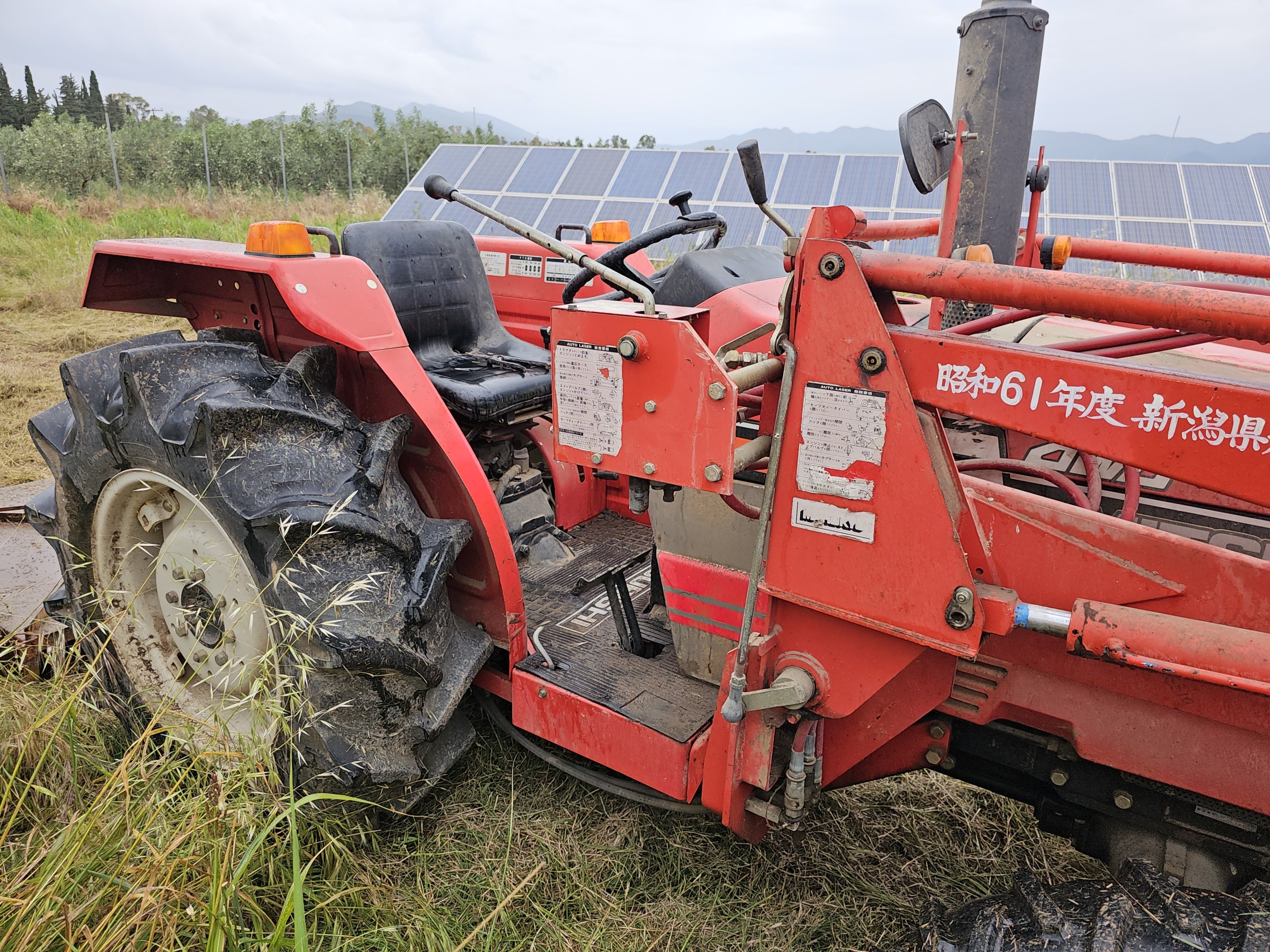

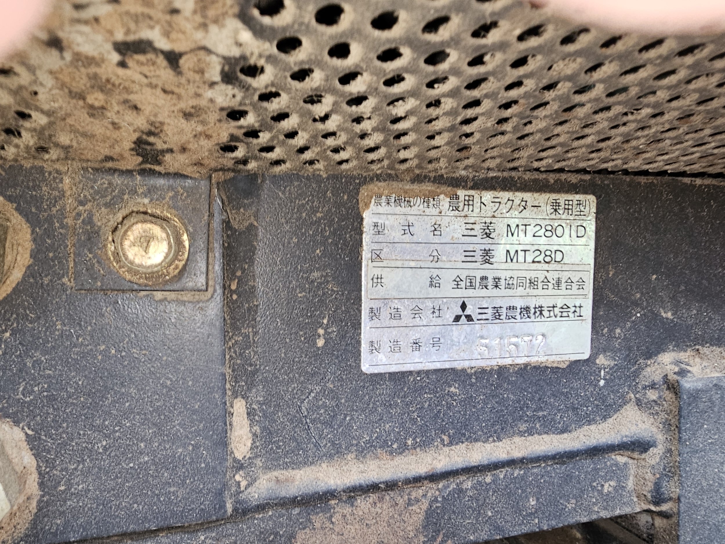

To be more precise ,the color issue emerged AFTER my purchase,not PRIOR.
The mt-28 on tractordata is red but that is a 2010 tractor, and then the only -28 with a 90's scheme was mtx28.
But mine MT2801 unlike shown on tractordata on blue colors ,as well as on many google results ,is in red colors.
I hope and believe this is a "hard-core" japanese lad ,directly imported from japanese market.
There is a white marker inscription on both sides of engine hood ,and on both FEL main arms.
Using my S23 text-by-photo extractor function, I copy-pasted the japanese text.
Apparently the tractor was under Shindo perfecture civil services by the fiscal year 1986. Ok, I am not so sure about that,because the japanese ideograms make completely different meaning if there is a blank space between them or not.

I was hoping you would have gotten a picture of the 3pt linkage. I am thinking it may have a friction plate and you could adjust the resistance in movement.
As far as the leaking cylinder, around here you can take it to a hydraulic shop and they can rebuild it for not much more than the kit. Getting the gland cap off can sometimes be tricky. They also can size the seals and often times have what is needed in stock.
