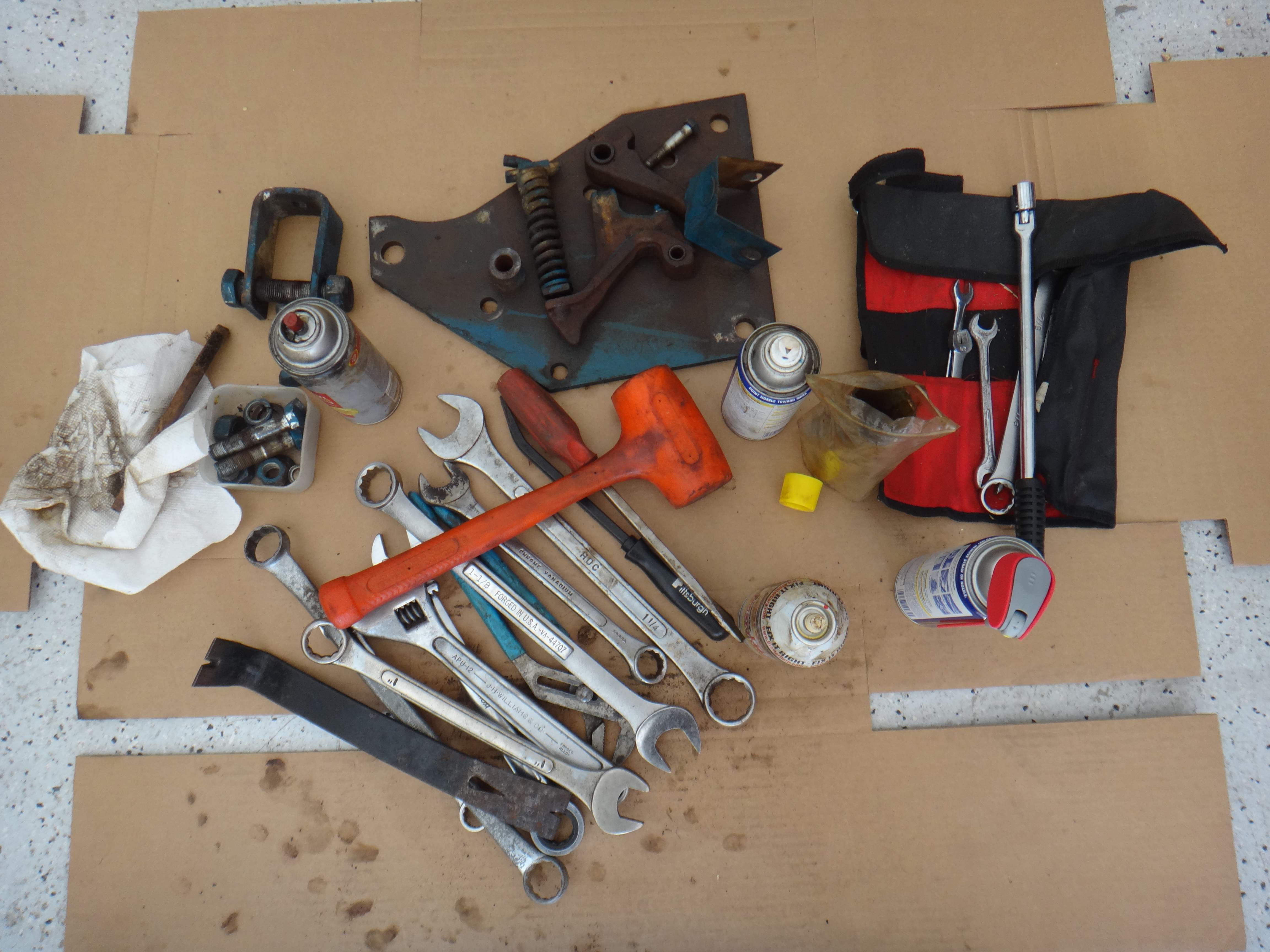

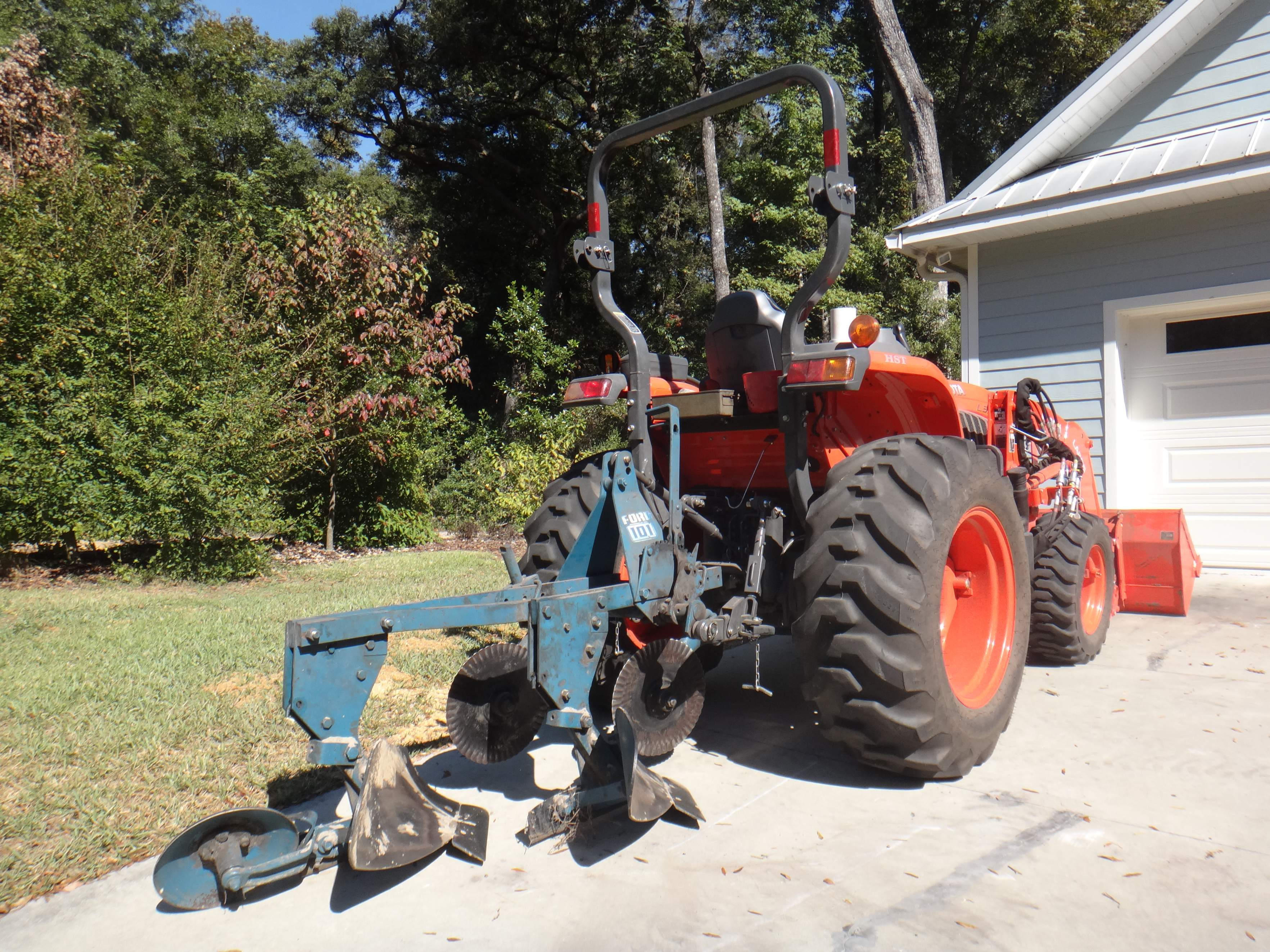

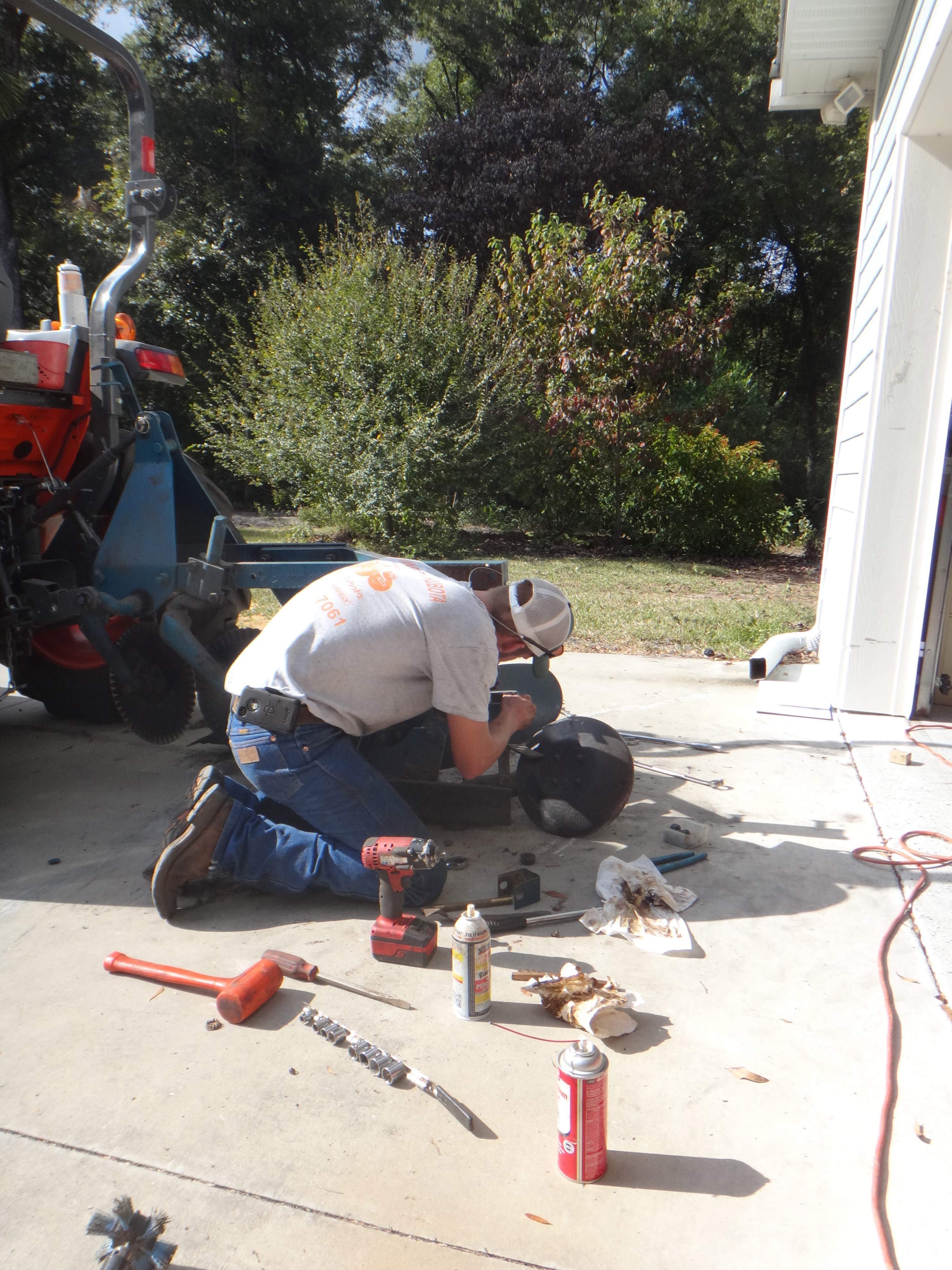

Picture #3 + #4 Cleaning and lubricating trip plow mechanism.
