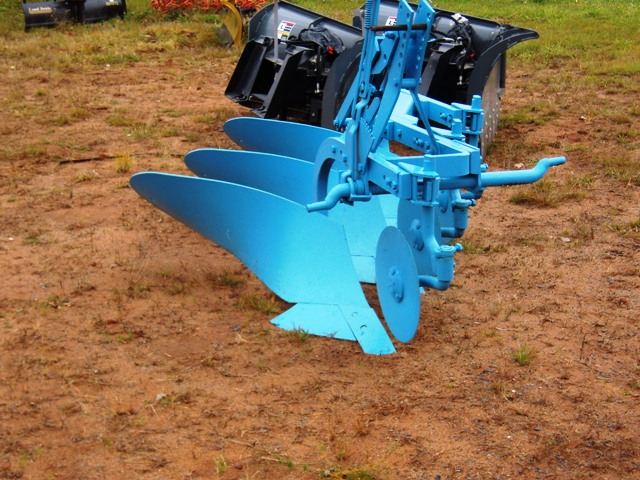

For breaking chances are a single bottom would be optimum. If you are working cultivated soil two bottoms should work. :D
Me thinks but There could be some error in my thinks machine!:eek:
A picture of a three bottom plow attached just for comparison sake.:)
