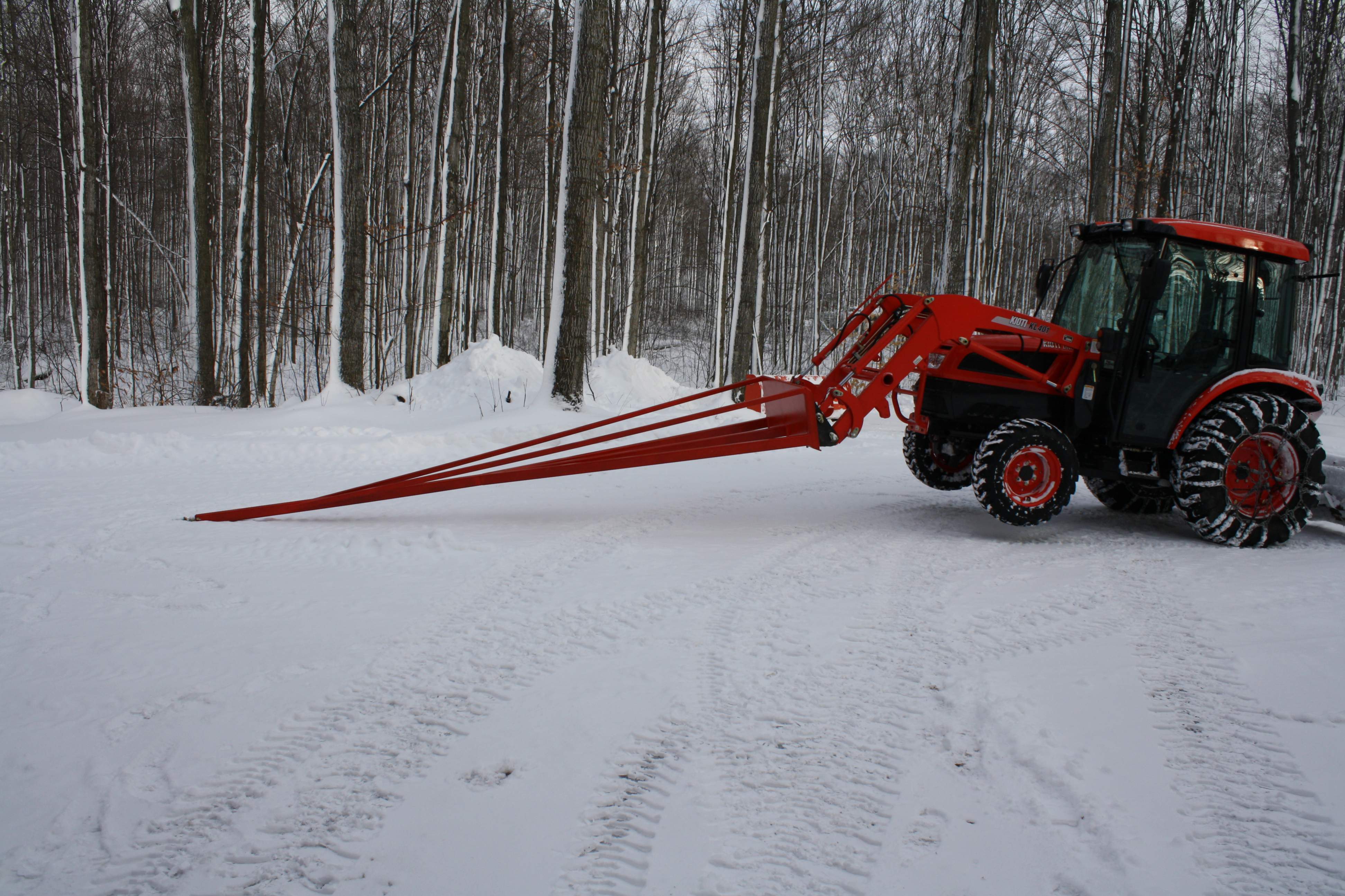

I will be building a boom pole on a quick change attachment for my DK50. I have a 24' 2x3 tube that I will be using. Just curious what would be a good length to cut it to. I am thinking 15' but would like some personal experiences with these CUTs as to what they will handle. May also add a hydraulic extension depending on my mood! Thanks for the input. CJ

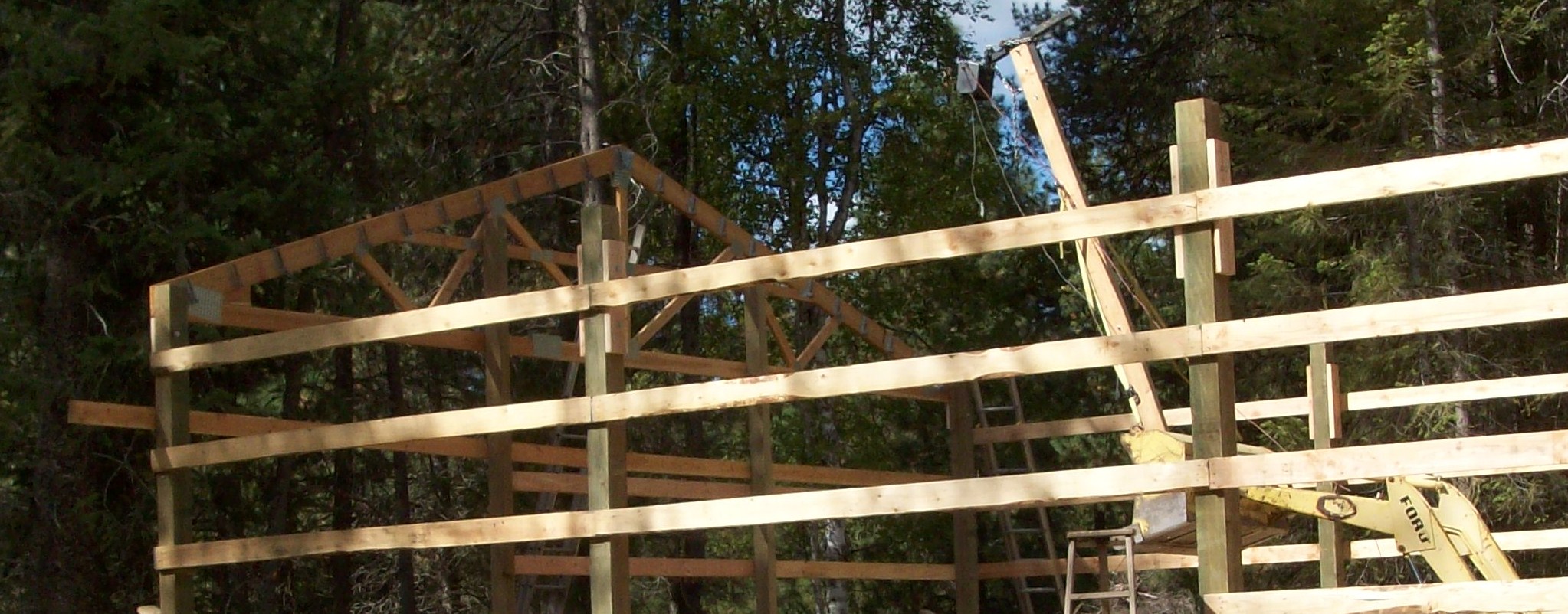

I built one out of a 6x6 tube that is about 12'. Then made an insert sleve for a 4x4x3/8 tube inside with about a 7' cylinder to extend it. This was built for a 5 ton SS and it's worked great, I've set a bunch of trusses with it on smaller & lower bldgs. It's great for pole bldgs. as you don't need the reach because you can drive into it. With only a 2x3 tube and not being familiar with your tractor size or loader, I'd be conservative and cut it in half (no extension) and join them together at the hook end and use a cable for the top brace to make a triangle shaped pole that all 3 points coming together at the hook. The 2x3's joined togher should work well for the lower (compression load) legs with the cable, prolly 3/8 min. for the top (tensioned load) leg.

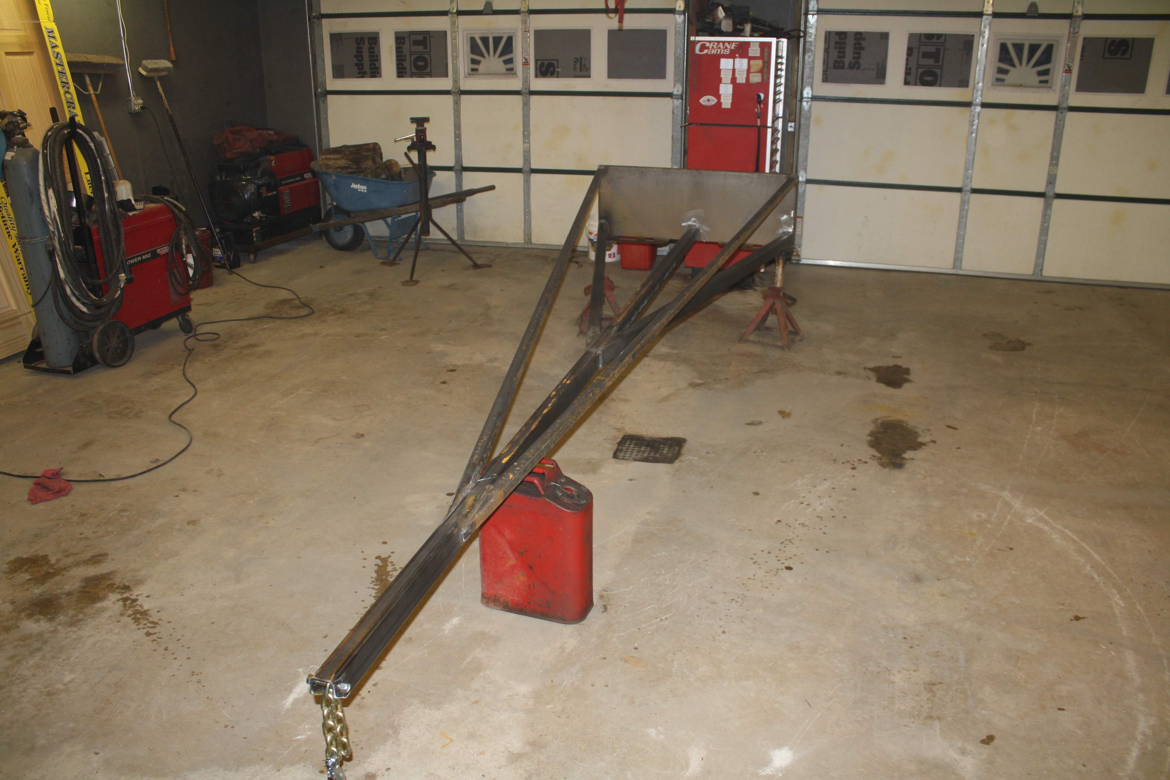

I am going to use 1" square tube for bracing all the way to the tip off of each side and angle brace the center with the remaining 2x3 from each corner at the bottom. The main pole will be at the center bottom of the mount. If you can picture this. The cherry picker I built has 2x3x3/16 secondary tube and it will pick up 3000lbs with no bracing at 3' out so with the bracing I should be alright. As you said it will be under compression and be braced from the side for deflection. I am guessing the loader will lift 3500-4k on the ground at the pins. It is rated at 2700 to full height. CJ

A few pics
This one showes it's plenty strong.

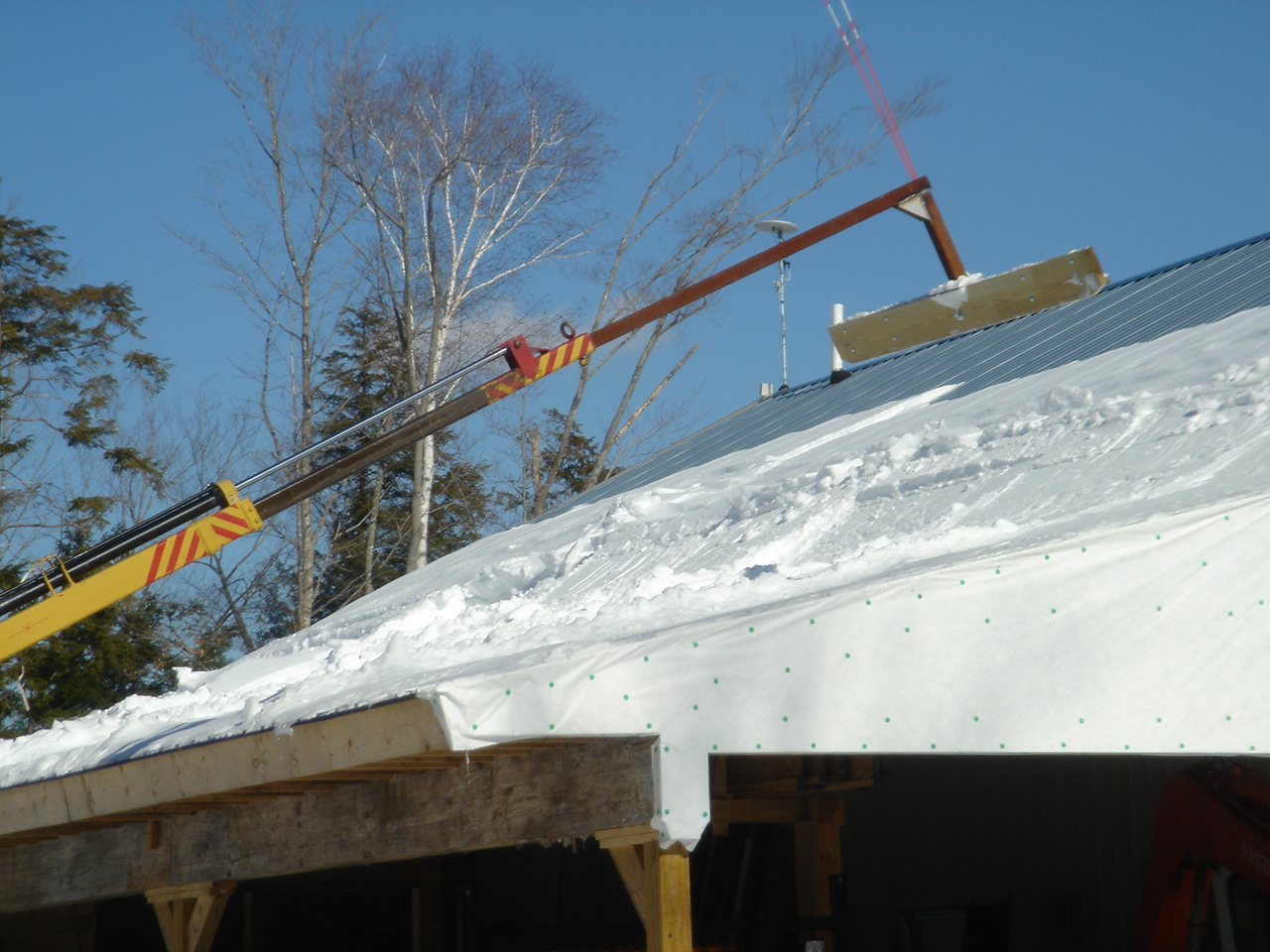

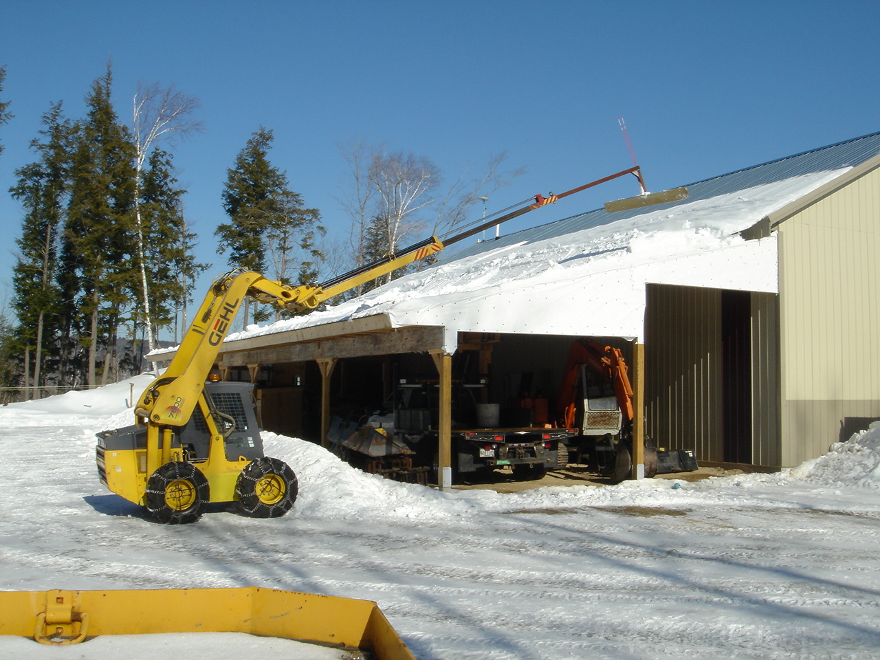

I see your in N MI & I guess that you have to shovel a roof now & then, so just for giggles I'll show you an "attachment" that I made for my "pole":cool2:
Have fun painting, it's a love/hate thing for me:laughing:
At 15' out from the loader pins your lift will be in the 500 to 1k# range. Is that enuf for your purposes?
larry

Thanks Rusty, I hear ya on the love hate thing. I used rattle cans to boot:( and I hate them!! still better than $150 for auto paint. I am going to try a concrete broom for the roof. CJ

Thanks Larry, I picked up a 800+lb power pole with it, so you are right on with the weight. It is more than enough. I can only curl about 600lbs so I am goint to have to be careful about overloading my curl cyls. Surprised me it had no problem with the pole, did not lighten the rear much either. Go figure. CJ

this is the low, low, dollar boom pole I threw together out of two 2x6s bolted together worked well enough to set 25 ' poles for our barn and the trusses for the garage2010 018.JPG added one of those small electric winches to the top for the truss setting, allowed 1/4 " movements to get them set on the truss support plates, think it got disassembled and is part of a bench now.. If I need one again think it will be built like yours, out of steel btw 13' is the length we used
