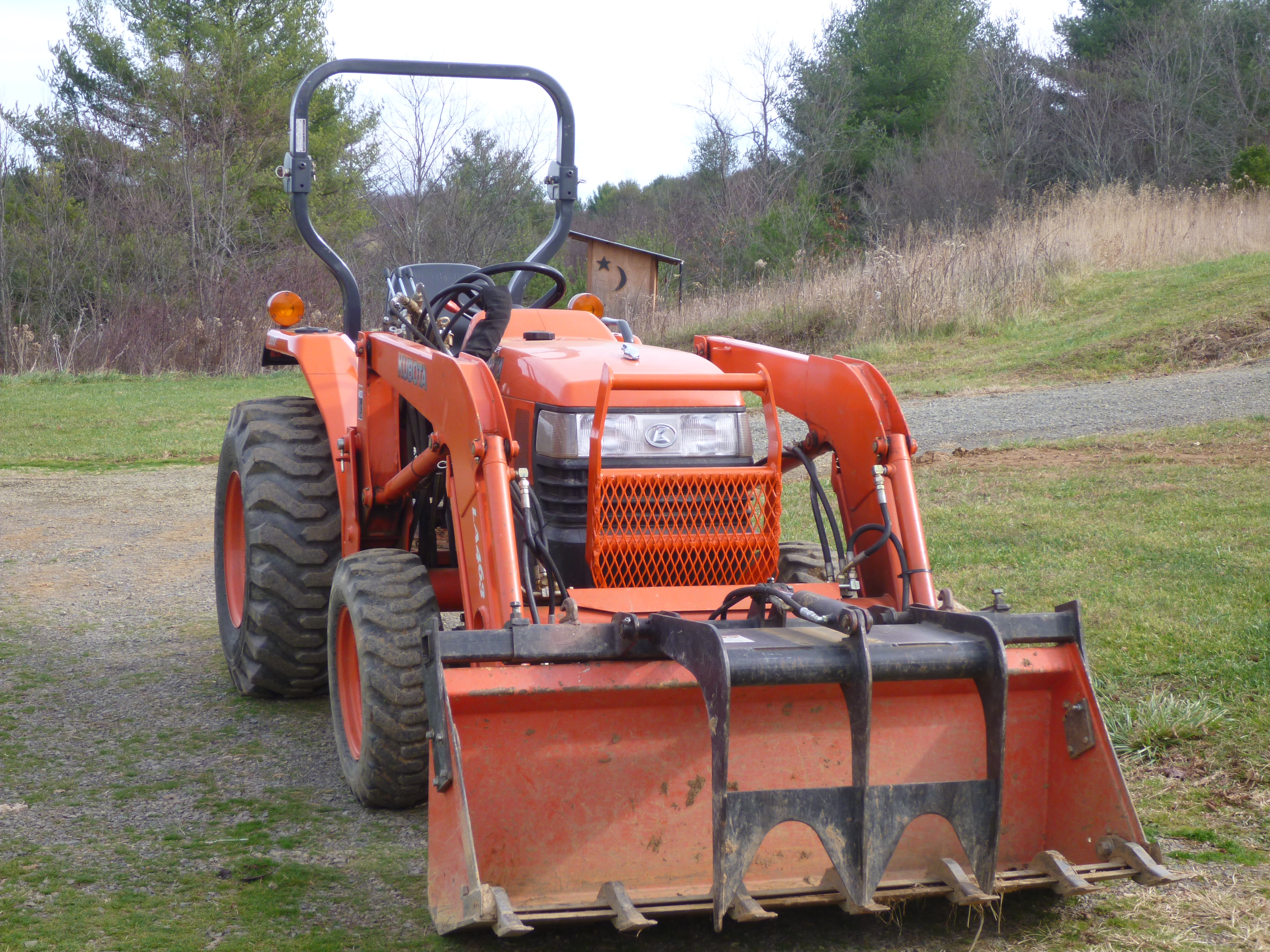

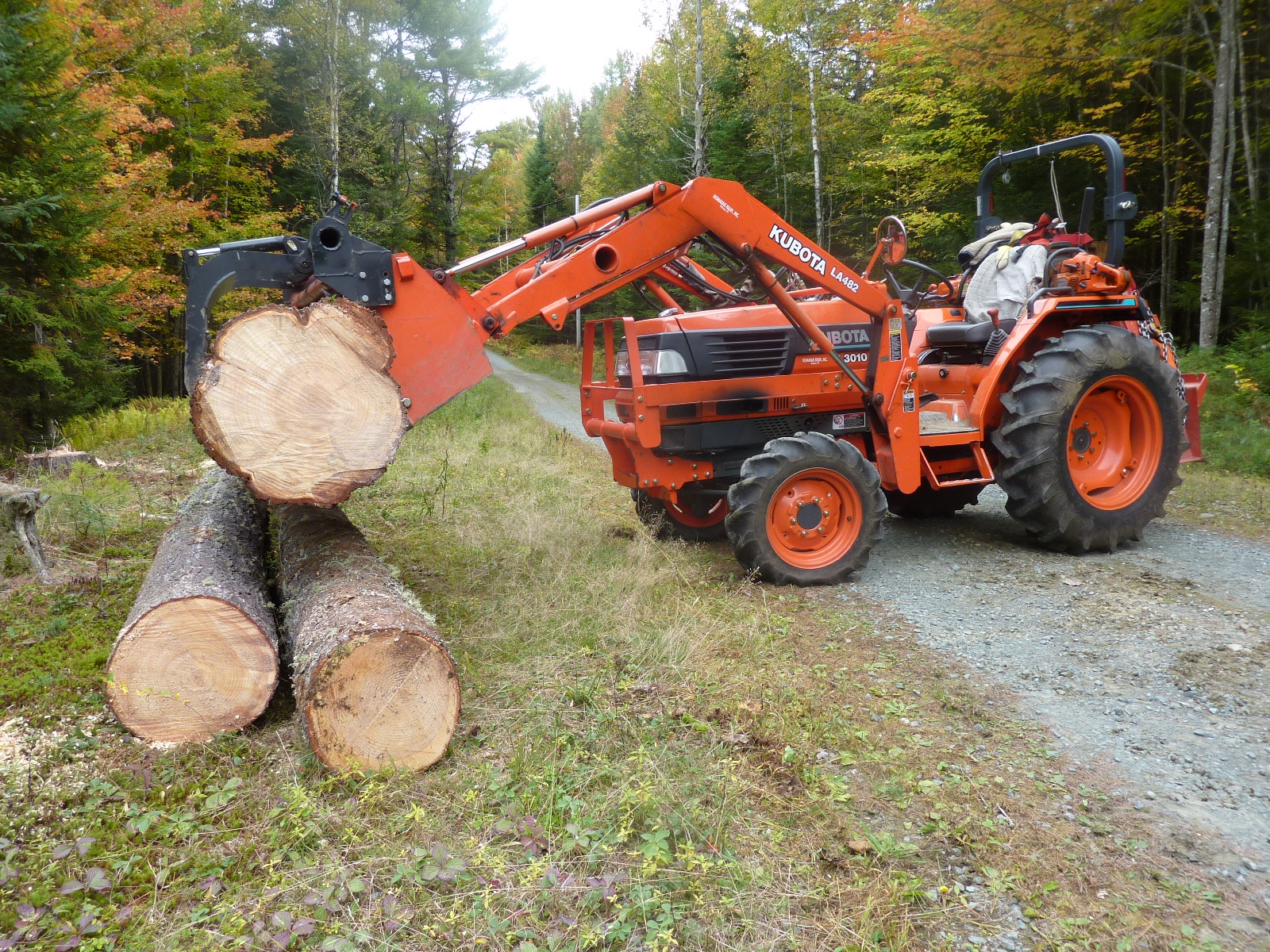

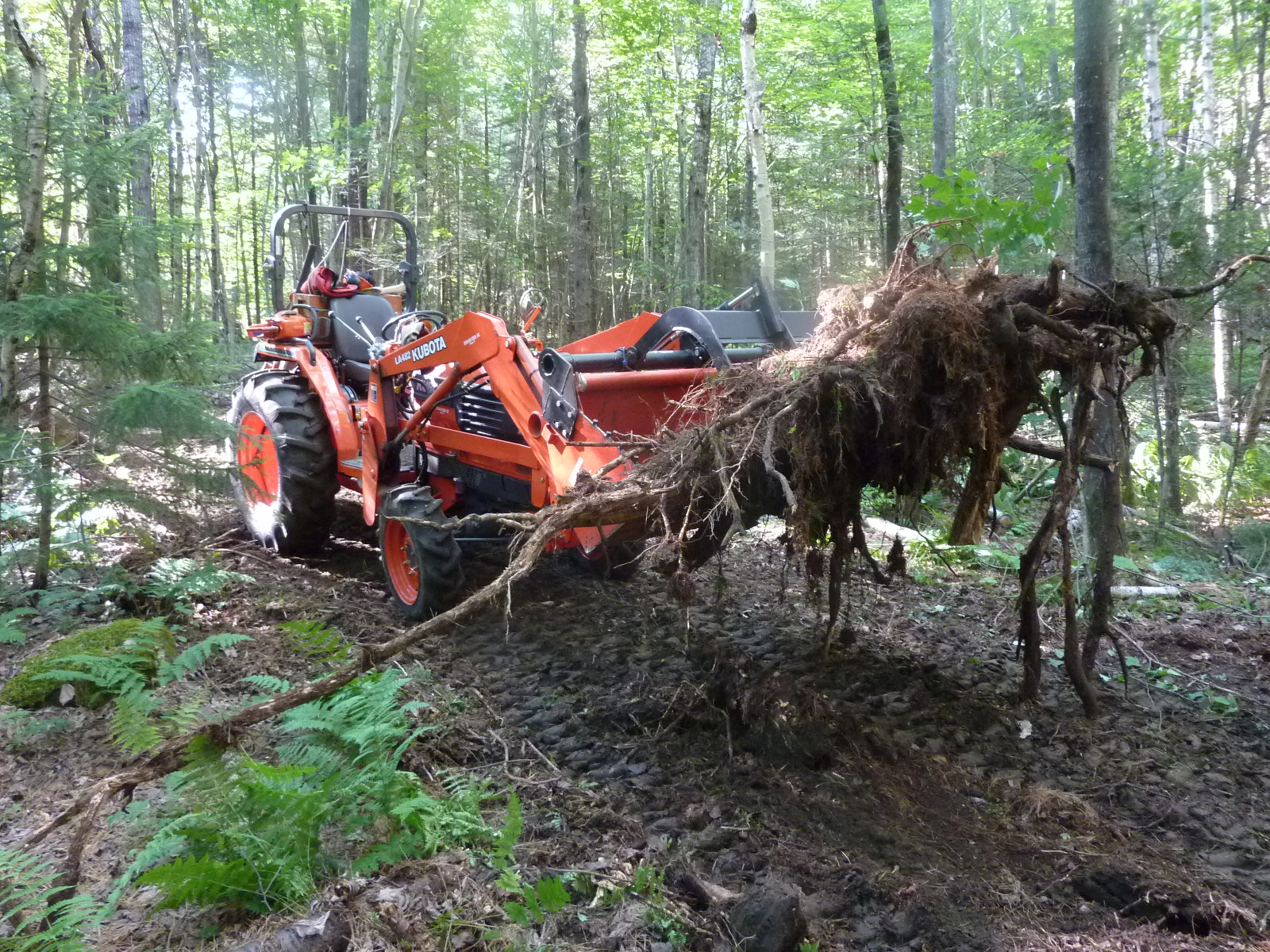

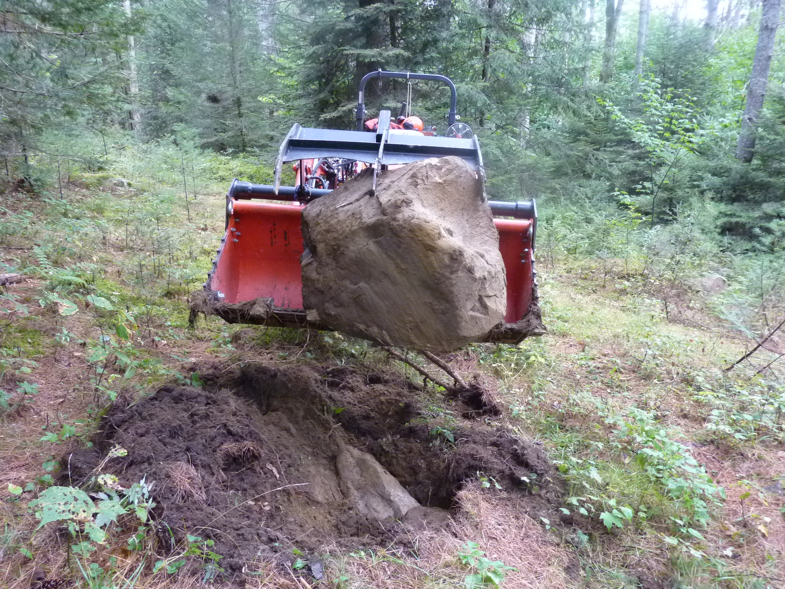

I bought mine from a member on TBN, $350 and he was less than an hour away. I love mine. Using it with a toothbar is a better. The tooth bar is removable pretty easy depend on what I need done. Doesn't weigh that much so I don't lose that much lift capacity. It's WR Long...

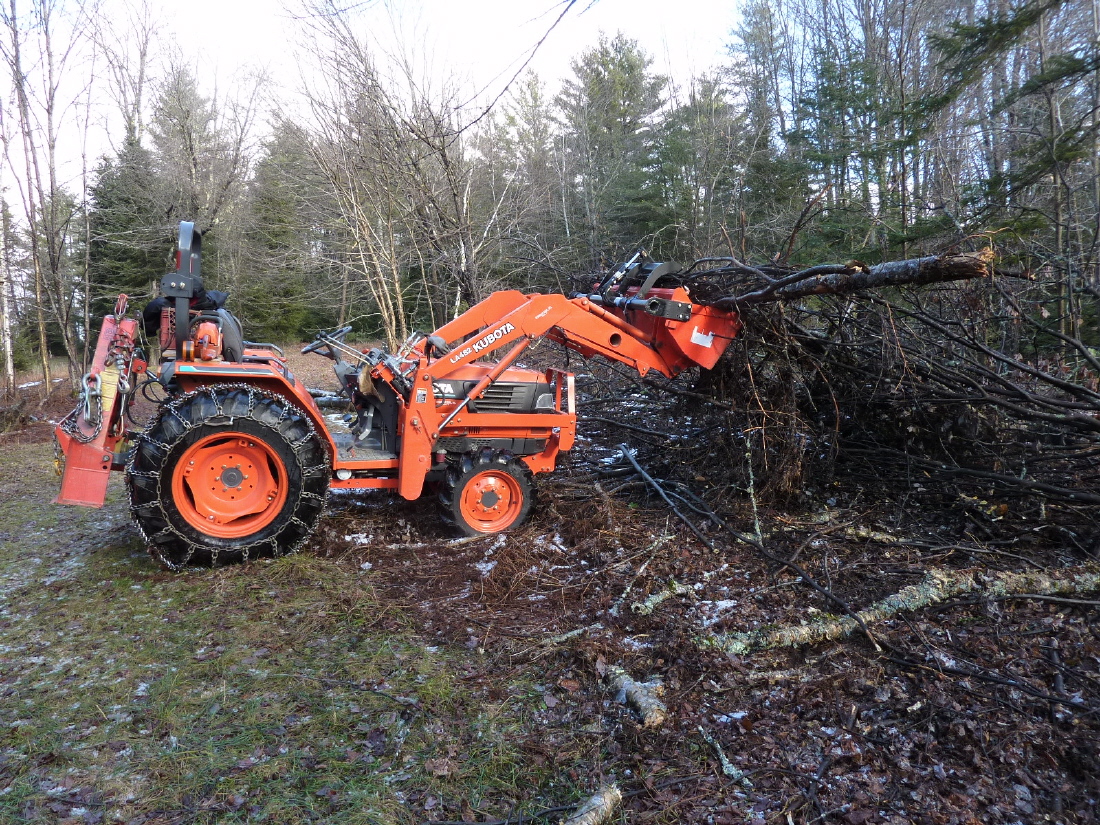

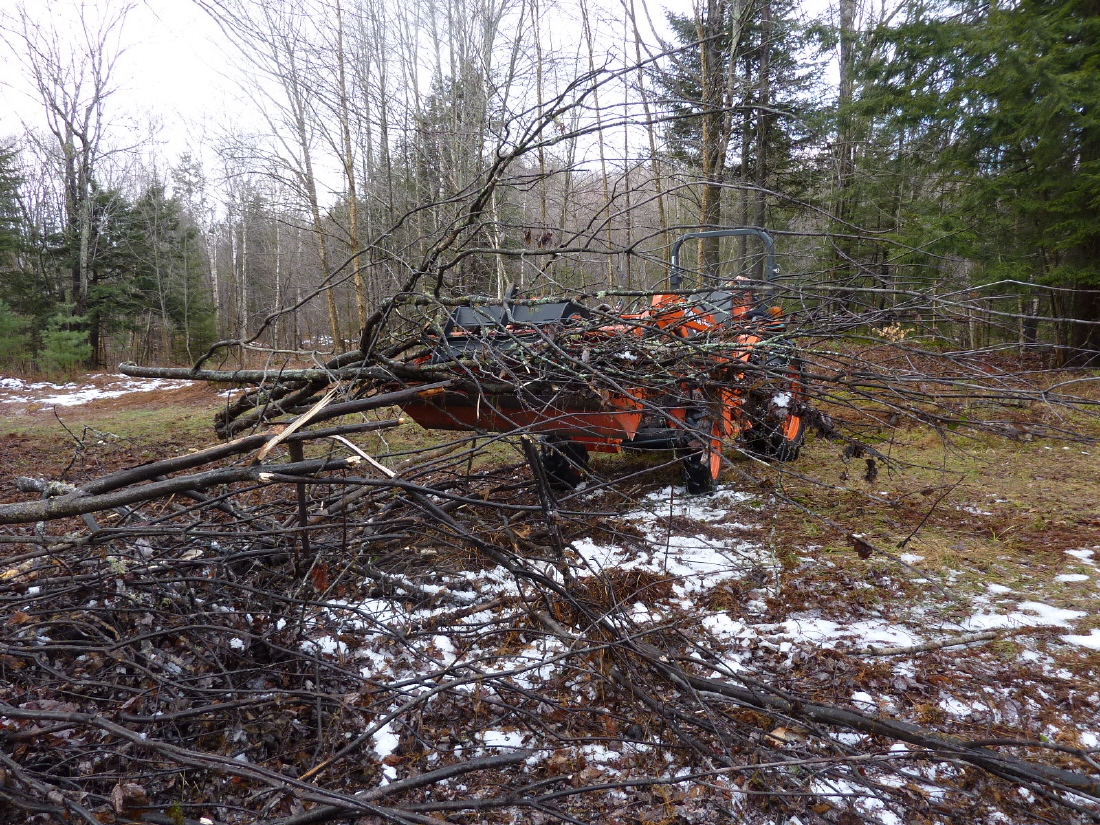

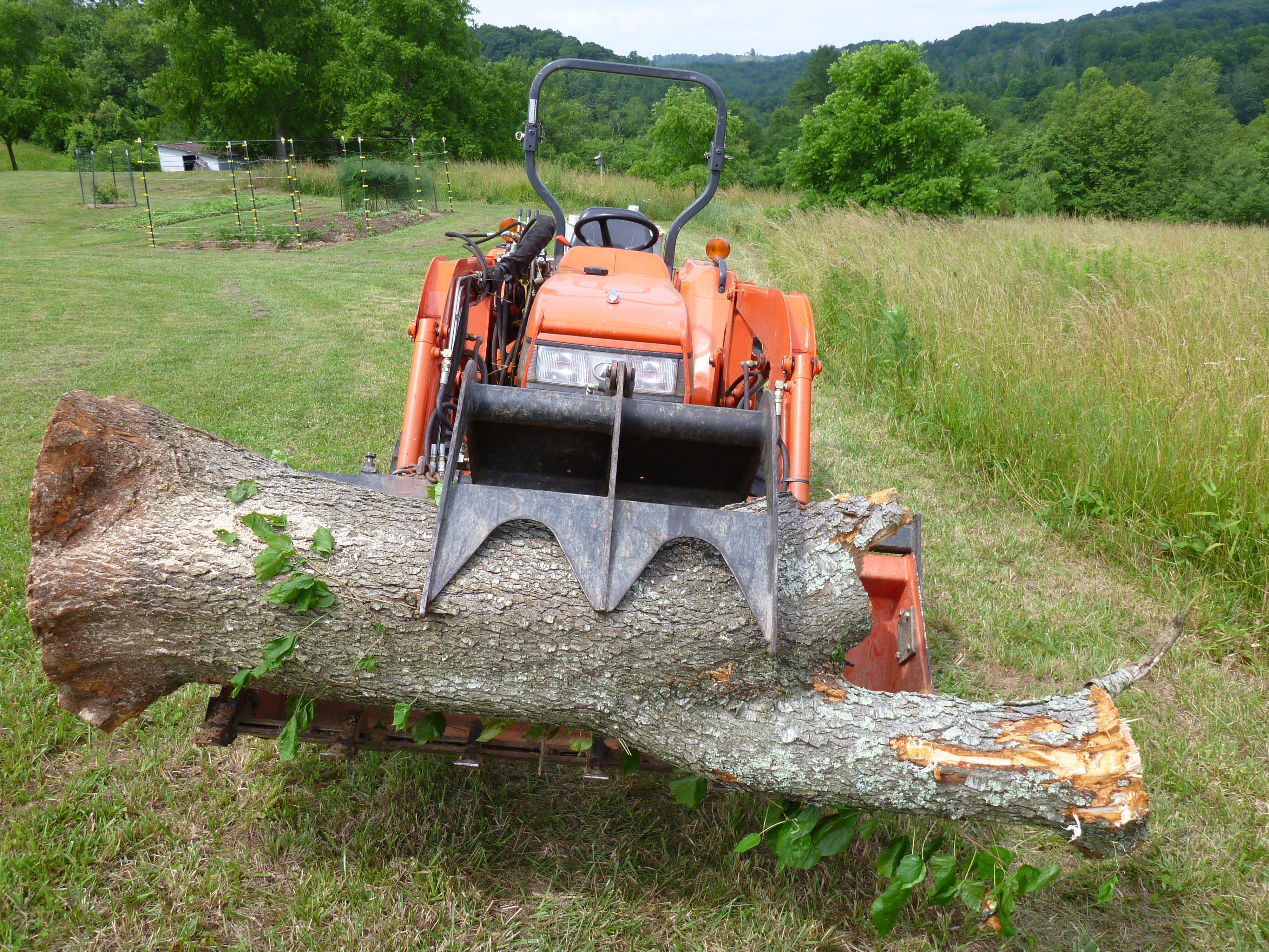

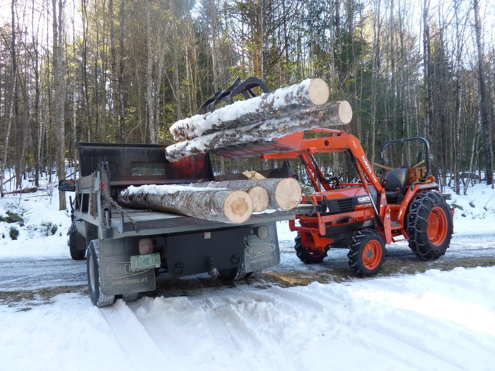

I have the same set-up as OandT's. It has served me well for years. It is on a 30 hp L3010.
EDIT: Does brush too. Can't Grab quite as much as a dedicated grapple but has no problem

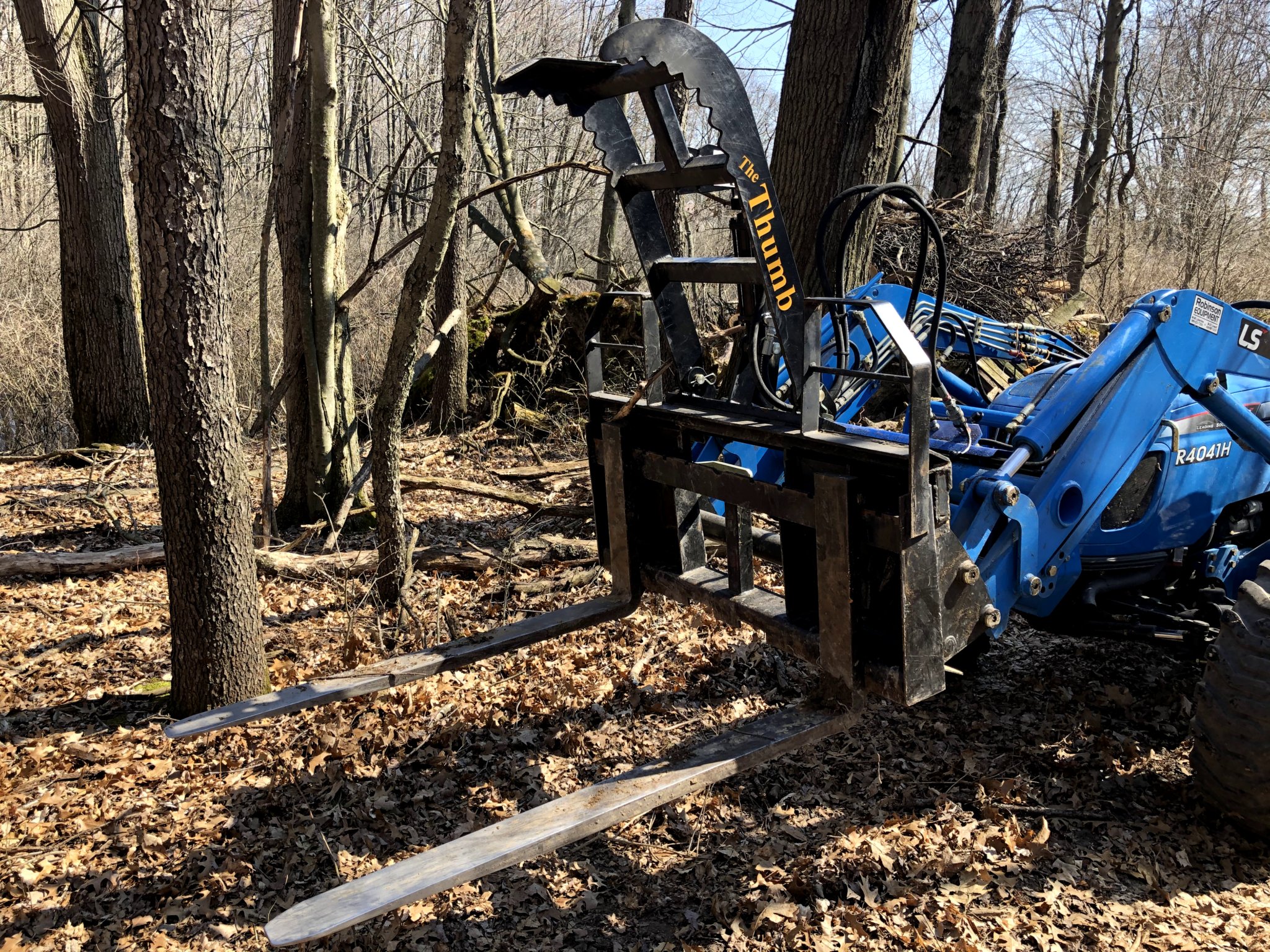

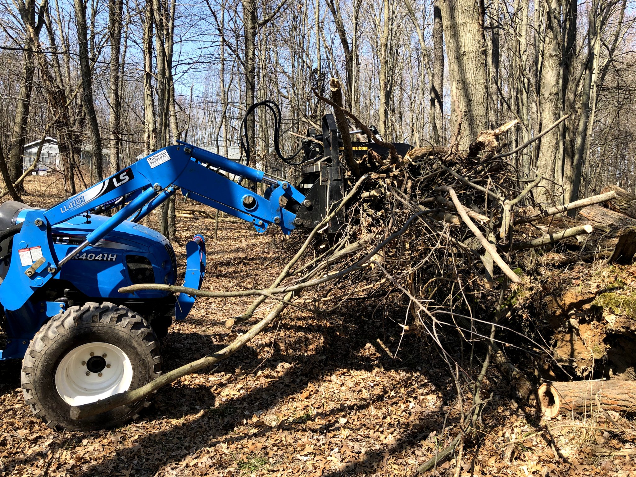

I use my thumb on the pallet forks most of the time but I can put it on my bucket with 4 bolts rather quickly.
The forks work real good if your helper piles the brush in one direction!
Sorry I don't have any pics of it mounted on my bucket.2020-04-03_15-06-05_534.jpg

Yes its a 36" . I wish it was longer sometimes, thinking about welding some extensions on it!
I always use it on the forks, haven't had it on the bucket since new.
