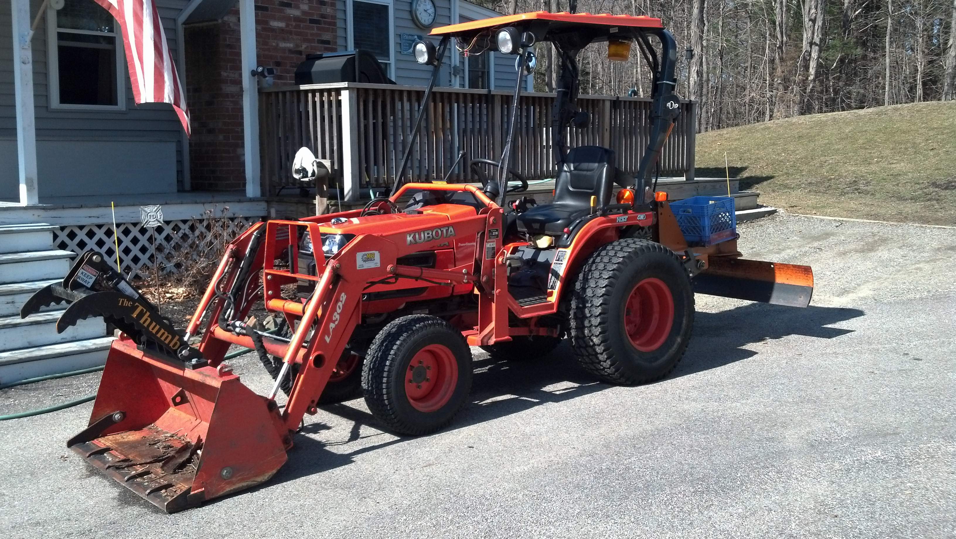

I have a bolt on cutting edge and its great. For the life of me I can't remember where I got it... Same company makes tooth bars. Its solid and was a great price.
Two bolts on the side..
I remembered where I got mine.. WR Long. No complaints. Has held up great to the asphalt and snow clearing...

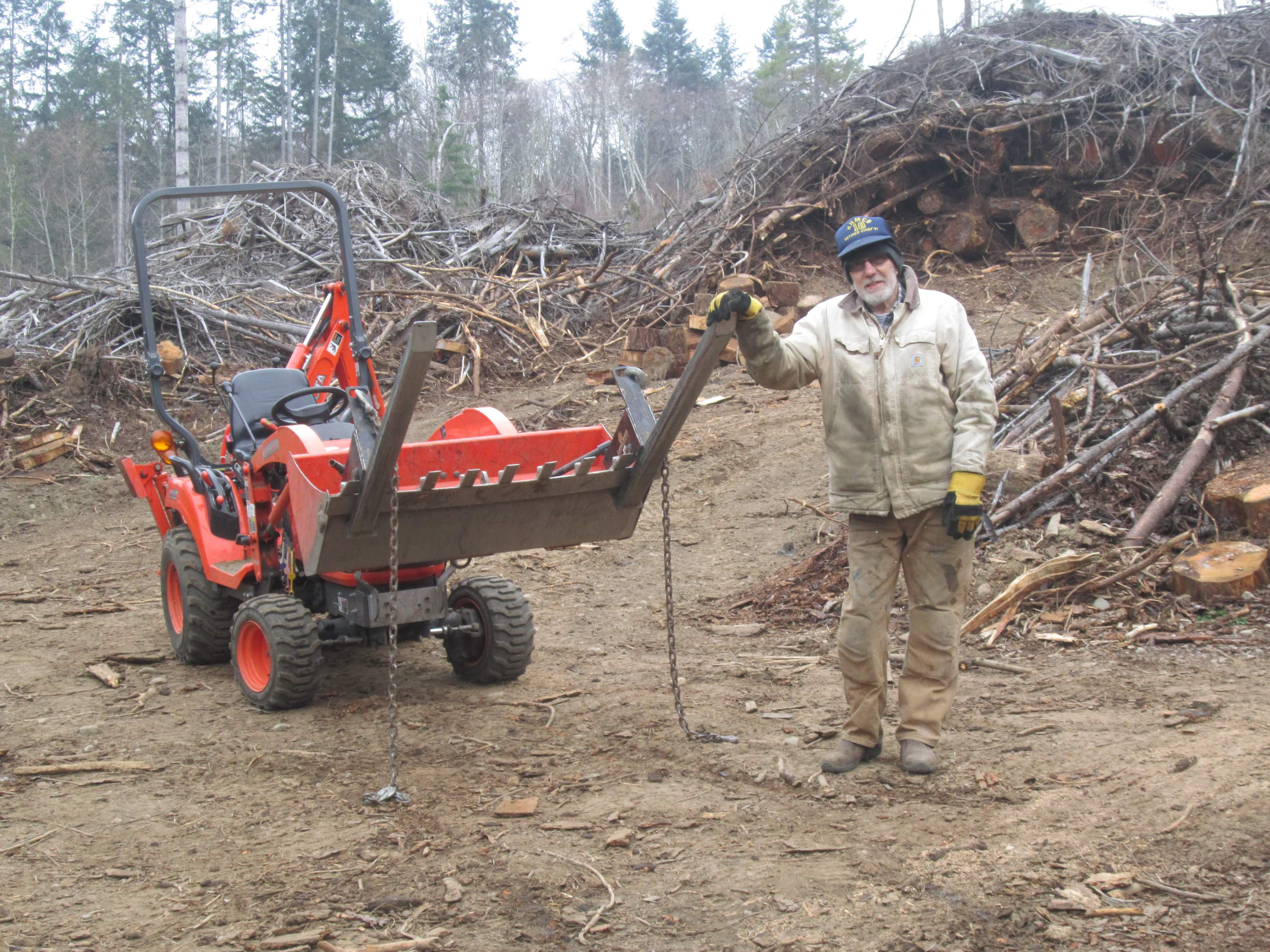

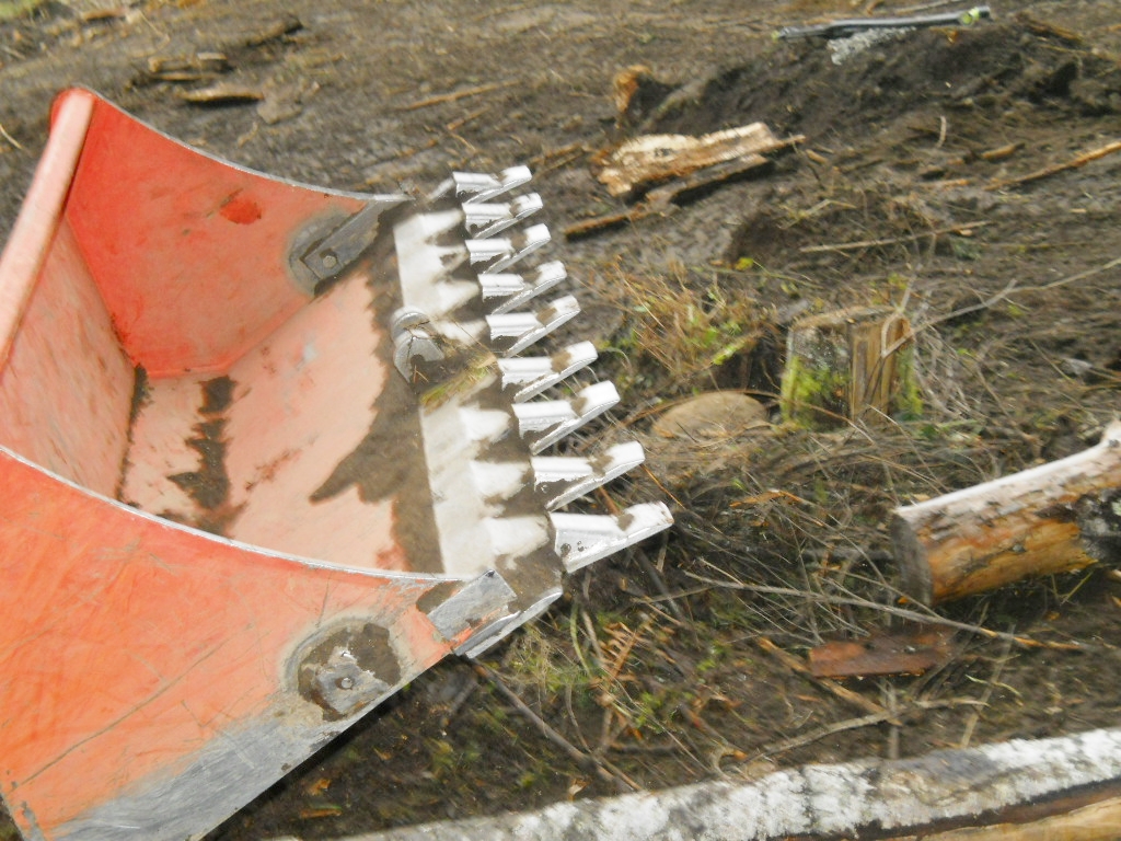

Here are some pictures of a tooth bar I made. I have not seen a commercial product that will do what these teeth will do. I can really dig with the FEL plus I spaced them so I could still use the clamp on forks. The 2 tabs in the center are to hold an attachment that is a class 3 trailer hitch. All so I do not need to unbolt the two bolts all the time. I seldom use the smooth edge anymore. The teeth are replaceable. The teeth help a lot when picking up rocks or limbs/logs.
Ron
View attachment 361416View attachment 361417
Yes Ron! Always impressive seeing the work you are done with your BX. I have a big pile of clearing debri at my place and you are an inspiration. :thumbsup:
