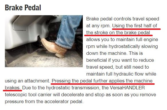

hi xfaxman, im getting the codes 50-15 and 70-28 on my v417, still have a no-go forward or reverse, ive changed out the magnet on the rear spoolvalve at bottom of cab,magnet had failed and valve would not activate,i also had not power at the valve so have put in a layout wire line,now have power to it when parking brake switch deactivated, parking brake light has gone off but the fault light still illuminated and these two codes above showed up,i cant seem to find anything about inching control,any thoughts?the 70-28 code says brake pressure failure,any advice would be deeply appreciated as id really like to get the machine mobile again

50-15 is Inching Control, out of range low.
70-28 is Brake Pressure, failure
Inching control is pressing the brake pedal slightly to decrease travel speed.
Pressing the pedal farther down applies the brakes.

I think the Brake Pressure, failure code is what is keeping it from moving. The brakes spring applied and are released by hydraulic pressure.

Found this in my V417 pictures folder from May 23rd 2020.
Might help some future info seekers:
