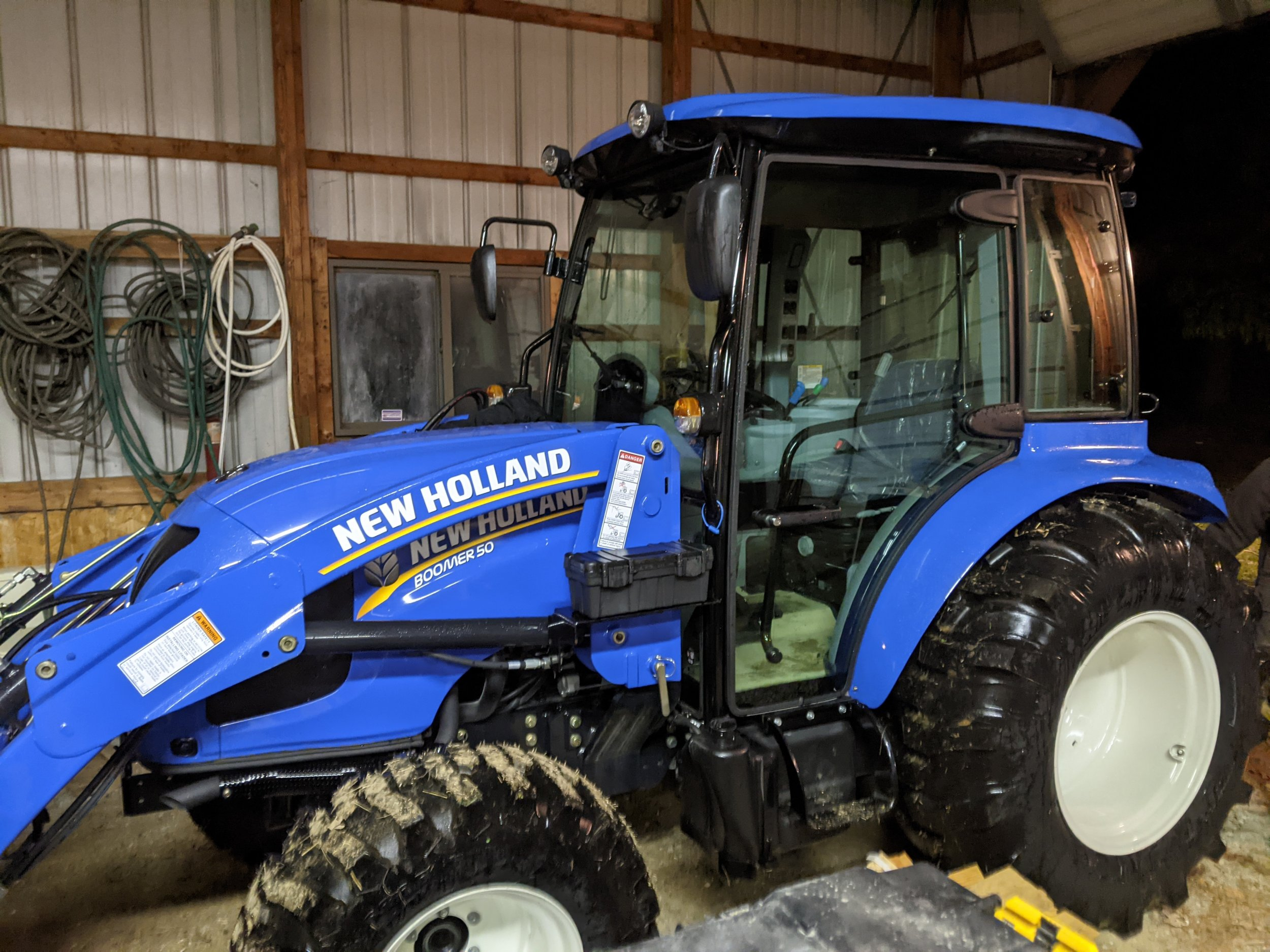

#13
They got the 3rd fx installed and hydraulic top link, delivered yesterday.
Ordered MTL RK5 60" Grapple, got lucky a few days ago and 1 unit became available for order.
/ Bobcat 2540 vs NH Boomer 50 Cab
#14
Doing some loader work to try it out and noticed the loader will not raise and curl at the same time. Is this a problem with my tractor or just a limitation of how this hydraulic system and loader are designed? If it matters it looks like they installed a WR Long 3rd fx kit.
