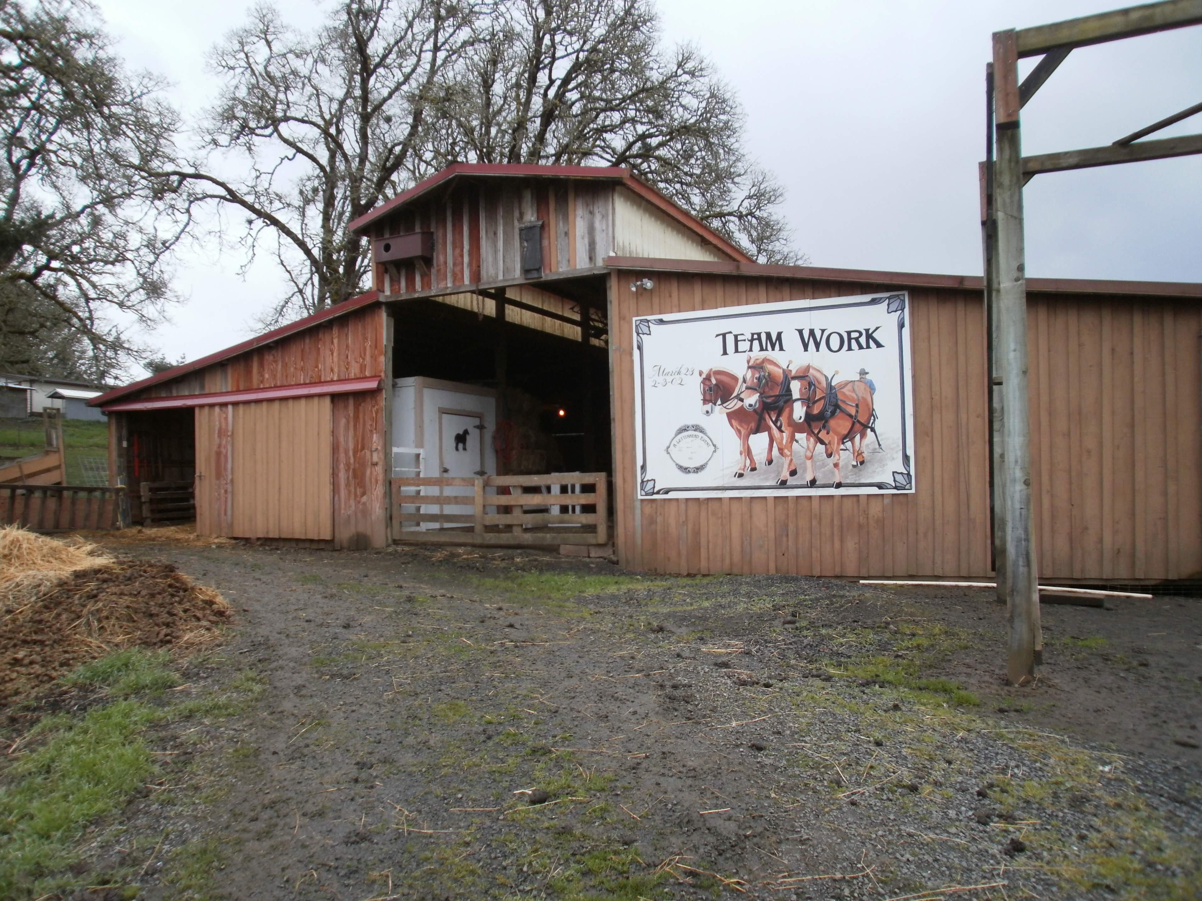

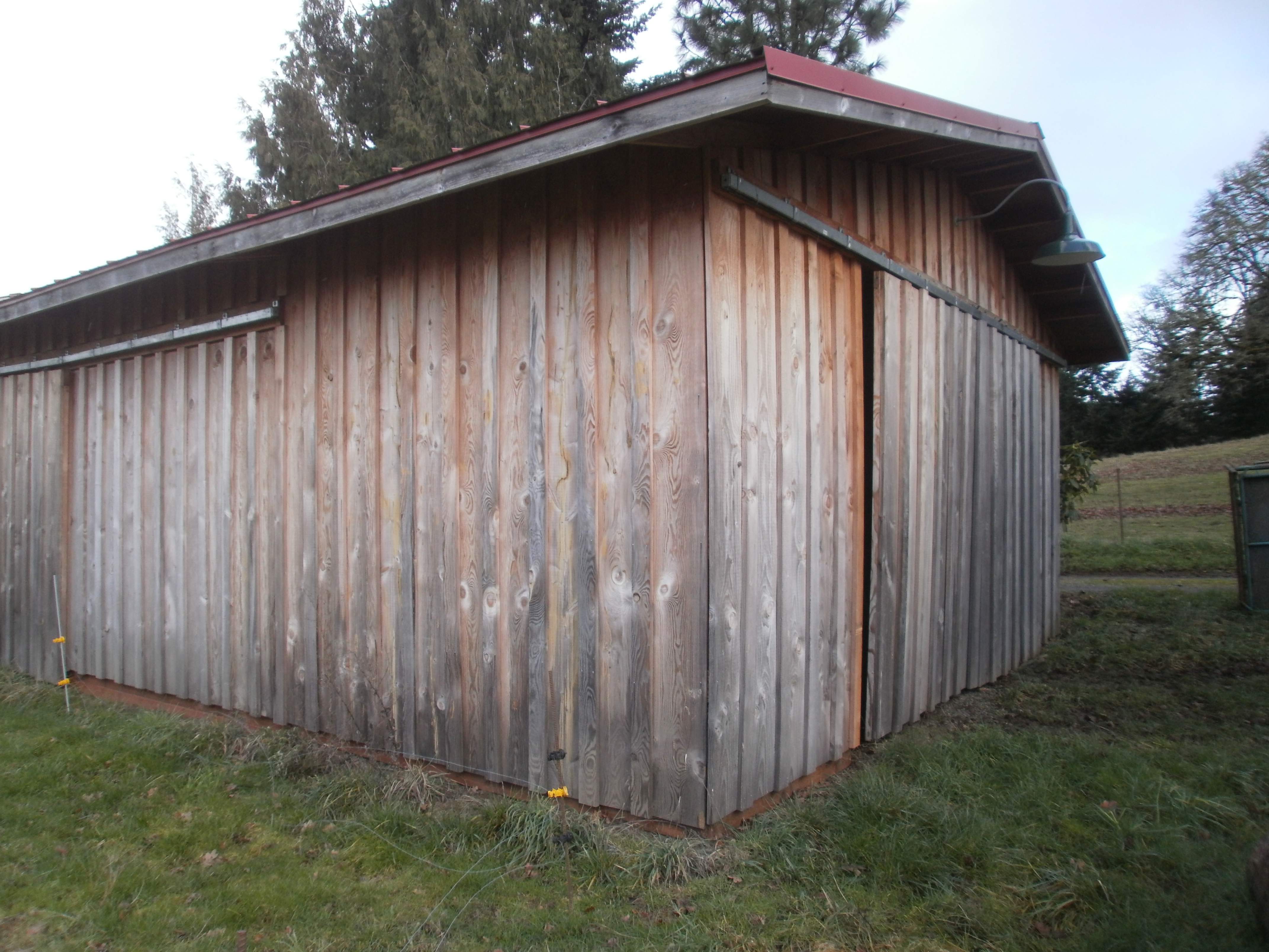

Furu is in Washington State. I am in Oregon. All my sheds and barn are board and batten. Most of them are one by twelve rough sawn full dimension Douglas Fir. One by four batts. A couple sides have full dimension rough sawn western red cedar, mostly O.G, same dimensions twelve inch and four inch.
In the Pacific Northwest it was the traditional siding and I continue to use it, in Western Oregon. It looks good, requires little maintenance, and livestock aren't gonna wreck it or stick their hooves through it.
