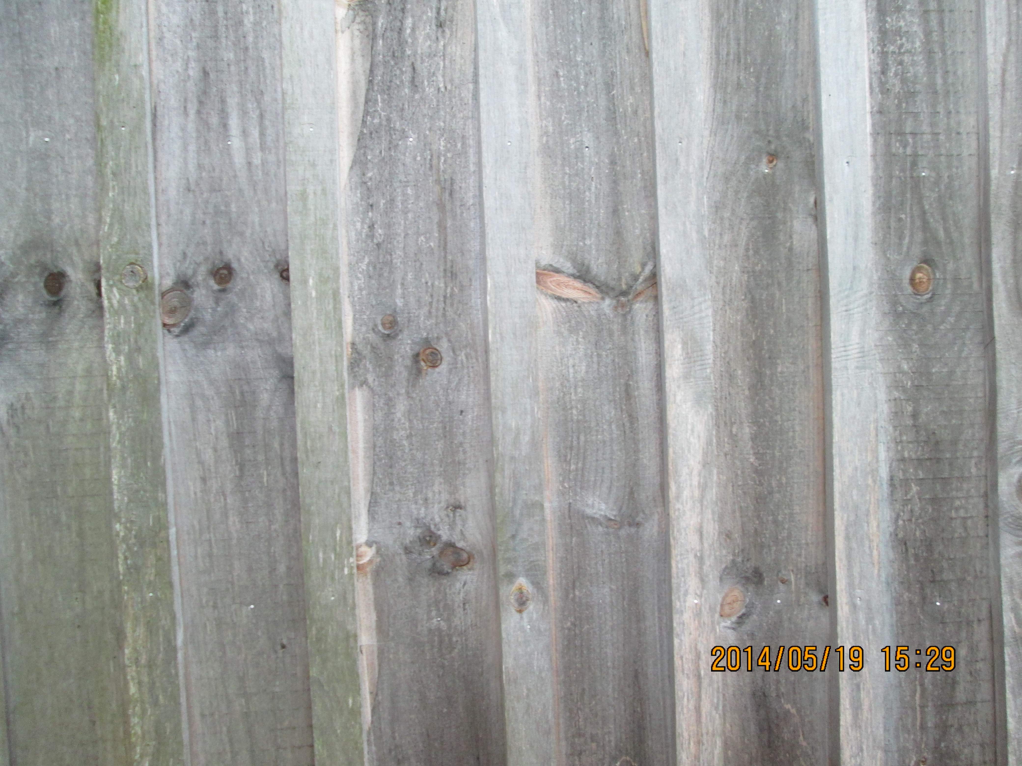

One house I lived in had 12 inch siding, with boards and "battens" of the same size, with about an inch overlap at the edges. They were unplaned, unpainted redwood.

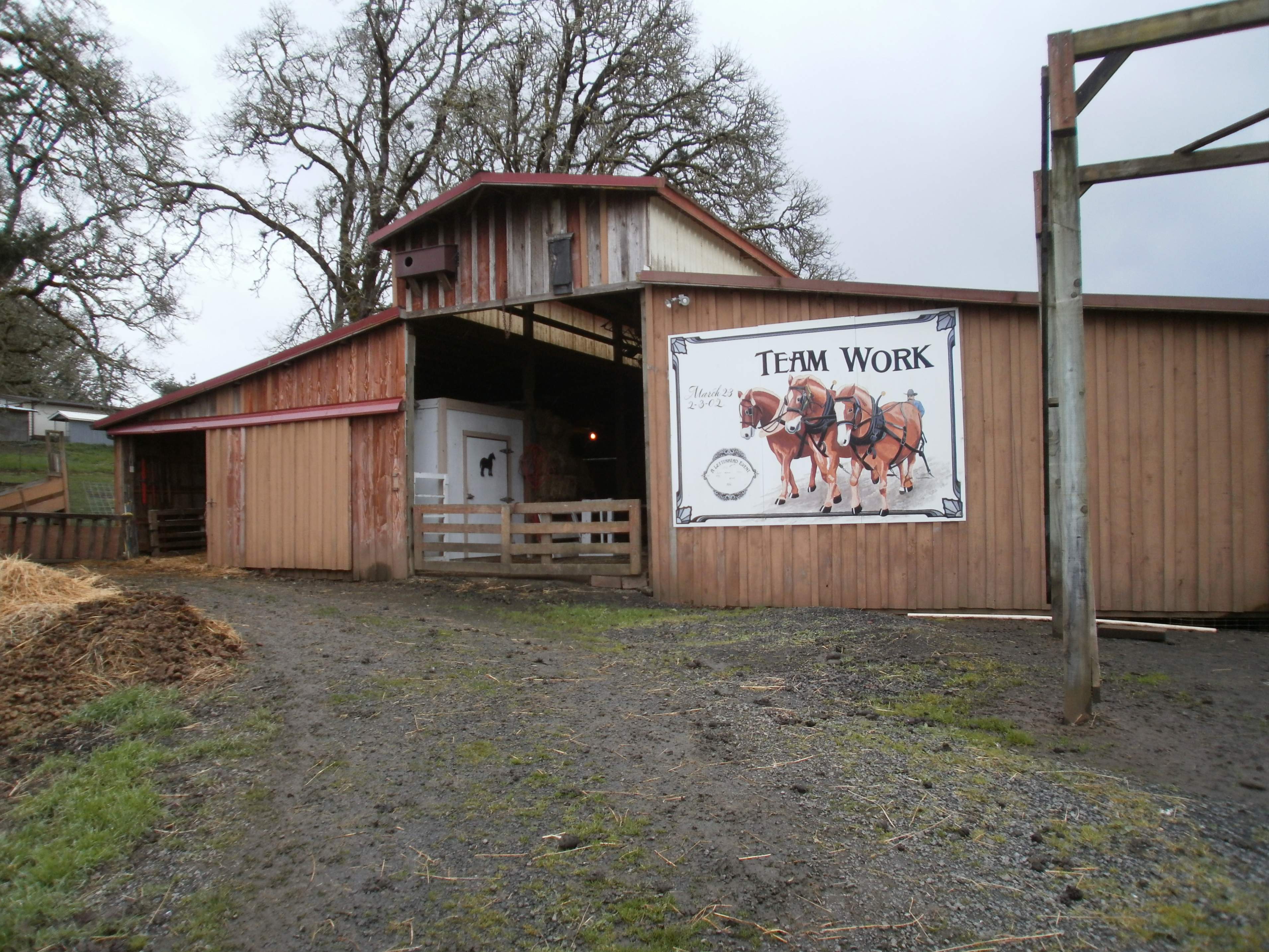

Furu is in Washington State. I am in Oregon. All my sheds and barn are board and batten. Most of them are one by twelve rough sawn full dimension Douglas Fir. One by four batts. A couple sides have full dimension rough sawn western red cedar, mostly O.G, same dimensions twelve inch and four inch.
In the Pacific Northwest it was the traditional siding and I continue to use it, in Western Oregon. It looks good, requires little maintenance, and livestock aren't gonna wreck it or stick their hooves through it.
