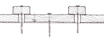

What is the normal (if there is such a thing) size of board and batten siding?
It seems that nominal 1x10 wide boards with 1x3 inch wide boards is somewhat common but just wondered what folks do.
Of course those are really 3/4 x 9 1/4 and 3/4 x 2 1/2 dimension.
Was going to do a board and batten siding on a building and trying to figure out what is the norm.
Thanks

/ Board and Batten construction #4
I like Board & Batten, it's a classical old style and I highly encourage it!
It's not used much anymore because people don't understand the nailing pattern necessary. There is a specific way it needs to be nailed, or your boards will split. Basically it's one vertical row of nails in the middle of each board, and in the middle of each batten. You have to let the wood on the left and right of each nail shrink (or expand) with each season. They must "float".
You CANNOT nail board& batten to 1/2" sheathing, sheathing does not offer even 25% if the engagement you nee to hold a board& batten nail. You have to use LONG nails, they need a couple inches of engagement or the boards will cup and pull the nails out. You need horizontal "Gurts" to nail to. You CANNOT nail wherever you feel like it, or wherever the board is cupping, because when the board shrinks, if it can't float it will split. Also consider that the battens nails have to "gap' the thickness of the boards, they are extra long. Batten nails do NOT go thru the boards, they go thru the gap between the boards. Be sure to do your research on this special classical siding technique, there's lots of info in books and on the web.
You have to really UNDERSTAND what's happening, and why the B&B method was developed. As Ron said it was developed because people had to saw up trees and nail them on the house, they had no time or place to wait for the boards to dry.

/ Board and Batten construction #12
The person who built my barn, didn't add the battens. The gap was under a 1/2''. What I did with a gap that small was cut 1/2'' thick strips from rough cut hemlock and then use a brad nailer to put them in place. Its worked great. On my field stone shed what I did was put the hemlock on and then rip a board into a 1x3 and then use that to cover up the gap. I left more space.
Forge, what you did is risky. If the boards swell, and you plugged up the gap with a strip, they could cup, and pop the nails out. Maybe you got lucky, it's just risky to g1ve the wood no place to go like that. I wooda recommended you leave that gap and cover it with battens because I like B & B!:cool:
The diagram shows how to nail properly. The boards normally shrink, note that the nailing allows the boards to shrink, (or swell into the gap). The gap between the boards is there for 2 reasons; if the boards swell then the gap lets them without 'cupping' and working the nails out. Note how it allows the batten nail to pass thru without touching the board, and thus splitting it (when the board shrinks). Note how long the nails are, nail grip is important.
Boards can shrink or expand with the seasons, this happens every year. Battens don't change much, it's the boards you have to worry about. Typical B&B uses as wide boards as possible, this is to reduce the number of boards and speed up construction. If you have a small building you can use narrower boards, and risk of splitting becomes less too.

/ Board and Batten construction #13
I didnt plug them, the strip overlaps like in your second picture, but I have not had one split and they have been up for over 10 years. I think the trick, or how I got away with it was using long air brad nails.
