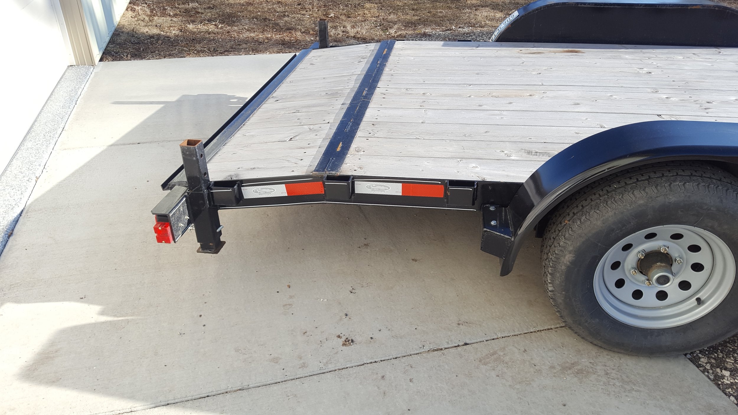

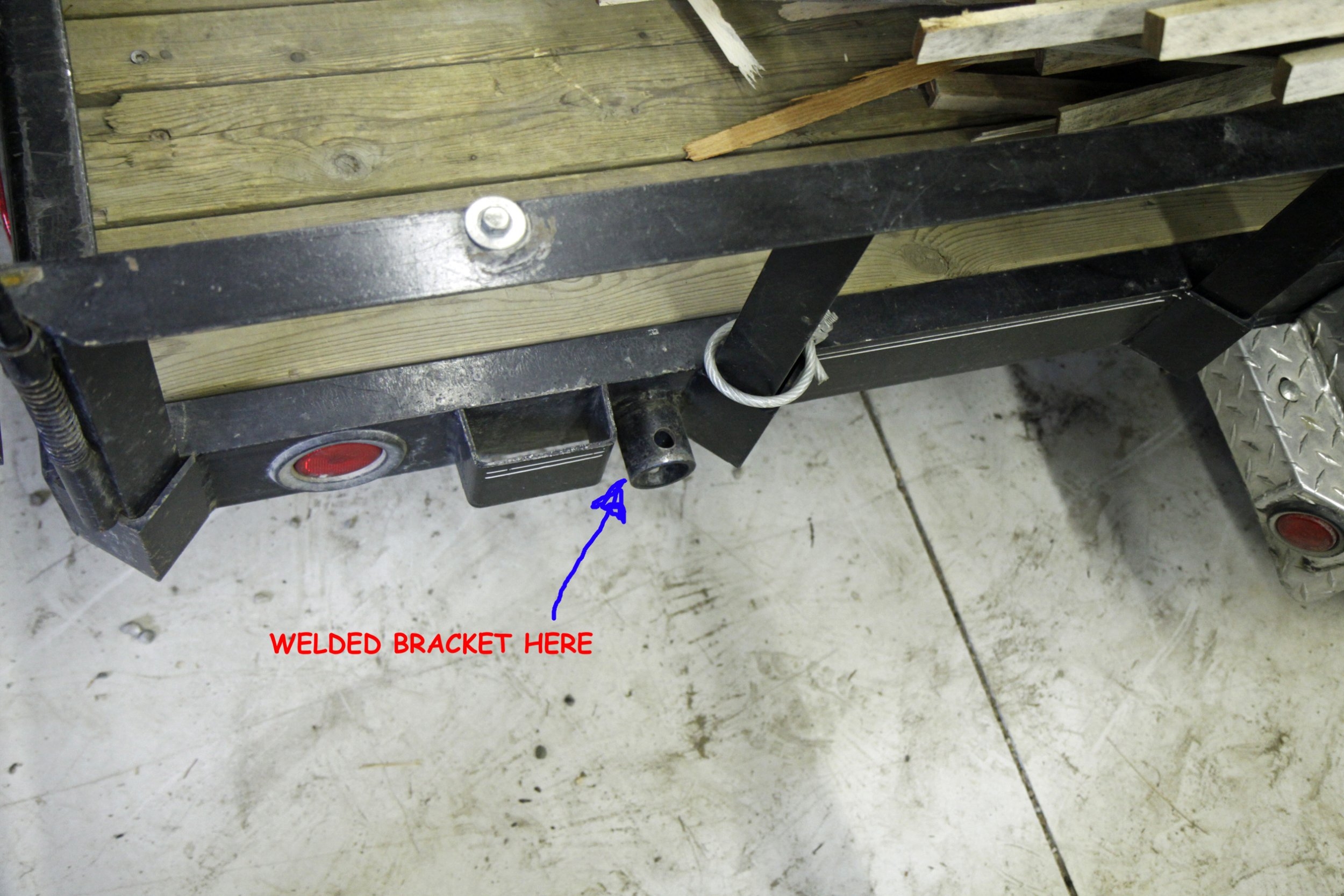

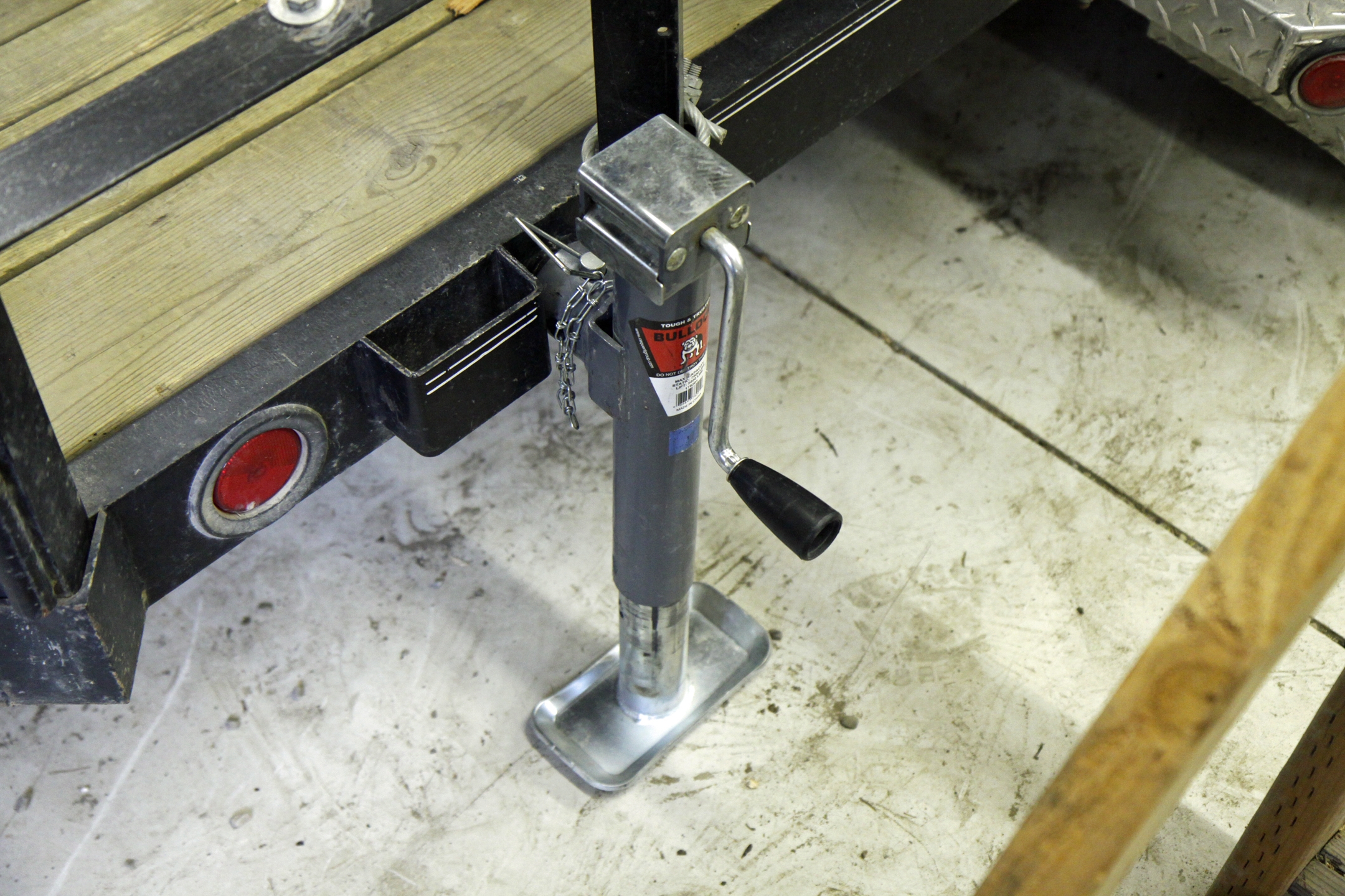

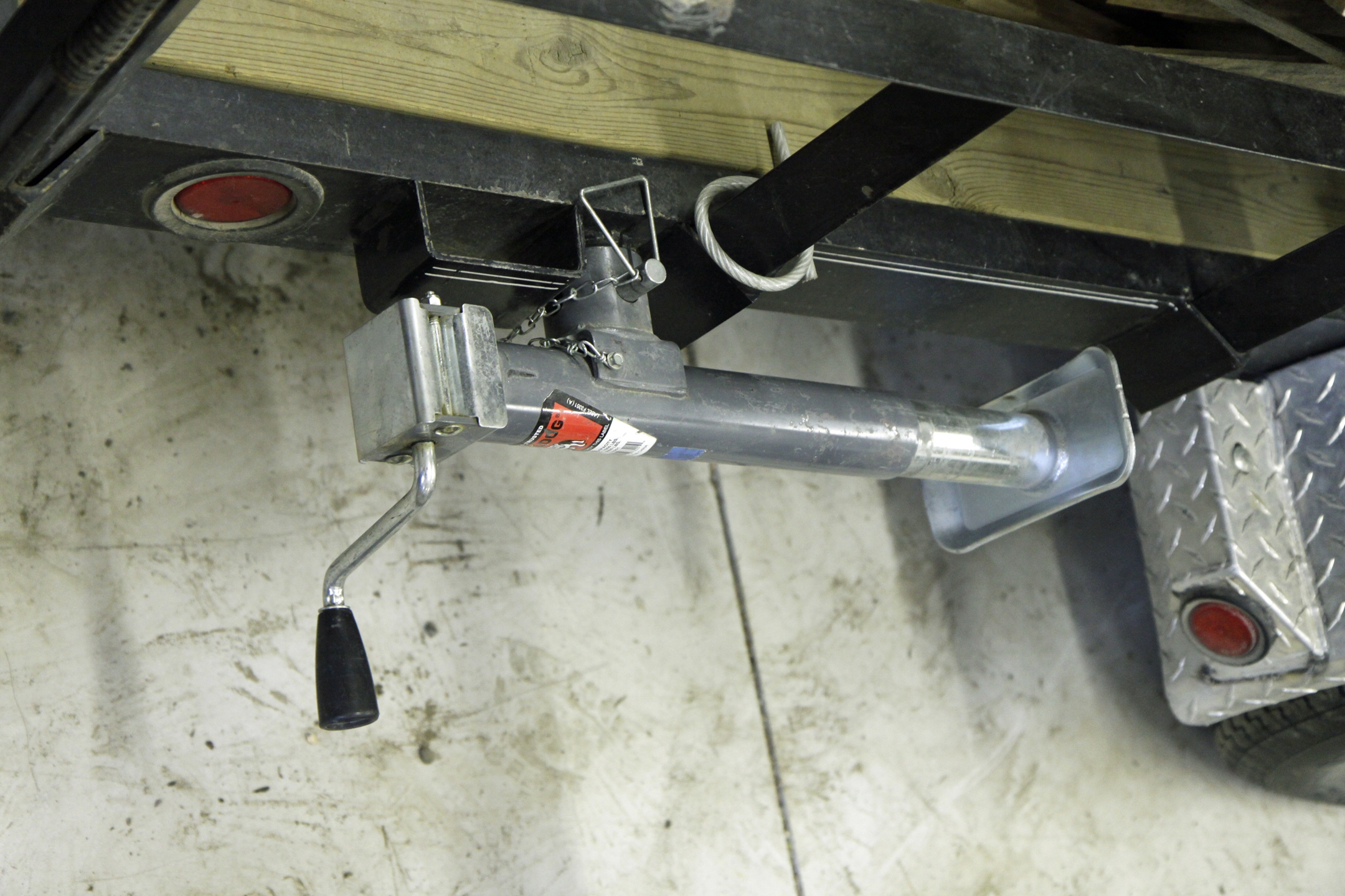

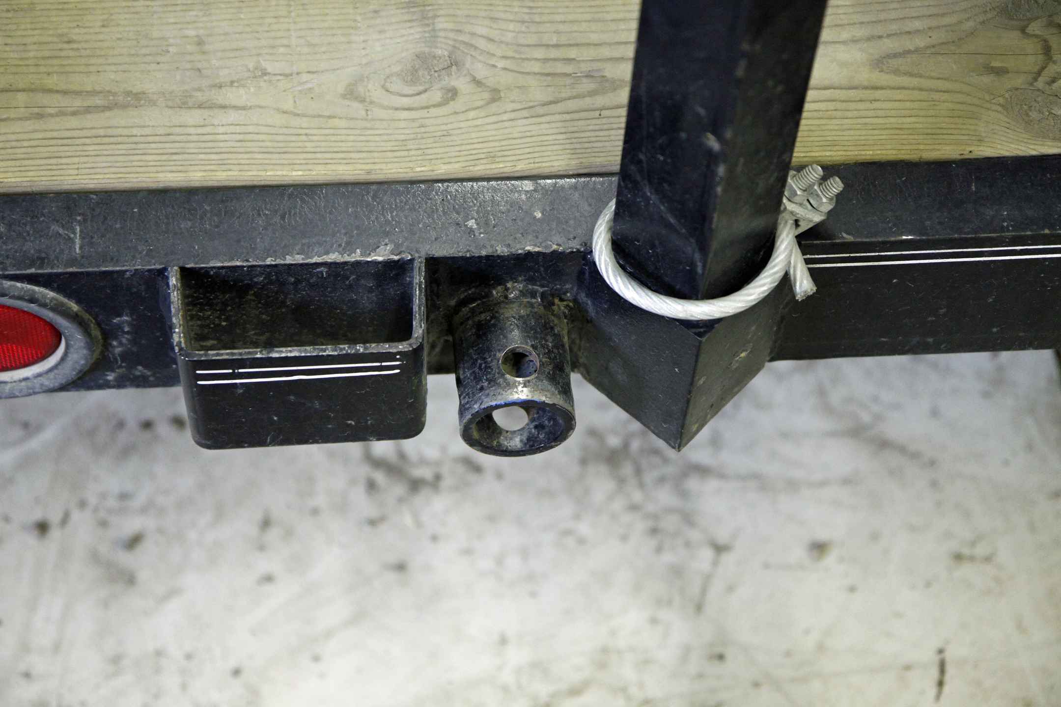

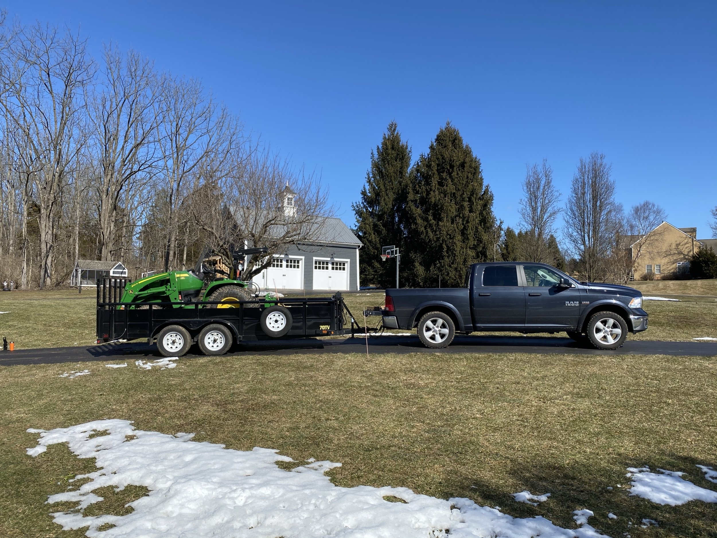

Add 2 trailer tongue swing jacks. i did this years ago for my old ramp trailer. my new trailer is tilt bed.
I did something very similar, but home-made, with 2" perf square tube inside 2-1/4" perf square tube, and a welded foot plate on the bottom. Use a pin to set the height.
I don't have any close-up photos without going out to the trailer right now, but you can see one on the rear of the trailer in this photo, if you zoom in a bit.

I put these Pro Series Round, Pipe-Mount Swivel Jack w/ Footplate on the back of my flatbed trailer. I've towed some skidsteers, and my NH TC40 with loaded rear tires. Makes it much more stable when loading; I have had my truck move before while loading... These are easy to install, easy to use, and easy to stow when not in use.

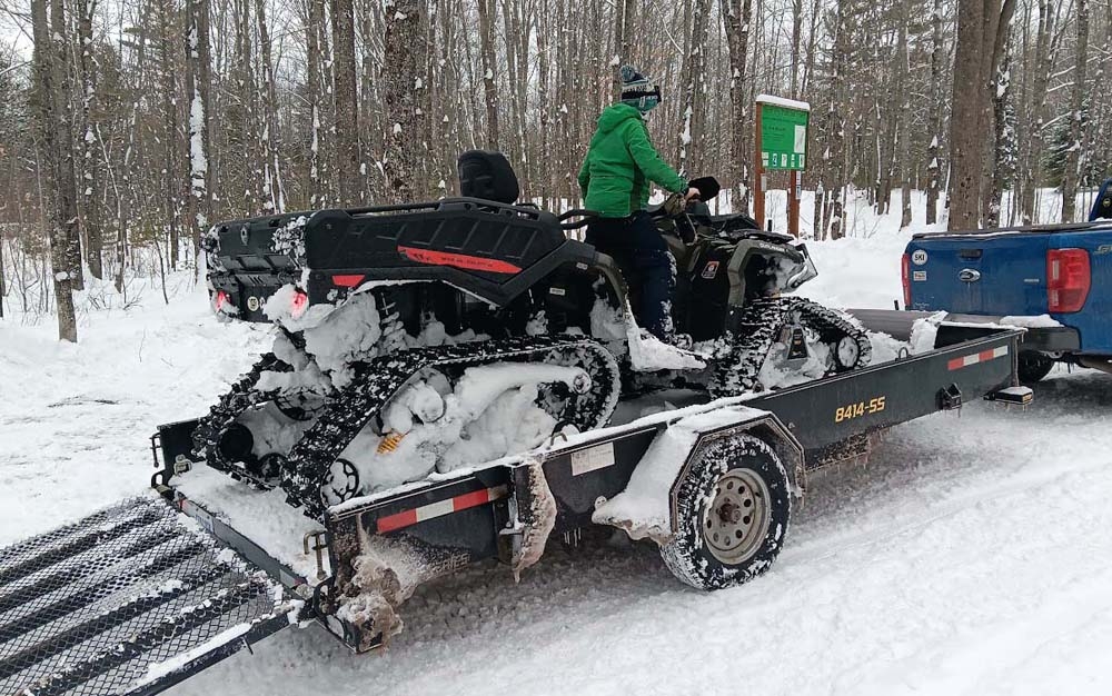

I drive our 6x6 on it now without the truck attached. Should I quit? (attached here)
   / Block rear of trailer or not? #30
Nice machine!
I know loading a 4x4 is a lot safer than loading a 2 wd unit, but I have no idea on tracks! Only tracks I have ever loaded were steel on steel and those required care and a soft touch to the controls!
When your trailer is un-hooked, what keeps it from rolling (besides being frozen to the ground!)
A trailer that gets loose without a tow vehicle to stop it can be dangerous!
David from Jax

When I drive our 6x6 onto a unattached trailer, the ground is flat, wheels chocked and the rear of the atv wheels are still on the ground when the hitch goes up, then you inch forward to let it back down. Rear tracks or wheels are still on the ground as it settles back down. I Rarely DO THIS since its not much fun to do. Point is you can.
