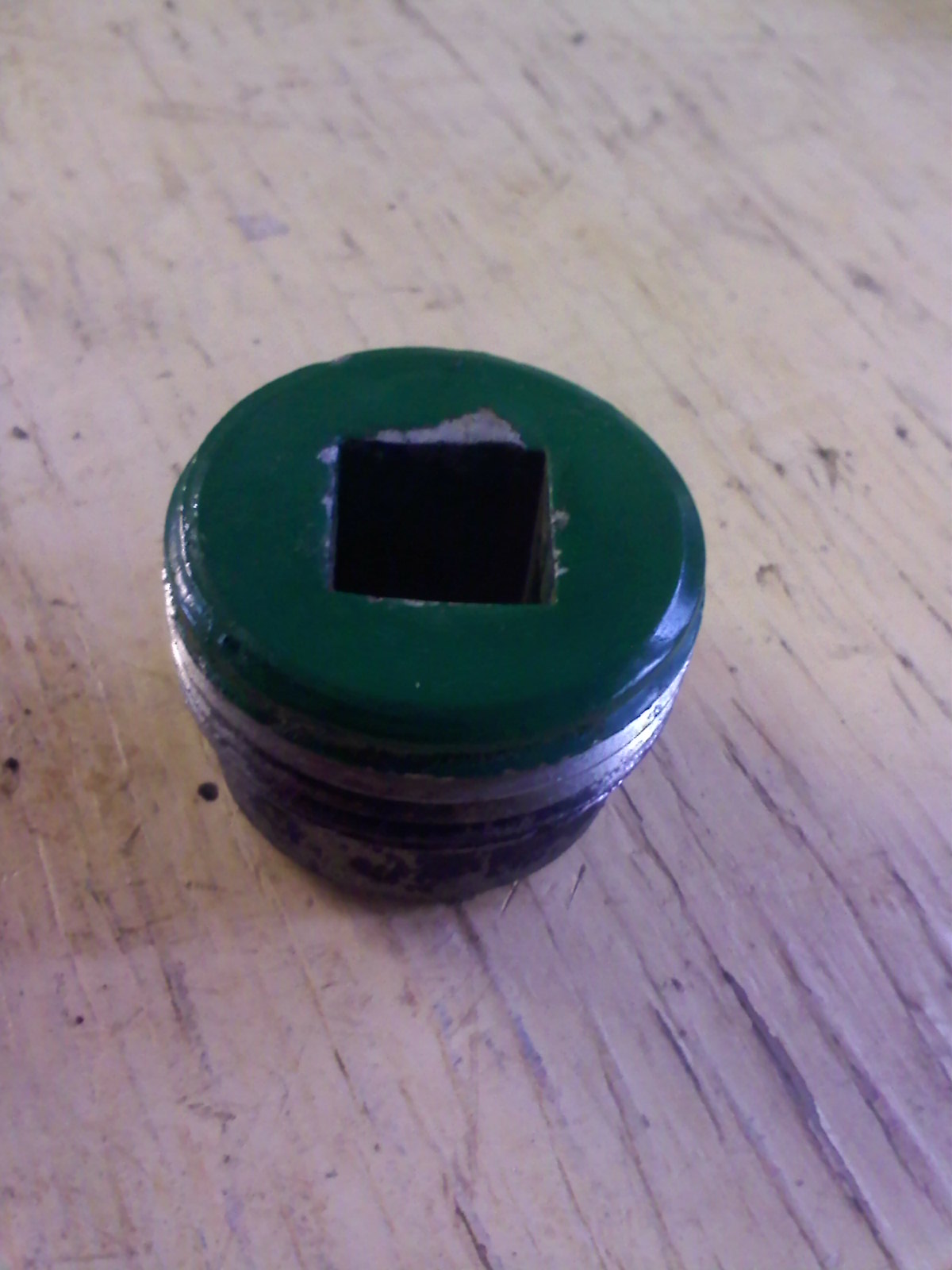

I purchased the block heater from John Deere in December 2010. It was PN:AR87167 for the Yanmar 3TN82-RJK engine in my JD770. I tried to find an aftermarket on the internet but wasn't 100% sure any would fit my specific engine so I just purchased it from JD for $80 (heater & cord) to save myself some potential grief.
I used a 1/2" drive ratchet and extention along with a 3' breaker bar to remove the threaded plug. If you notice from the pictures, the 1/2" drive fits directly into the plug. I was lucky - my plug broke lose with only slight pressure on the breaker bar. Some plugs are really hard to break loose even if the tractor is new.
There was enough room (barely) to remove the plug and install the block heater without removing the hydraulic line. I didn't drain all the coolant - I just removed the plug and let the coolant drain down to that level in the block. I captured the coolant in a 5 gallon bucket and poured it back into the radiator (using a clean t-shirt for a filter) after the block heater was installed. Don't forget to use a sealant on the threads of the block heater before you install. I had to use a wrench to tighten down the block heater instead of a socket because of the hydraulic line. It was tight, but it worked.

Thanks for the information, I did figure the 1/2" Breaker Bar end into the plug however this one is going to give me a run for the money so-to-speak, my 790 is an '04 and it's frozen. With regards to installing the Heater Plug, I noticed it would take a 36MM socket that wouldn't fit into that tight space, did you use an adjustable plyer to hand tighten it as much as possible after applying the thread sealent? Good info on the coolant.
