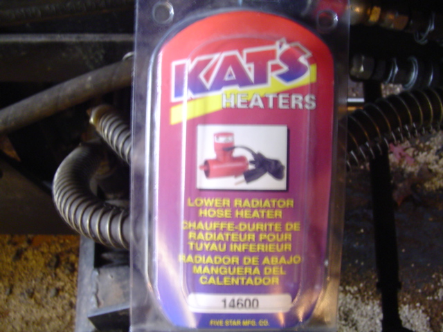

I found a Katz for 19.00 at autozone. Know of any place cheaper?
If anyone knows the hose diameter for this? I think it's 1 1/4 but not sure.

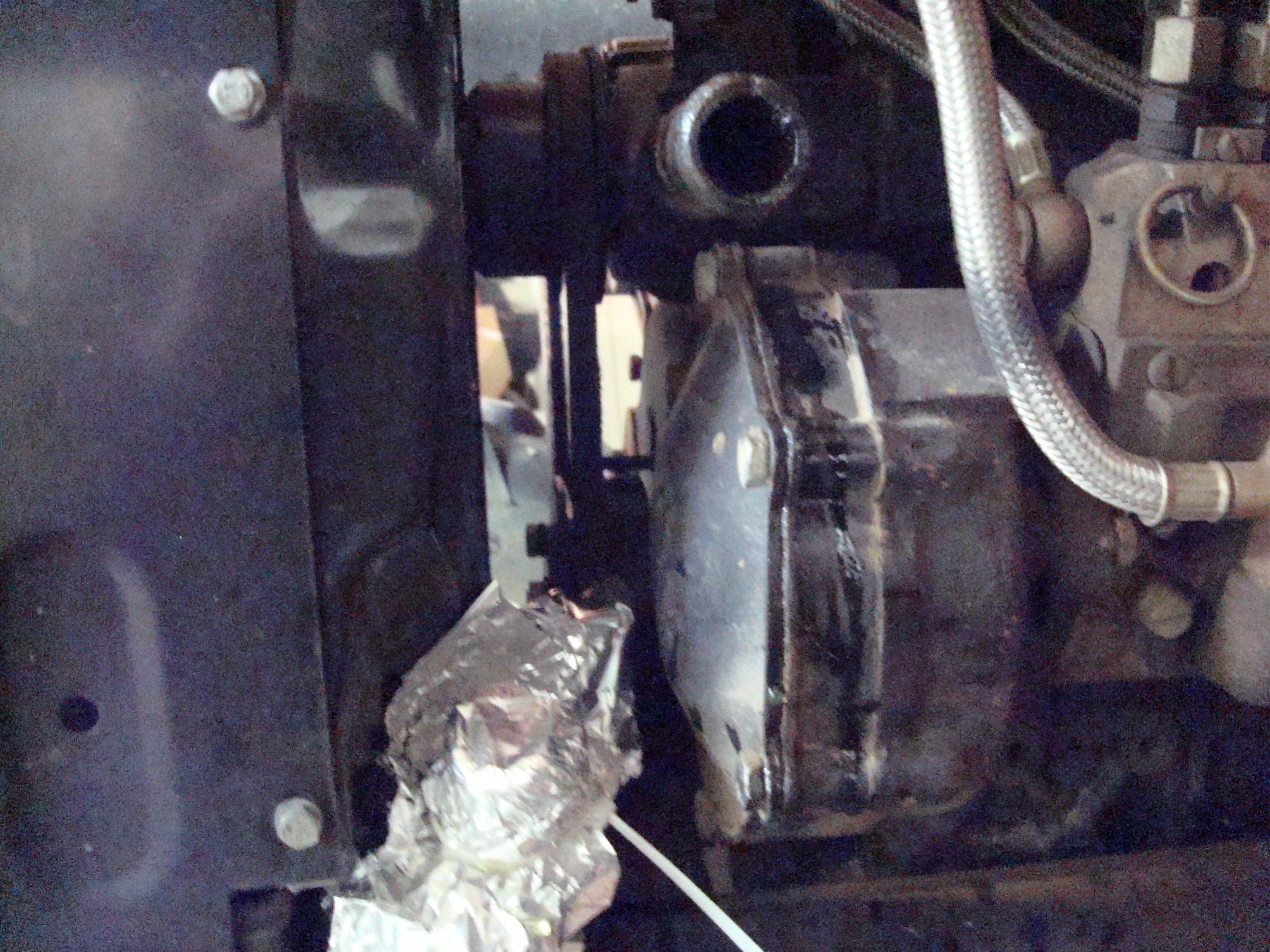

That is a good price. Mine was a 1 1/2" on my Jinma 254. Here is a pic with the part #.
Chris

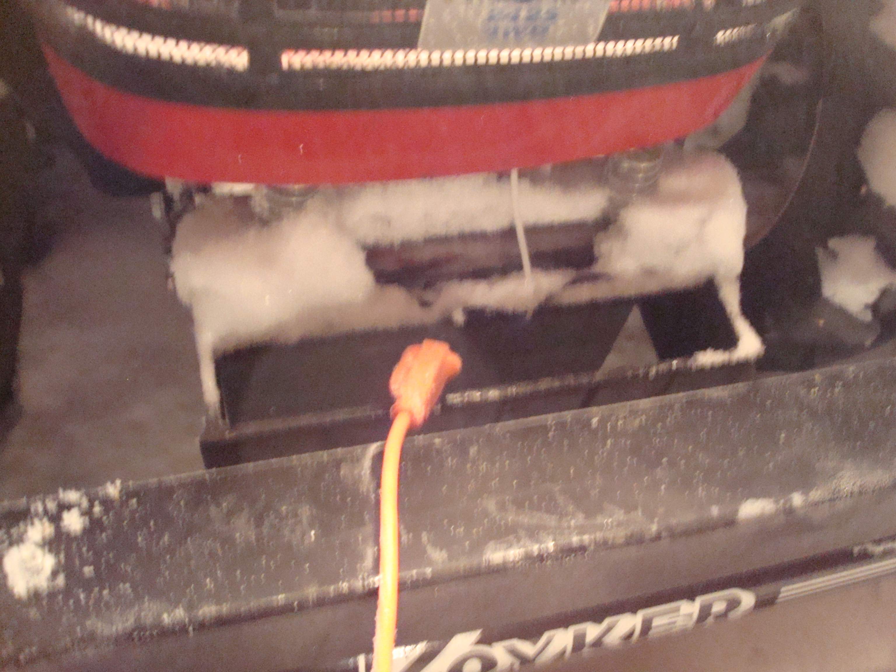

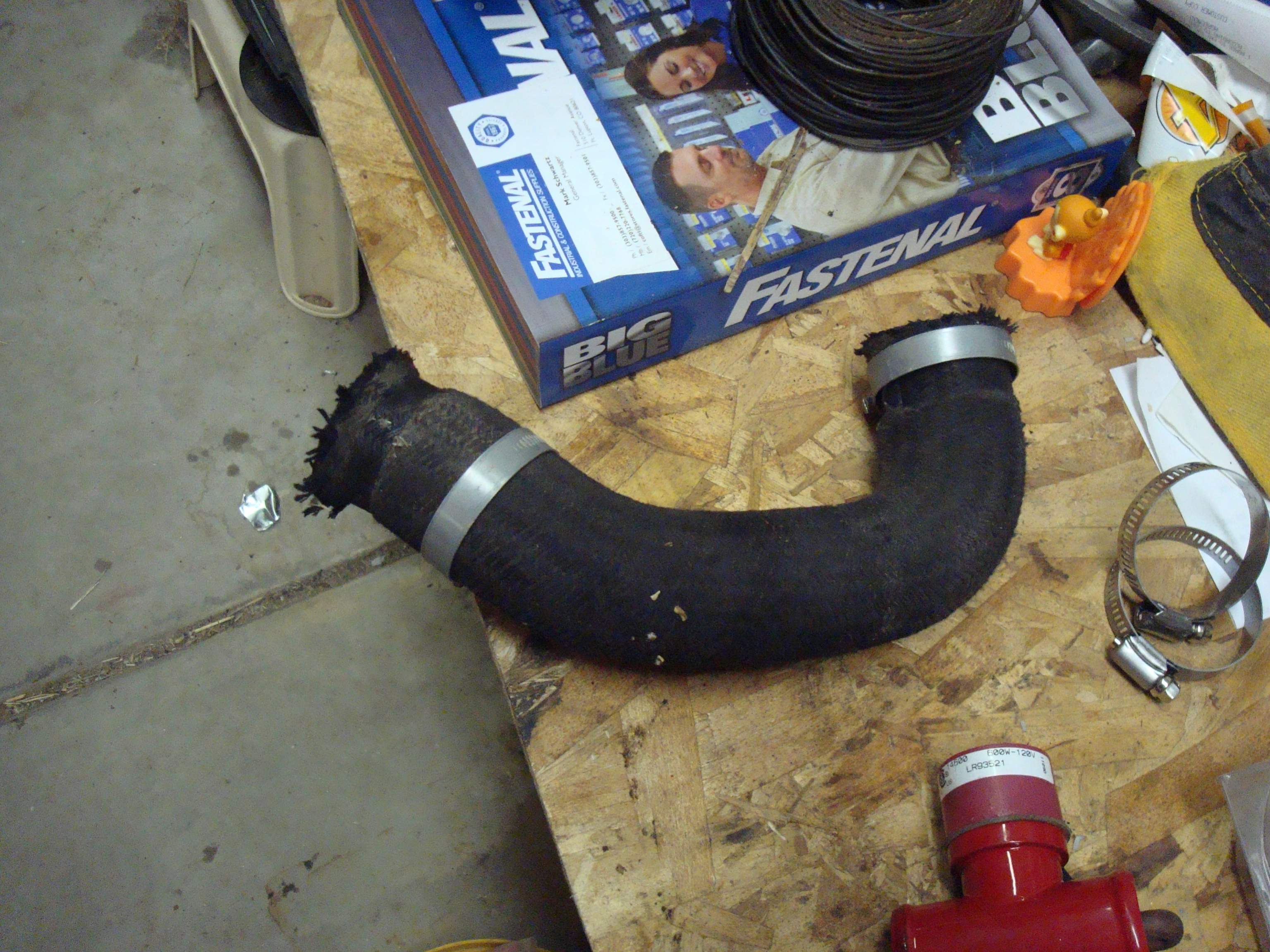

/ Block Heater install
#9

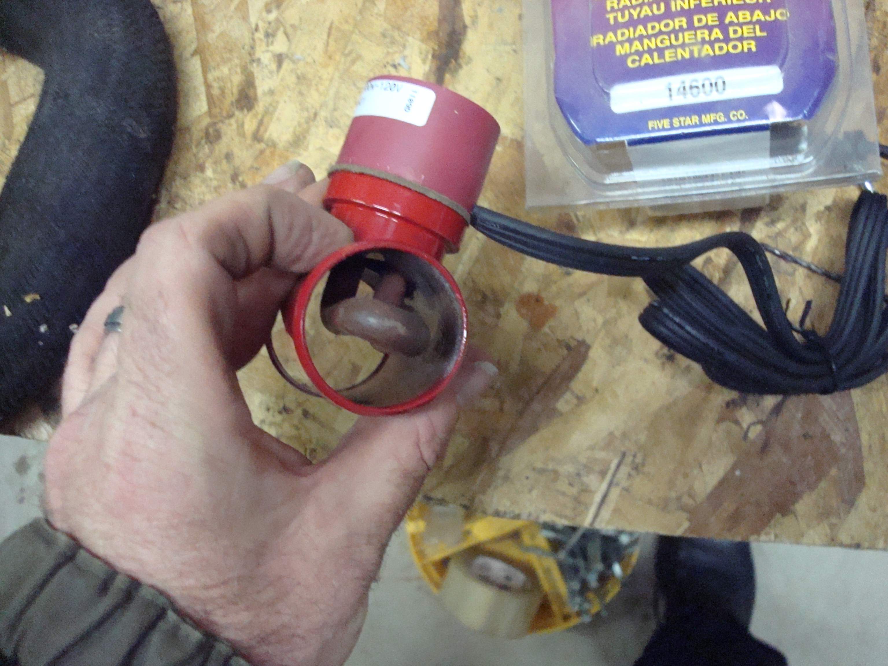

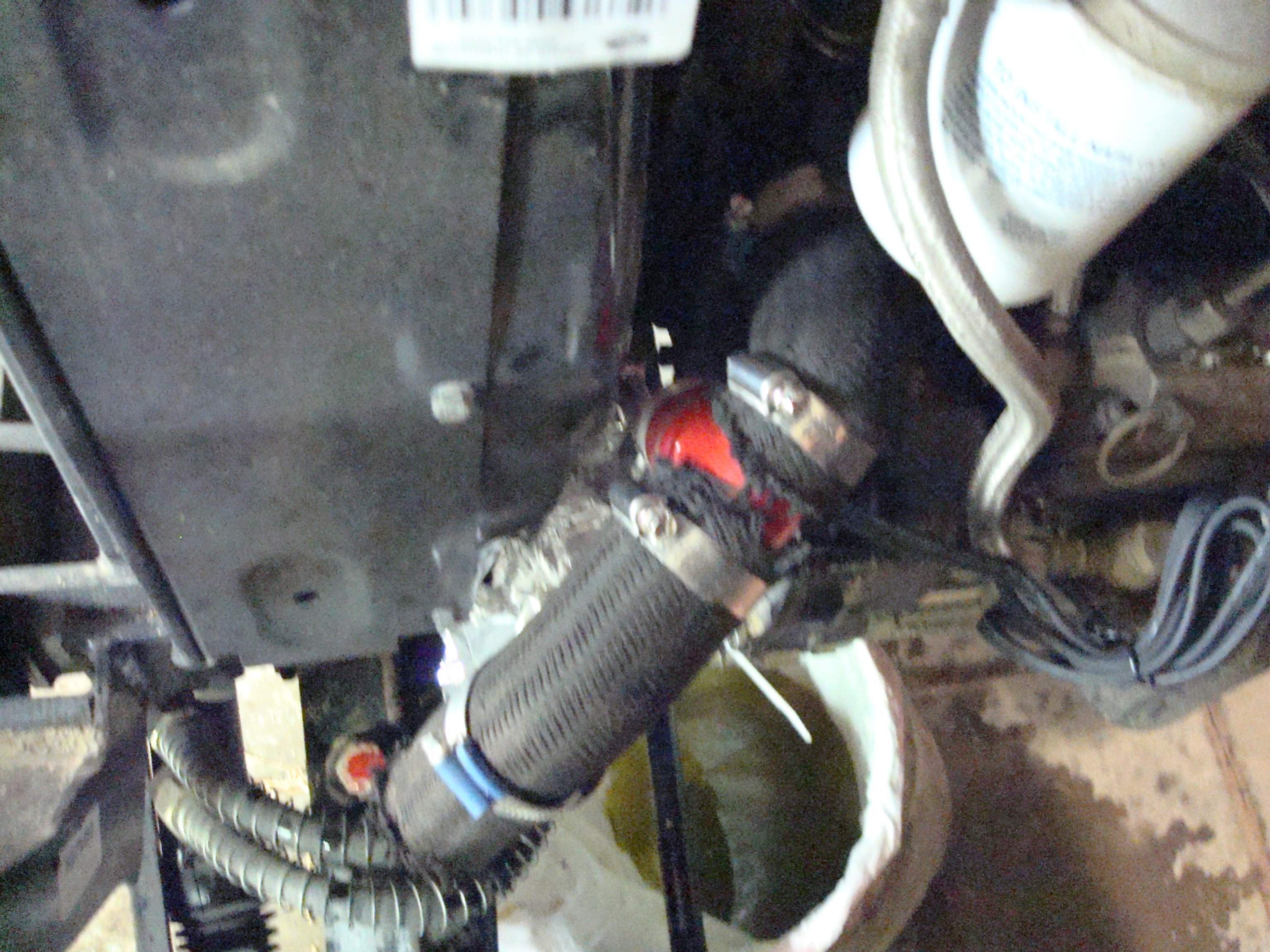

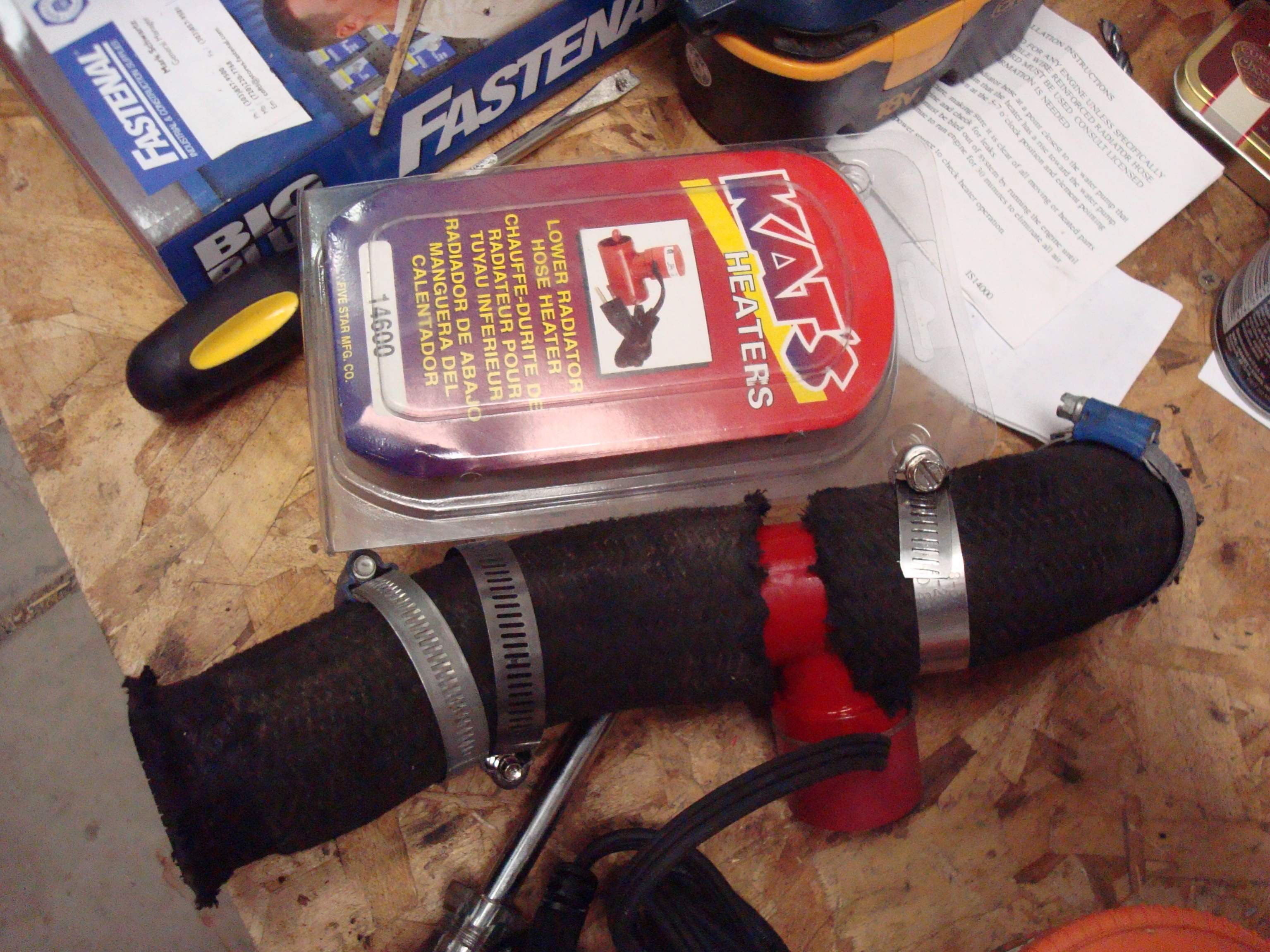

Thanks for the 1 1/2 tip it really helped. Got it installed over the next night. It was easy to put in. I just needed to rethink the overall position of it. I have pictures to add. I did not even have to drain the system. I just used some aluminum and speed ties on the ends. I put a plastic bag in a bucket to catch the fluids(that way it was clean and I could lower my cost. I just changed out my fluids during the summer.
The end result. Snow and 14 the next night. She started up on the first try.
/ Block Heater install #11
...lower my cost.
That mindset all too often ends up costing more money in the long run. I've found that it doesn't pay to be cheap when it comes to maintaining (what I consider to be) a major investment. Having had quite a few years experience with Chinese rubber already (hoses/belts/tires), I strongly suggest you start saving now - for a new set of radiator hoses. Put them on the shelf as spares for now, you'll need them soon. May as well buy an extra gallon of anti-freeze too. Odds are you're gonna lose what's in there now.
While we're at it, does your engine parts manual indicate whether or not yours is a wet-sleeved or dry-sleeved engine? All 4 Chinese tractors I've owned were wet-sleeved, which means that a SCA type anti-freeze should be used. Cheapest around here is Final Charge 50/50, about $9/gal at Walmart.
//greg//
#12
It's good to get a warning about things. I will probably replace the hoses and belts over the summer. But for now it works. I used prestone this last time and just got the regular and mixed 1/2 water with it.
The funny thing was over the weekend I was so glad that it took a shorter time to warm up then usual, that I pulled out of my shack and took out the front post with the loader. Now I need to replace it.
