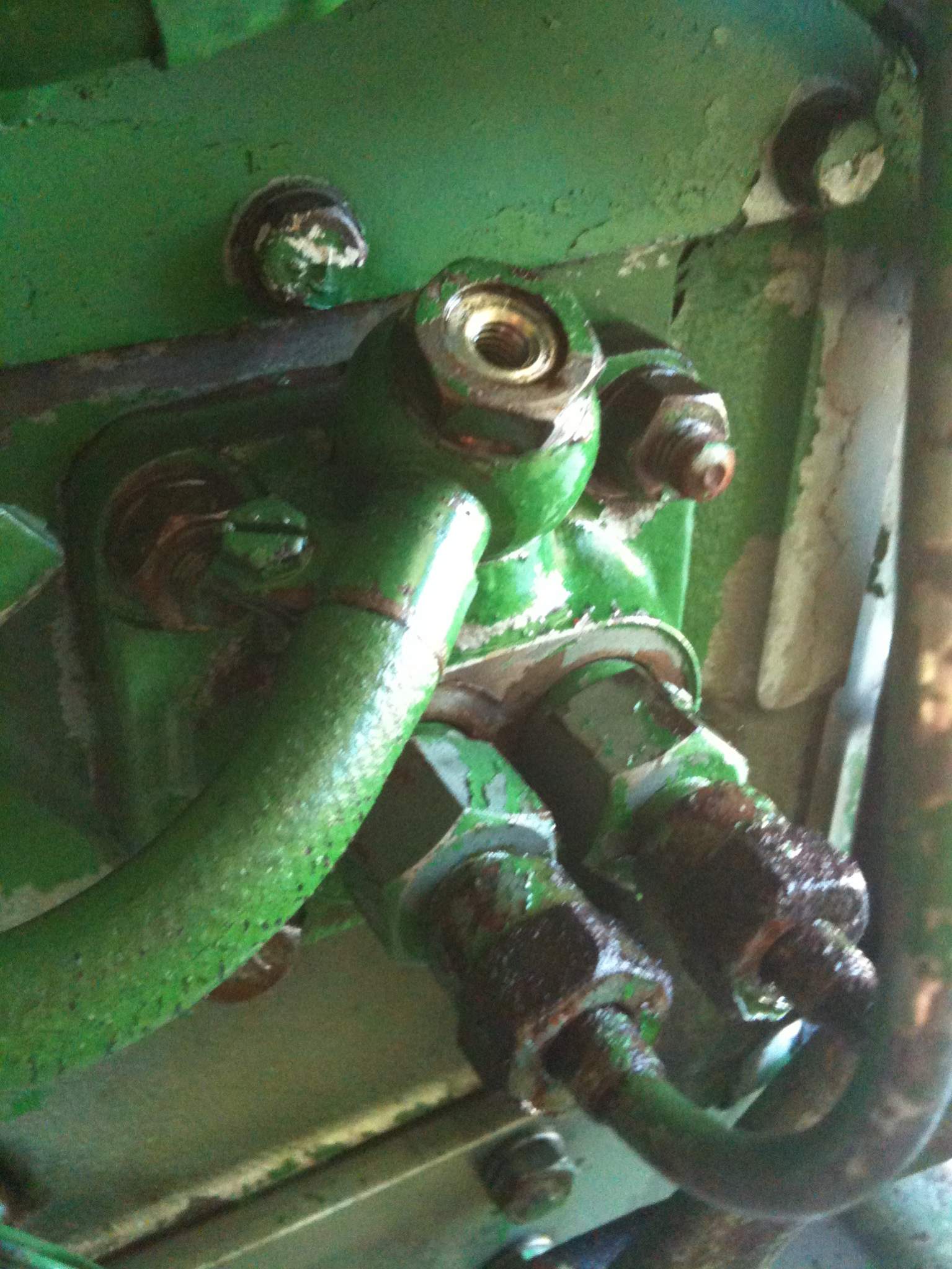

Been putting her back together since changing the transmission screen, fluid, and flushing radiator and coolant system. I reinstalled my clean fuel filter without priming in first and of course got air in my lines. I looked up old posts of bleeding the fuel system and started with the bleeders on the fuel filter. Got some bubbles out of both and then moved to the pump. I was amazed at how easy the bleeder screw unscrewed and then realized that the head of the screw had twisted right off and diesel was "peeing" out all over my boot. Bummer...I was so hoping to fire it up tonight. I guess I will need to order the bleed screw. I wonder if there is something I can use in the meantime??? Don't know the thread size and all but I bet it is a Japanese thread like my temp sensor was.

I am pretty sure it is a 10mm bolt. If you take one from a fender etc. you could use it until you find a replacement. You will want one without the attached fender washer. Use the gasket from the original bolt. You can still bleed from it, but it will be messy.
/ Bleeding Fuel System, Broke it #3
I found a simple bolt used as a bleeder screw in my second Yanmar. I think it is the size bolt that takes a 10mm wrench. Your local box store should have one like that to use until you can get the drilled one, or as Kay said just steal one off the sheet metal somewhere.

I stole a 10mm out of my fender and it fit, but it's pretty long compared to the old, and to get the bolt to seal I will need to screw it all the way down. Does anyone know if there is anything I could damage by seating this bolt all the way down? I halfway attempted to remove the entire fitting that the bleeder screws into to check for depth but it was in there tight and again, I am scared of breaking stuff.

Did the screw that broke off have an O ring or copper washer under the head for a seal?
Pipe thread is tapped at an angle, narrower at the bottom than the opening. That's how it seals.
If you use a bolt in pipe thread the thread pitch may be the same but it won't seal for long because the bolt isn't tapered. I'm guessing the housing is aluminum (soft), eventually the straight bolt is going to destroy the angled threads.

Looks like you not only broke the screw, but the banjo bolt as well.

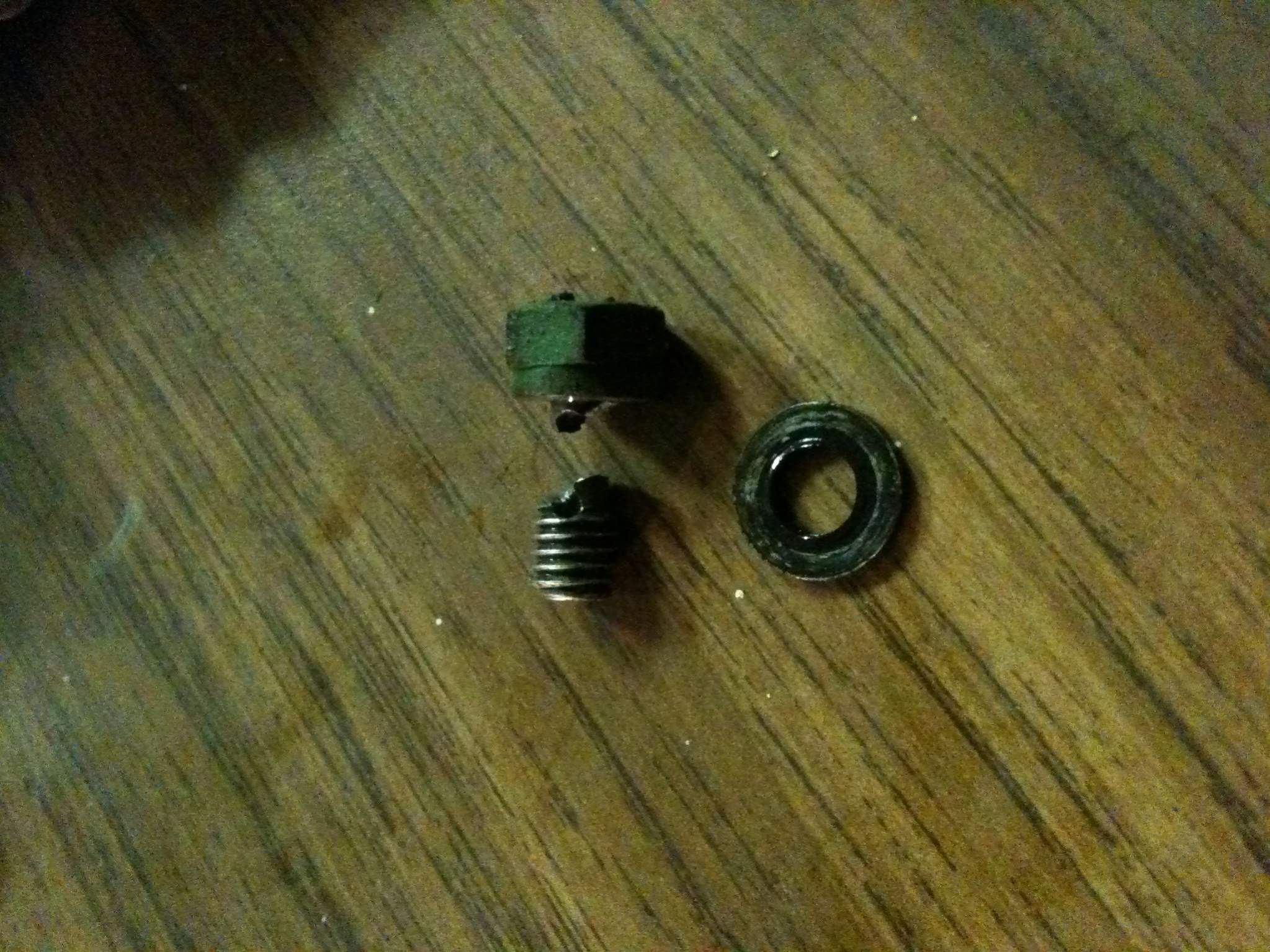

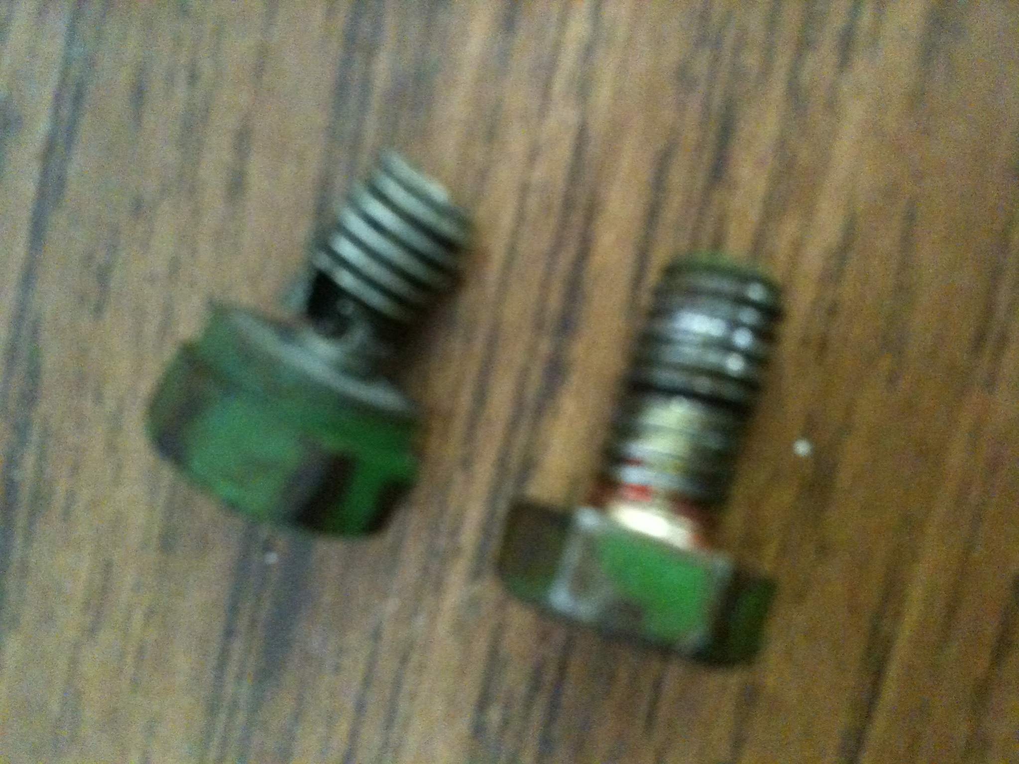

The first pic is the broken banjo bolt and the fender bolt i swiped to replace it temporarily. The second pic is the hole that the banjo came out of, which I thought was the bleeder but now i see the second screw head on the left that looks like a bleeder too. Anyways, my fender screw will thread into where the broken one came out of, but it is a tad bit longer and i dont wanna screw all the way down unless i know it will be safe to do so.

The broken item in my picture does not allow anything to screw into the top of it, as it has a phillips head slot on the top of it.
Yep, I was confused. The second pic's clear it up. I was not aware the bleed screws had holes. I have never had mine out, and you can't see the holes here. All you need is a short screw that wont block the hole in the banjo.

Put a nut on the bolt and tighten that against the washer with the bolt just in as far as feels right.
/ Bleeding Fuel System, Broke it #19
Excellent idea;). Just be sure and bleed before tightening down. You can order the correct screw, (shown above), and still have your fender screw intact.

It worked. Had her running fine last night with no leaks. New bolt is ordered too, about 5 bucks with washer. Thanks all.
